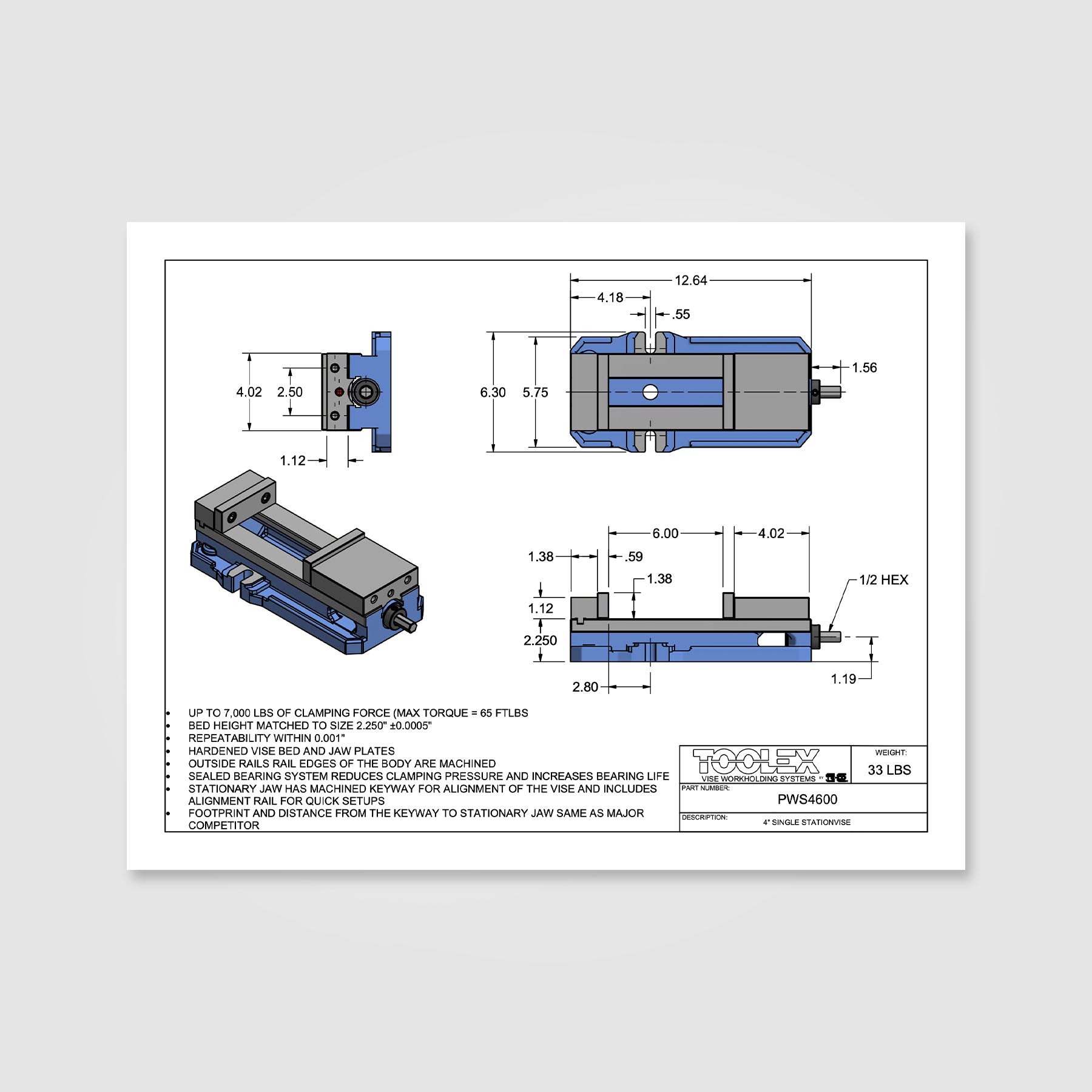

The PWS-4600 sets the standard for quality.
- Powder coated paint resists flaking and peeling
- 80,000psi ductile iron body with increased nickel content for improved corrosion resistance
- Hardened vise bed and jaw plates
- Sealed and lubricated needle roller thrust bearing for maximum life and minimum torque
- Up to 7,000lbs. of clamping force
- Repeatability within .001" (0.025mm)
- Outside rails of body are machined within 0.0005" (.013mm) square to jaw
- Bed height matched to size 2.250" +/- 0.0005"
- Footprint and distance from the keyway to stationary jaw meets industry standard

Tech Specs
| Specification | Value |
| Type | Single Station |
| Style | Machinable Jaws |
| Clamping Pressure | 7,000 lb |
| Jaw Opening | 6.000 in |
| Jaw Width | 4.000 in |
| Total Length | 14.22 in |
| Total Width | 6.30 in |
| Total Height | 3.63 in |
| Material | Ductile Iron |
| Weight | 33 lb |
