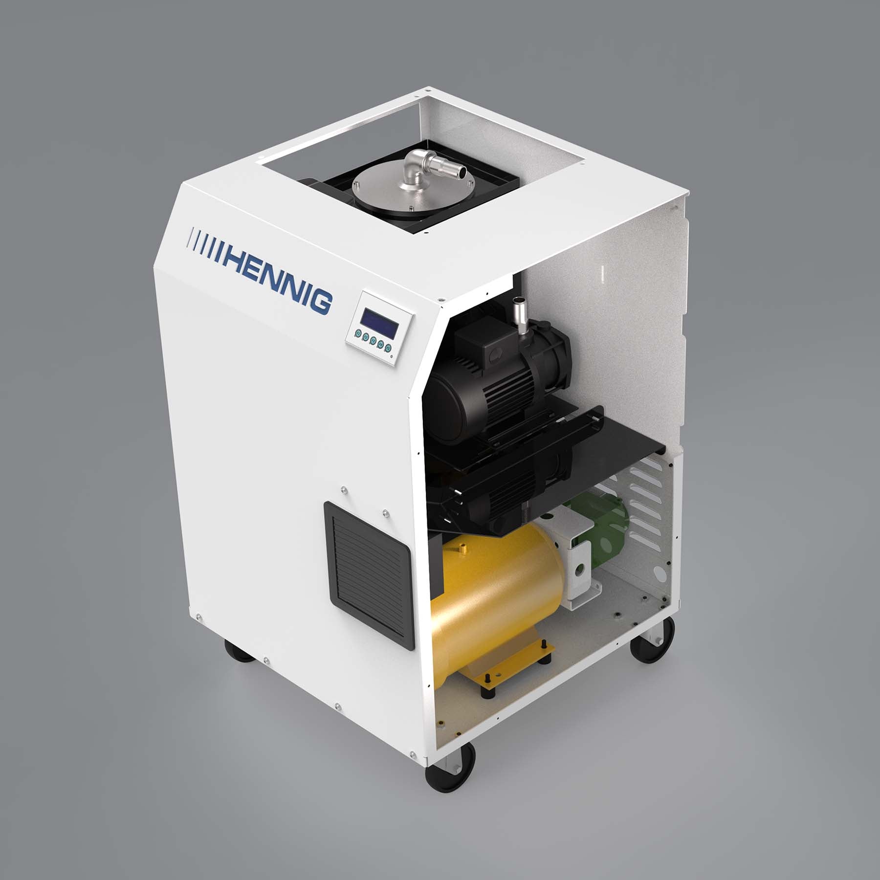

VariFlow Gen4 is Hennig's advanced high-pressure coolant system, designed to redefine efficiency and performance in machining operations. Engineered with Adaptive Flow Control, it dynamically adjusts coolant flow to deliver precise pressure settings while minimizing energy consumption, reducing coolant foaming, and decreasing heat generation. Its compact, economical design integrates seamlessly into your workflow, offering premium performance comparable to competitors' high-end models.
The VariFlow Gen4 is equipped with user-friendly features, including an HMI for pressure settings and IoT connectivity for monitoring system performance. It also includes a 25-gallon reservoir with a built-in 10-micron filter, ensuring clean, uninterrupted coolant flow. Caster wheels add mobility, allowing easy relocation between machines, while the direct-drive pump ensures smooth, quiet operation without belts or external pumps. VariFlow Gen4 delivers unmatched productivity and reliability, making it an essential addition to modern machining environments.

| Pressure Options | 250 PSI (17.2 bar), 500 PSI (34.4 bar), 750 PSI (51.7 bar), 1,000 PSI (69 bar) |
| Flow Rate | Up to 8 GPM (3.8 L/min) |
| Reservoir Capacity | 25 Gallons |
| Filter | 10-micron bag filter |
| Drive System | Direct drive pump with VFD-driven motor |
| Control Features | HMI for pressure settings, filter life monitoring, RS-232 port integration |
| Connectivity | IoT Enabled |
| Status Light Indicators | Green: On, Blue: Idle, Red: Warning |
| Dimensions | 25.5" (L) x 26.5" (W) x 37.5" (H) |
| Warranty | 2 Years |
| Mobility | Caster wheels for easy relocation |
High-Pressure Coolant, Done Right
VariFlow automatically adjusts coolant pressure to match the cut as it runs. The result is smoother machining, cleaner chip evacuation, and consistent performance during long cycles and unattended operation.
Filter & Reservoir
- Easy to Access
- Built-in 10-micron Filter
Control Interface
- Set Pressure and View Filter Life
- Easy to Read Status Light
Transfer Pump
- No External Pump or Wiring
Direct Drive Pump
- No Belts
- VFD Driven Motor
- Smooth, Quiet Operation
