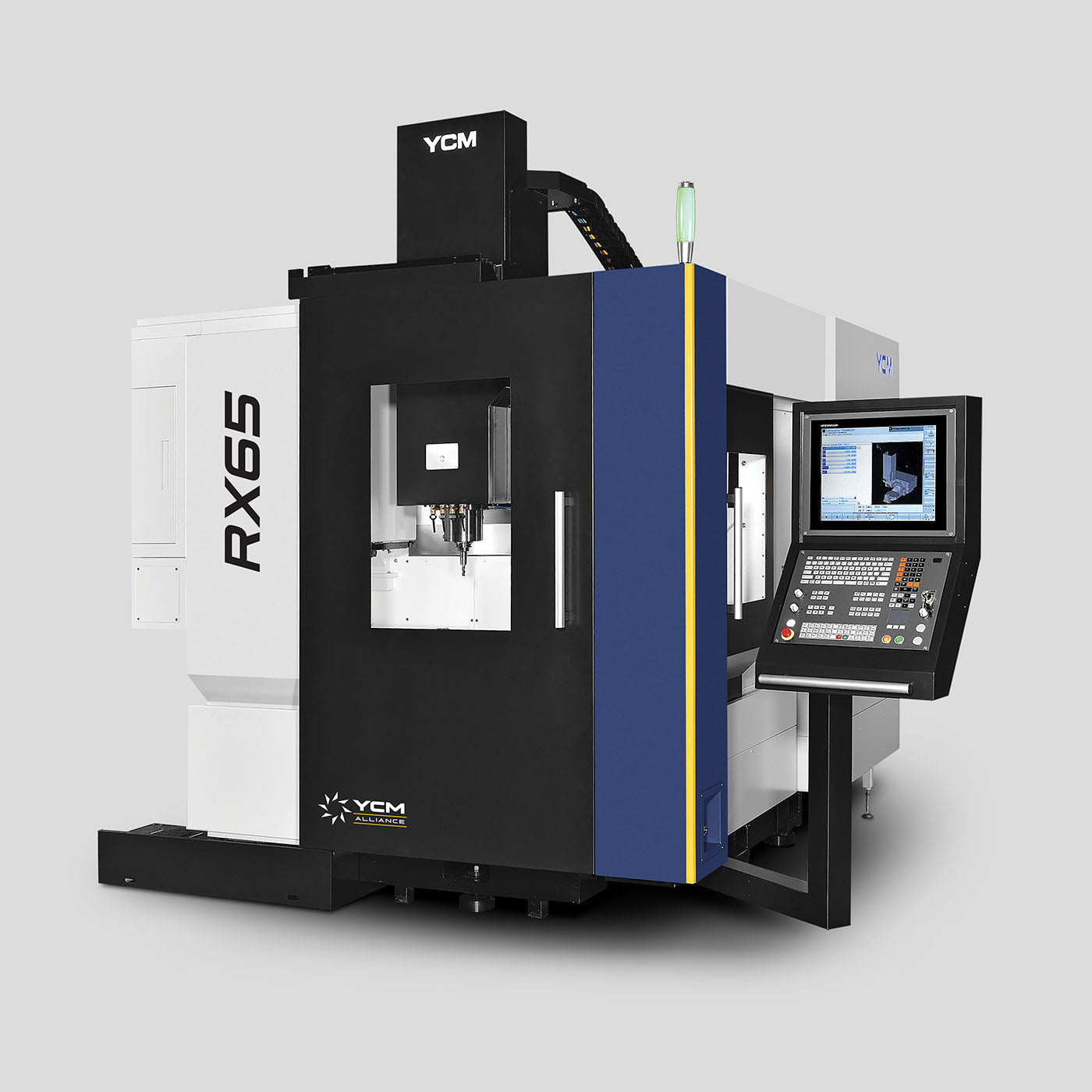

High-Performance 5-Axis Vertical Machining Center
The YCM RX65 delivers advanced 5-axis simultaneous machining with the rigidity, speed, and precision serious manufacturers demand. Its rotary-tilting table, 15,000 rpm spindle, and solid Meehanite® casting make it ideal for aerospace, mold, medical, and complex part production. With Heidenhain and FANUC control options, linear scales, and thermal stability features, the RX65 ensures exceptional accuracy and surface finish even under heavy cutting conditions.
Compact yet powerful, the RX65 helps reduce setups, simplify complex machining, and boost your shop's productivity.
Country of Origin: Taiwan
Customize Your CNC
CONFIDENCE IN EVERY CUT
The YCM RX65 is engineered for high-precision, high-efficiency 5-axis machining. Its rotary-tilting table and 15,000 rpm spindle deliver the speed, rigidity, and surface finish required for aerospace, mold, medical, and complex part production. With advanced thermal stability, linear scales, and control options from Heidenhain or FANUC, the RX65 offers confidence in every cut. Reduce setups, simplify complex jobs, and take on high-value work with ease.

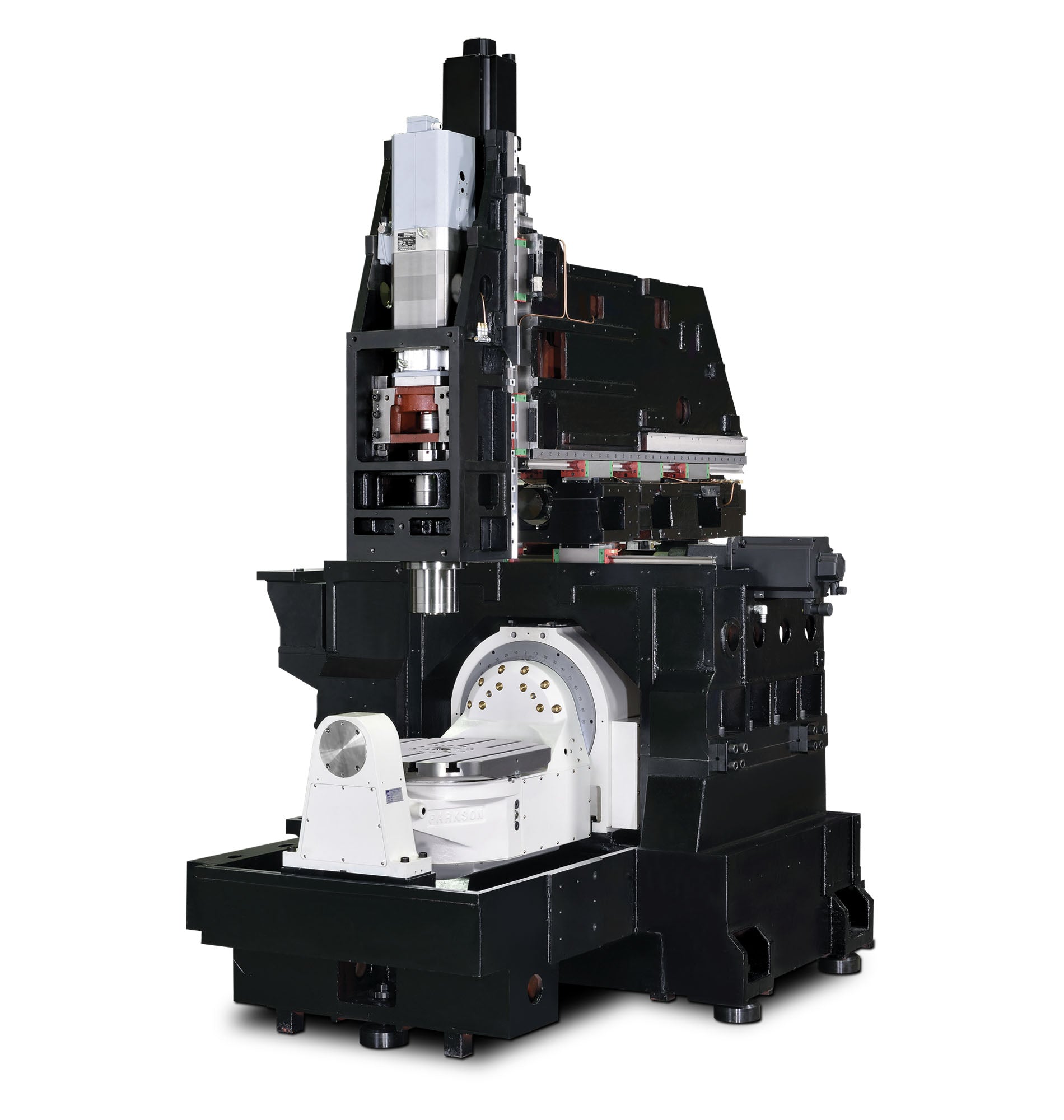

Highly Accurate Axial Movement
- Linear guideways enable fast and smooth axial movement.
- Pre-tensioned ball screws and direct-drive motors achieve high torque and accurate positioning.

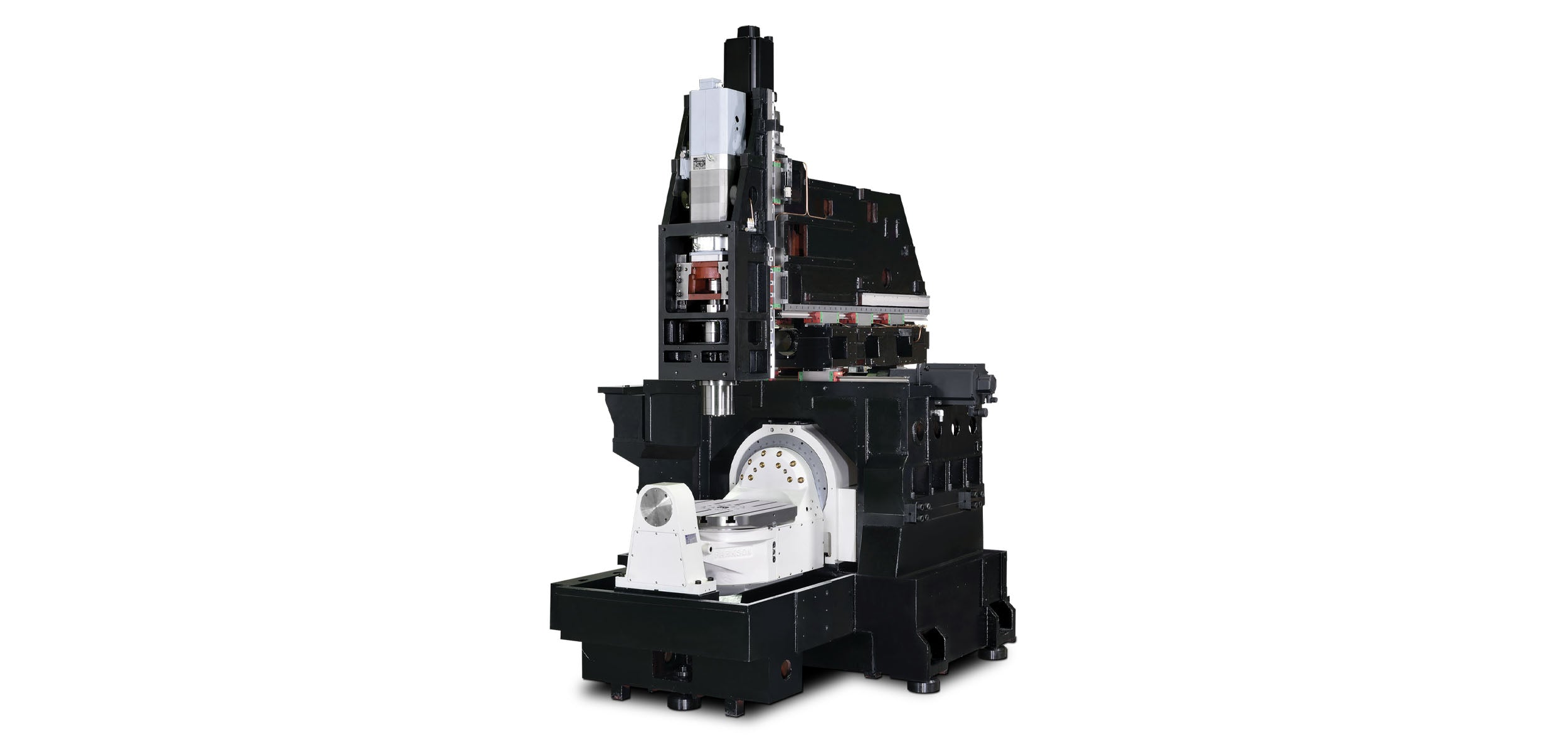

B/C-Axis Rotary Table
- Meehanite® components and mating surfaces are hand scraped for optimum stiffness and vibration dampening.
- The massive ram and base structure ensure greater support and stability during machining.
Robust Structural Design
- High-precision rotary encoders.
- Larger tailstock support for greater rigidity and accuracy.
- Hydraulic braking system.
- B-axis: 160° (+110° / −50°).
- Table size: ø25.59" × 17.7" (ø650 mm × 450 mm).
- Max. workpiece dimension: ø25.59" × 17.7" (ø650 × 450 mm).
- Max. workload: 661 lb (300 kg) at 0°–45° / 441 lb (200 kg) at 45°–90°.
Tech Specifications
25.6" / 28.7" / 23.6" (650 / 730 / 600 mm)
25.6" diameter (650 mm)
882 lbs (400 kg)
FANUC 31i-MB Plus / Heidenhain TNC 640
15,000 rpm
35 hp (26 kW)
HSK-A63
40 Tools
B-axis tilt ±120°, C-axis continuous 360°
5-axis simultaneous machining, high-speed spindle, linear scales
