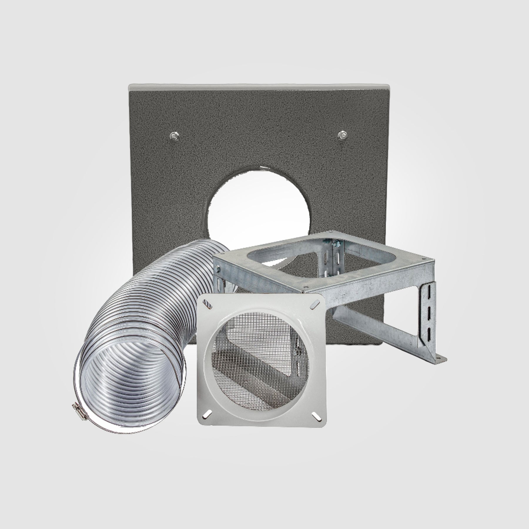

Unversal Installation Kit for MF-550
Includes:
- 11" adjustable stand
- Baseplate with 4" or 6" suction port
- Installation Kit - 4" or 6" Ø inlet
- Suction hose 6'
- Machine adaptor
- Chip strainer
- Hose clamps
