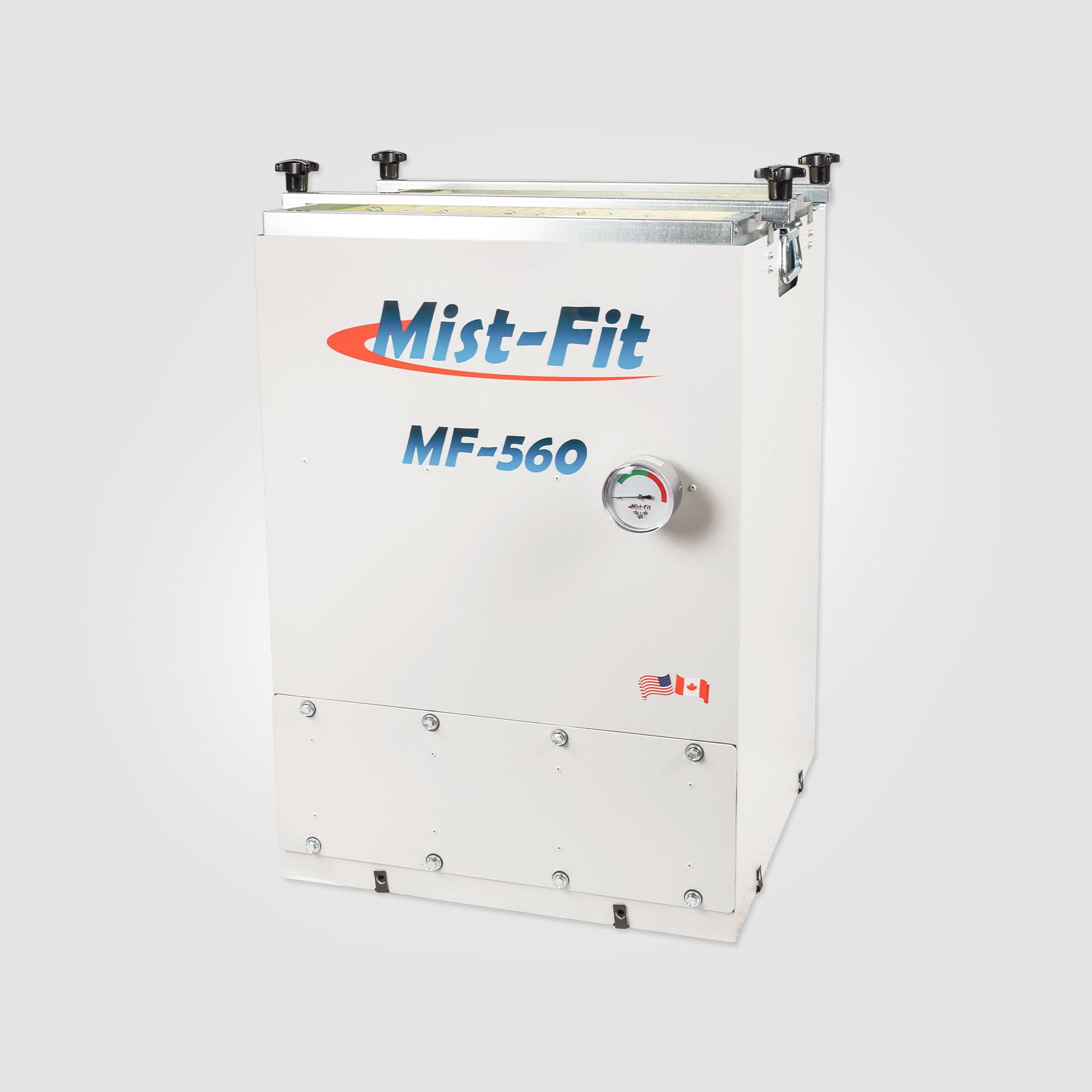

MF 550
| Airflow | 500–600 cfm |
| Enclosure | 250 ft³ |
| Motor | 0.75 hp |
| Max Temp | 125°F (50°C) |
| pH Limits | 5.8–9.8 |
| Inlet | 6″ ø |
| Sound | 66 dB(A) |
MF 560
| Motor | 0.75 hp |
| Inlet | 6″ ø |
| Sound | 66 dB(A) |

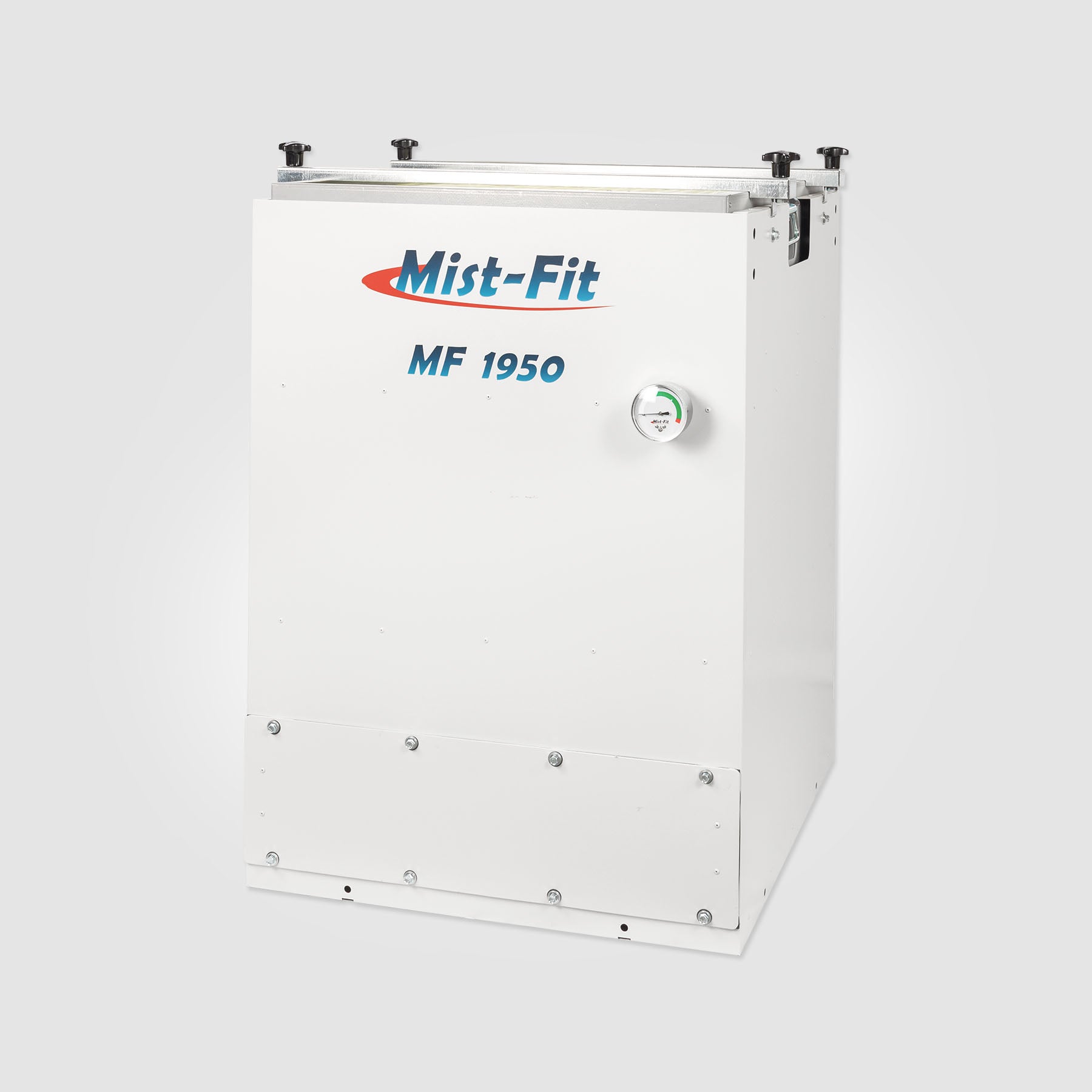

MF 1950
| Airflow | 1,900–2,000 cfm |
| Enclosure | 2,000 ft³ |
| Motor | 3 hp |
| Inlet | 12″ ø |
| Sound | 72 dB(A) |
