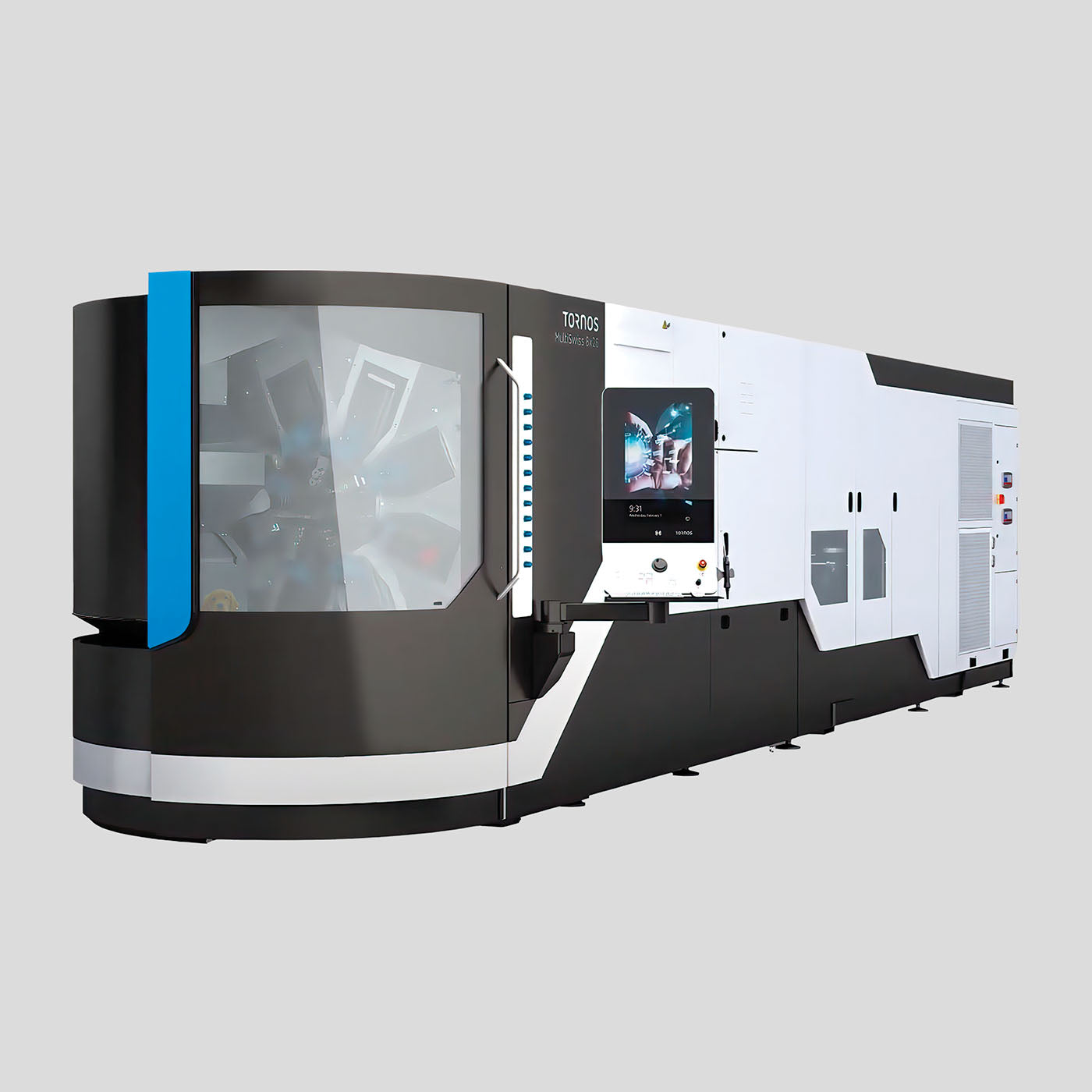

Machine Tornos MultiSwiss 8 × 26
Part Name Aerospace Poppet
Material & Provider 360 Brass
Industry Aerospace
Control Fanuc
Programmed In TB-Deco
Workholding Hardinge
Coolant Blaser Blasomill GT 15
Precision Aerospace Poppet in free-machining 360 Brass. Key features: concentricity between stem and seat, controlled cone/spherical sealing geometry, tight stem diameters, and a fine surface finish with burr-free edges for reliable, leak-tight performance.
Featured at This Station
TORNOS MultiSwiss
CNC multi-spindle that cranks out parts every few seconds—6 or 8 spindles working in parallel. Independent slides with driven tools and back-working kill secondary ops. A production monster for automotive, medical, and connector work.
