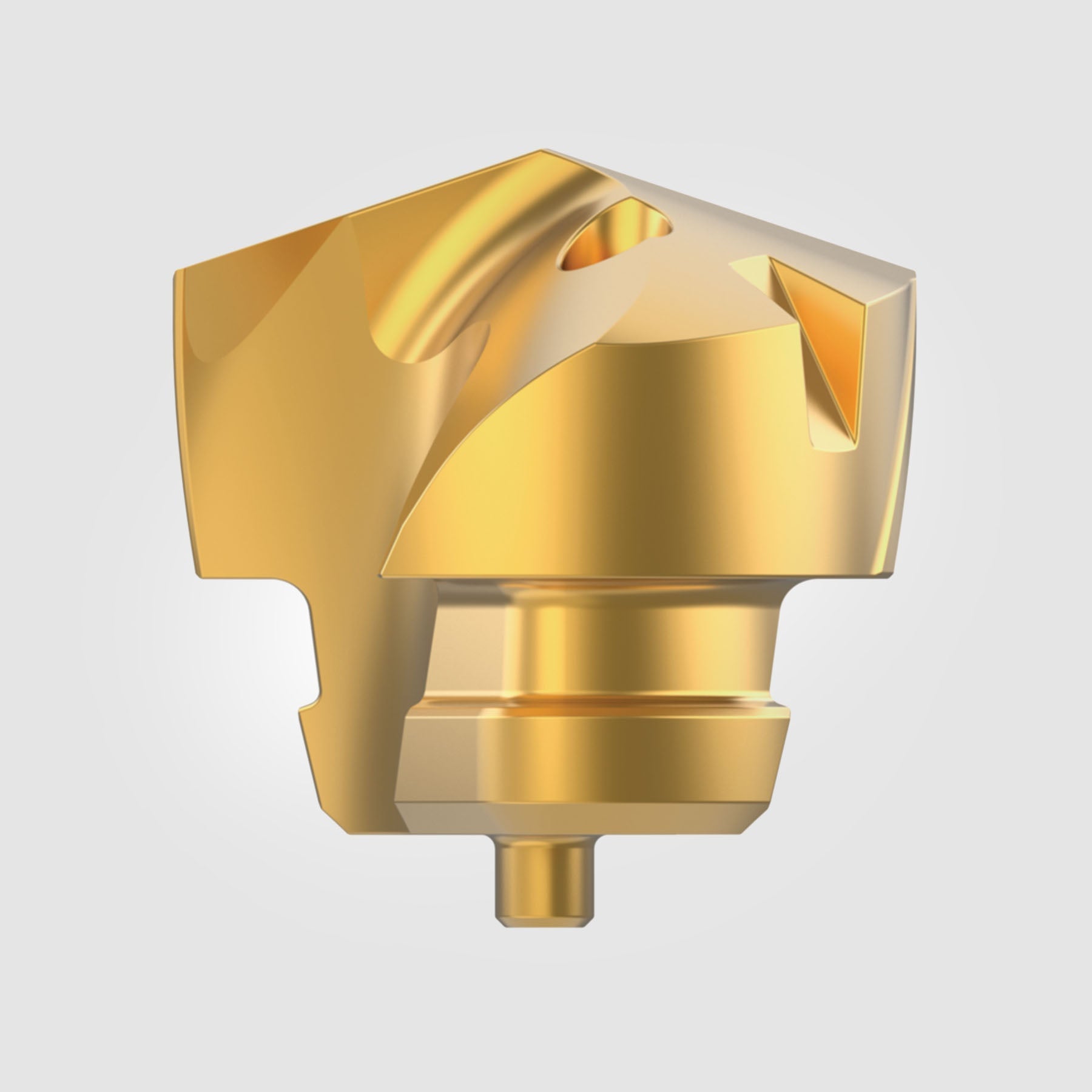

| Tool # | Adapter / Shank | Holder / Body / Bar | Insert / Drill / Tap |
| 1 | HSK63T KM50 Clamping Unit (3895298) | Turning Holder, 93° CN Style (6939711) | Turning Insert, CN Geometry (6710685) |
| 2 | HSK63T KM Modular Clamping Unit (3892899) | Turning Holder, CN Style (3180556) | Turning Insert, CNMG (6687089) |
| 3 | HSK63T KM Modular Clamping Unit (3892899) | Turning Holder, DN Style (3487461) | Turning Insert, DNMG (4053379) |
| 4 | — | Indexable Drill Body (6389282) | Flat-Bottom / Drill Tip (6771164) |
| 5 | HSK63T KM50 Clamping Unit (3895298) | Groove/Turn Holder, Top Notch Style (3753591) | Groove/Turn Insert, Top Notch (5968082) |
| 6 | — | HSK63A Shrink-Fit Chuck (3866683) | Solid End Mill (7156146) |
| 7 | — | HSK63A Shrink-Fit Chuck (3866572) | Solid End Mill (6769685) |
| 8 | Modular Shank / Adapter (6136872) | Chamfer Head Holder (5520958) | Modular Chamfer Head (6127352) |
| 9 | — | Turning Holder, MCLNR RH (1096070) | Turning Insert, CNMG (6687089) |
| 10 | — | Turning Holder, MCLNL LH (1096092) | Turning Insert, CNMG (6687089) |
| 11 | — | Turning Holder, 35° VN Style LH (1102321) | Turning Insert, VNMG (7093516) |
| 12 | — | Turning Holder, 35° VN Style RH (1101634) | Turning Insert, VNMG (7093516) |
| 13 | — | Indexable Drill Body (6372054) | Drill Insert / Tip (7005332) |
| 14 | — | Indexable Drill Body, Flanged (5691841) | Center Insert (5066016), Peripheral Insert (5534262) |
| 15 | — | Indexable Drill Body (6688337) | Drill Tip (6388728) |
| 16 | — | Boring Bar, SVQ Style (1094721) | Finishing Insert, VBGT (6687066) |
| 17 | — | — | Solid Carbide Drill (6781687) |
| 18 | — | — | Spiral-Flute Tap (4116643) |
| 19 | Modular Steel Extension, 1/2″ (6136868) | — | Modular Chamfer Head (6127352) |
