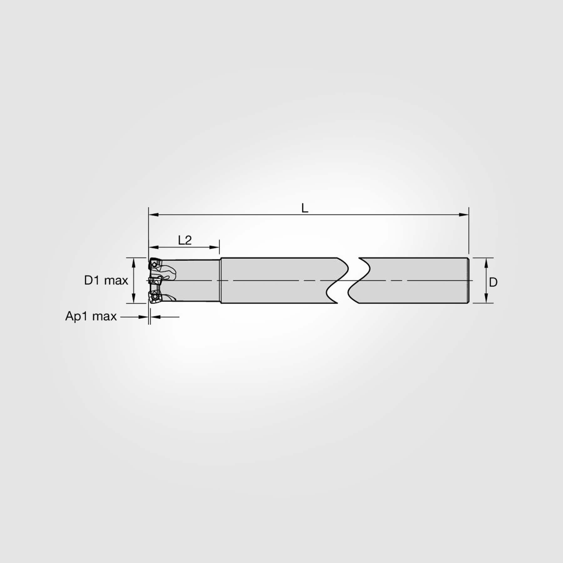

7792VXP-IC06 Screw-On High-Feed End Mill 1" Max Cut Dia with 4-Flutes 5661212
High-Feed Milling Cutters
- Series: 7792VXD
- Number of Flutes: 4
- [D1] Effective Cutting Diameter (Inch): 0.630"
- [D1] Effective Cutting Diameter (Metric): 16.002mm
- [D1MAX] Maximum Cutting Diameter (Inch): 1.000"
- [D1MAX] Maximum Cutting Diameter (Metric): 25.400mm
- [AP1MAX] Maximum Cut Depth (Inch): 0.035"
- [L] Overall Length (Inch): 8.344"
- [L] Overall Length (Metric): 211.940mm
- [L1] Gage Length (Inch): 8.344"
- [L1] Gage Length (Metric): 211.940mm
- [L2] Head Length (Inch): 1.575"
- [L2] Head Length (Metric): 40.000mm
- Maximum RPM: 48,500
