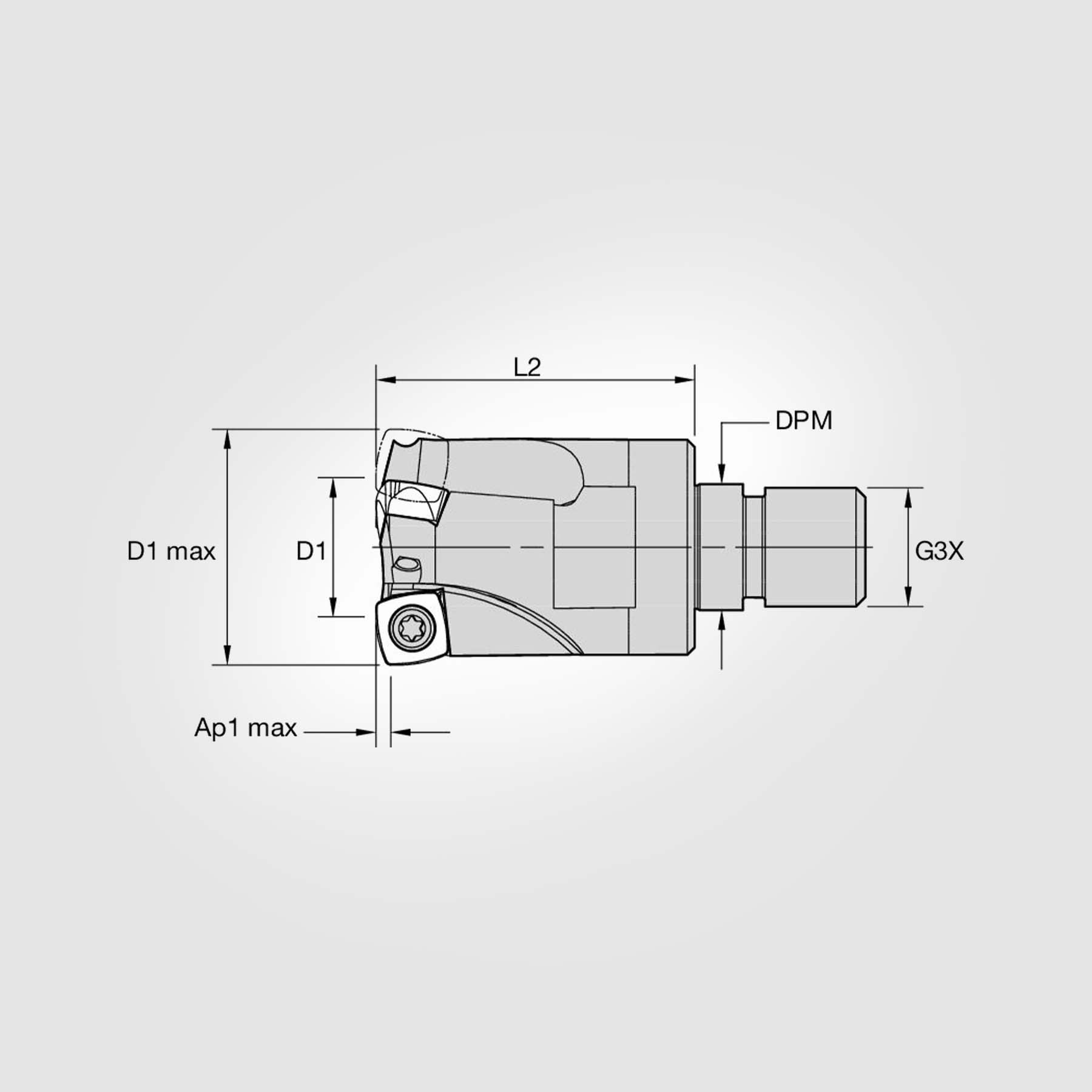

- Series: 7792VXD
- Number of Flutes: 3
- [D] Adapter Diameter (Inch): 1.1417"
- [D] Adapter Diameter (Metric): 29.000mm
- [D1] Effective Cutting Diameter (Inch): 0.7384"
- [D1] Effective Cutting Diameter (Metric): 18.754mm
- [D1MAX] Maximum Cutting Diameter (Inch): 1.250"
- [D1MAX] Maximum Cutting Diameter (Metric): 31.750mm
- [AP1MAX] Maximum Cut Depth (Inch): 0.0591"
- [L] Overall Length (Inch): 2.6575"
- [L] Overall Length (Metric): 67.500mm
- [L1] Gage Length (Inch): 1.6929"
- [L1] Gage Length (Metric): 43.000mm
- [L2] Head Length (Inch): 1.6929"
- [L2] Head Length (Metric): 43.000mm
- [DPM] Pilot Diameter (Inch): 0.6693"
- [DPM] Pilot Diameter (Metric): 17.000mm
- [G3X] Thread Size: M16
- Maximum RPM: 40,500
