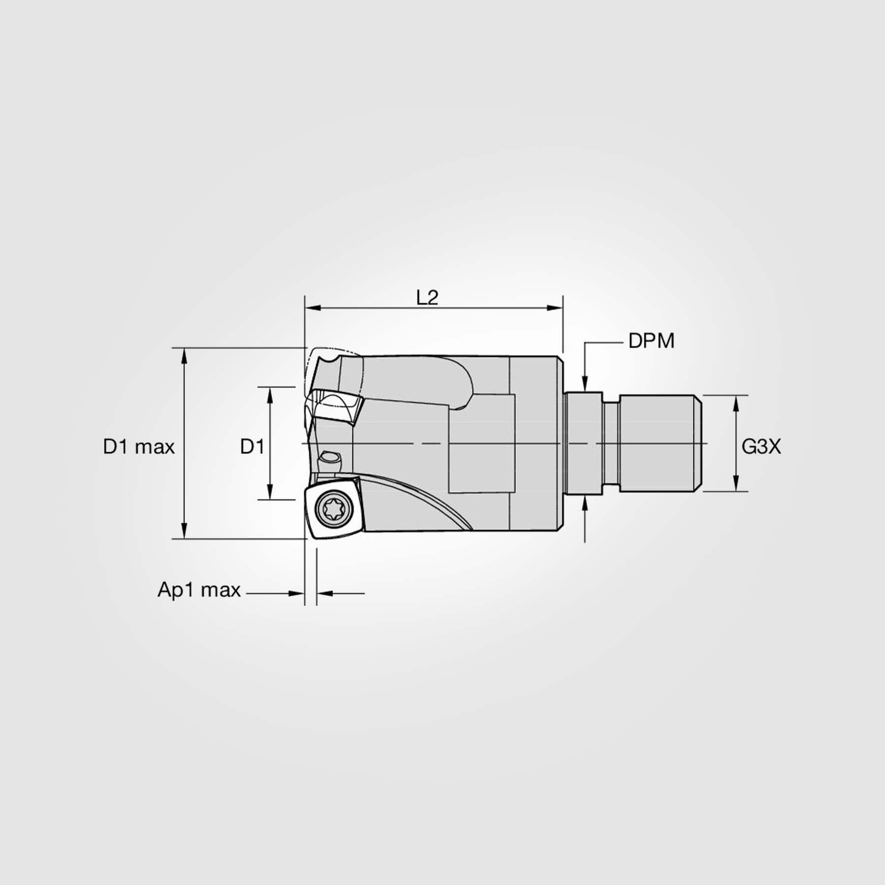

- Series: 7792VXD
- Number of Flutes: 2
- [D] Adapter Diameter (Inch): 0.8268"
- [D] Adapter Diameter (Metric): 21.000mm
- [D1] Effective Cutting Diameter (Inch): 0.4874"
- [D1] Effective Cutting Diameter (Metric): 12.379mm
- [D1MAX] Maximum Cutting Diameter (Inch): 0.9921"
- [D1MAX] Maximum Cutting Diameter (Metric): 25.200mm
- [AP1MAX] Maximum Cut Depth (Inch): 0.0591"
- [L] Overall Length (Inch): 2.2441"
- [L] Overall Length (Metric): 57.000mm
- [L1] Gage Length (Inch): 1.378"
- [L1] Gage Length (Metric): 35.000mm
- [L2] Head Length (Inch): 1.378"
- [L2] Head Length (Metric): 35.000mm
- [DPM] Pilot Diameter (Inch): 0.4917"
- [DPM] Pilot Diameter (Metric): 12.488mm
- [G3X] Thread Size: M12
- Maximum RPM: 48,000
