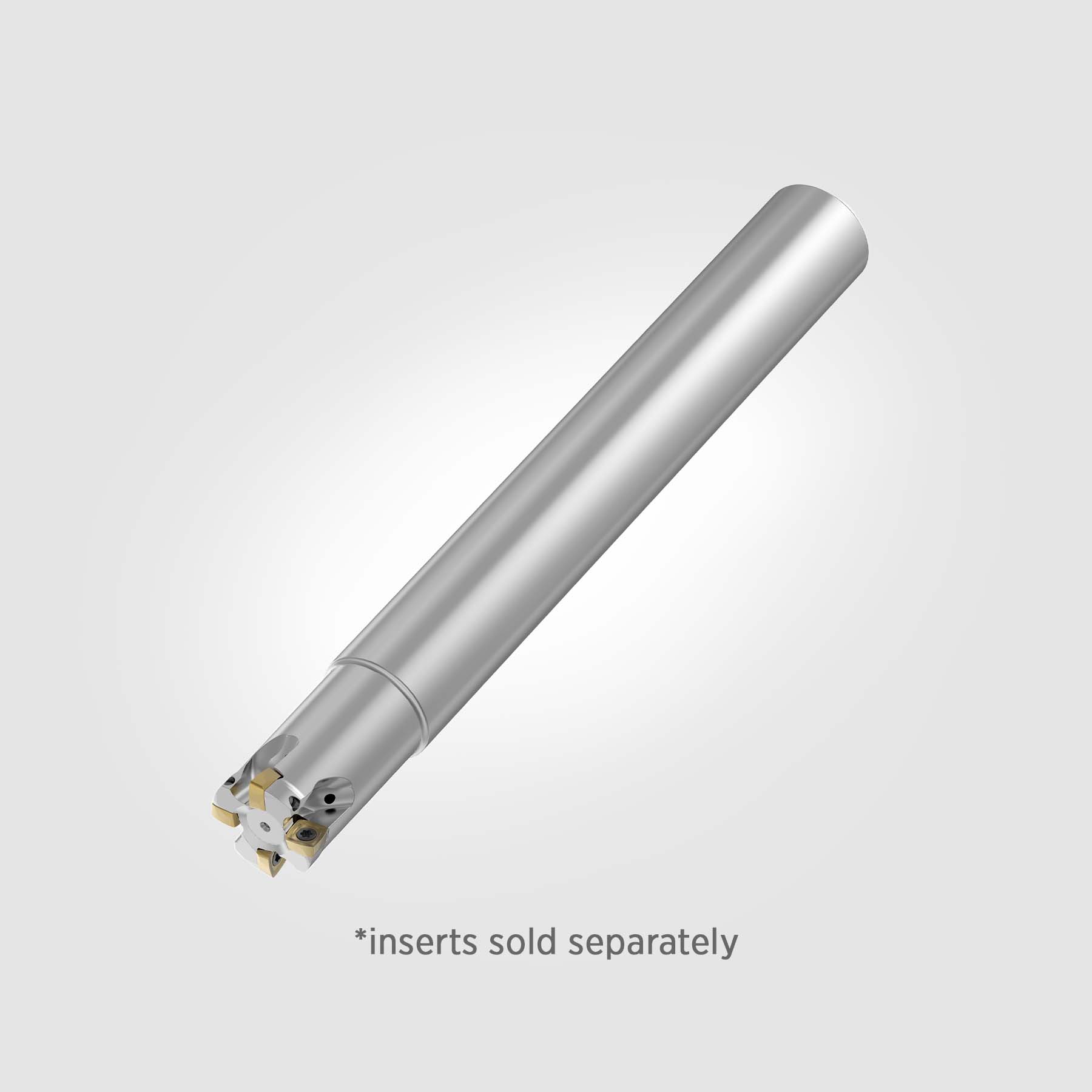

7792VXP-IC06 High-Feed End Mill 25mm Max Cut Dia with 4-Flutes 5666409
High-Feed Milling Cutters

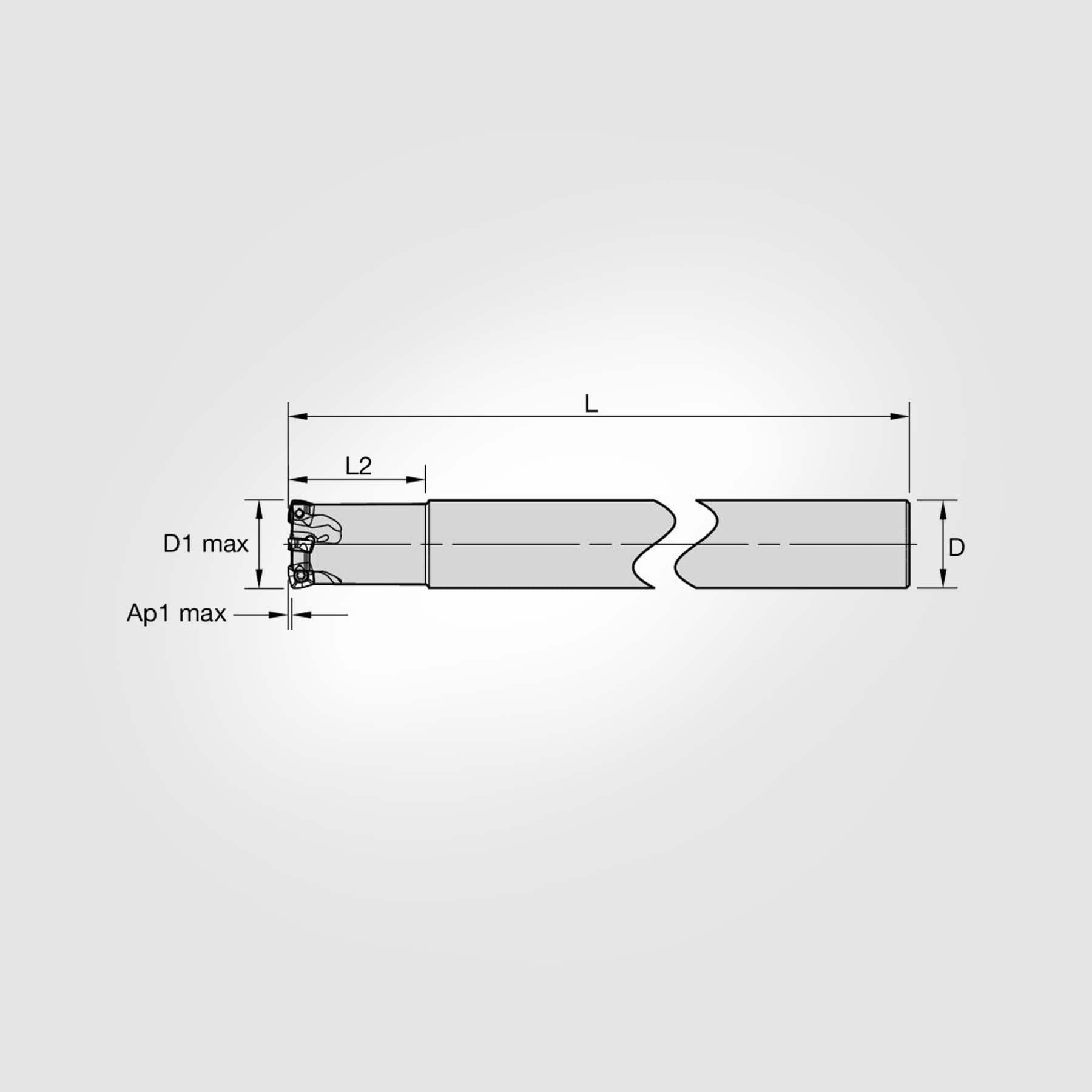

- Series: 7792VXP
- Number of Flutes: 4
- [D] Adapter Diameter (Inch): 0.9843"
- [D] Adapter Diameter (Metric): 25.000mm
- [D1] Effective Cutting Diameter (Inch): 0.6291"
- [D1] Effective Cutting Diameter (Metric): 15.979mm
- [D1MAX] Maximum Cutting Diameter (Inch): 0.9848"
- [D1MAX] Maximum Cutting Diameter (Metric): 25.015mm
- [AP1MAX] Maximum Cut Depth (Inch): 0.0354"
- [L] Overall Length (Inch): 8.2677"
- [L] Overall Length (Metric): 210.000mm
- [L1] Gage Length (Inch): 8.2677"
- [L1] Gage Length (Metric): 210.000mm
- [L2] Head Length (Inch): 1.5748"
- [L2] Head Length (Metric): 40.000mm
- Maximum RPM: 48,500
