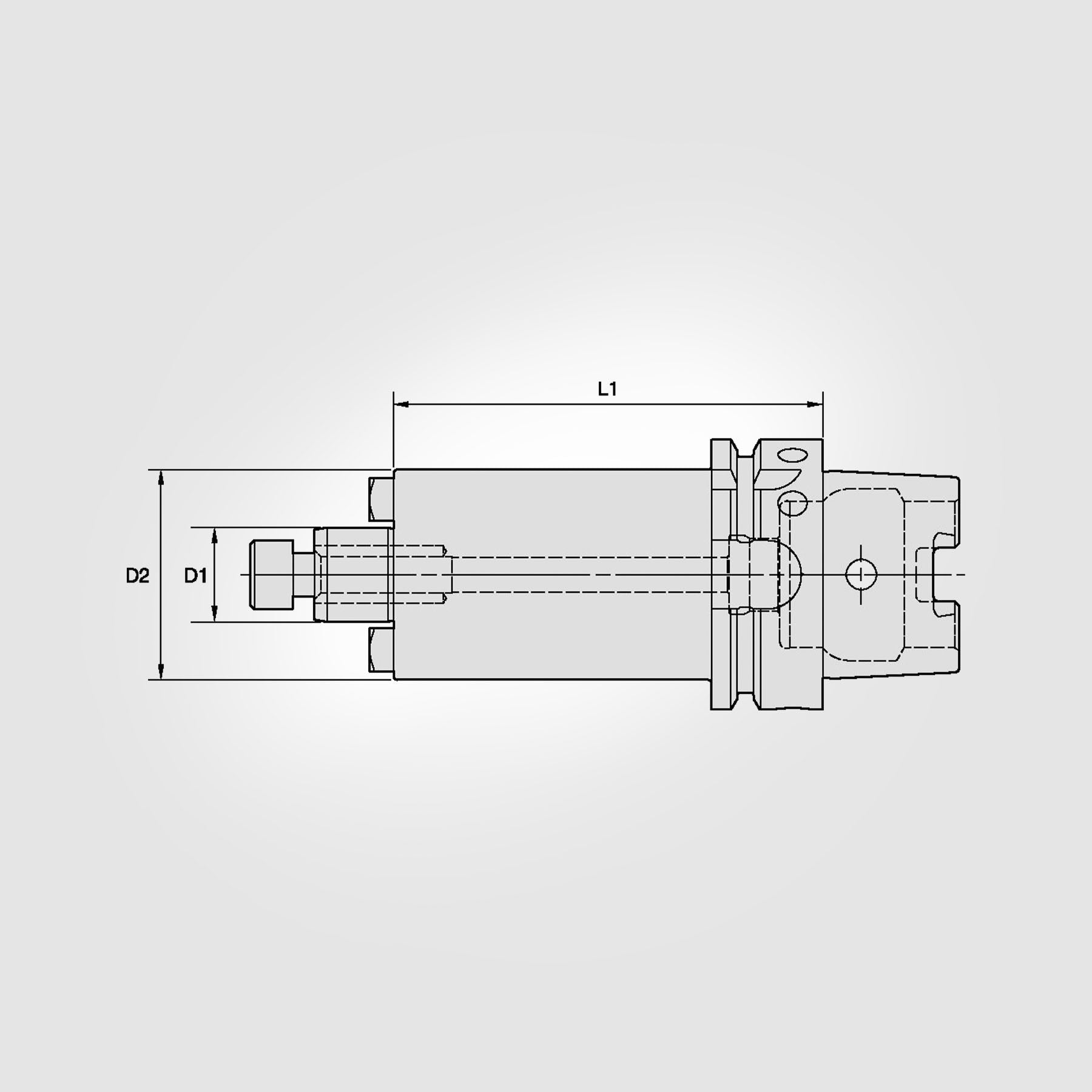

- System Size: HSK100A
- [D1] Adapter Diameter (Inch): 1.5748"
- [D1] Adapter Diameter (Metric): 40.000mm
- [D2] Body Diameter (Inch): 3.5157"
- [D2] Body Diameter (Metric): 89.300mm
- [L1] Gage Length (Inch): 6.2990"
- [L1] Gage Length (Metric): 160.000mm
- [L] Overall Length (Inch): 9.3071"
- [L] Overall Length (Metric): 236.400mm
- [L2] Usable Length (Inch): 5.1594"
- [L2] Usable Length (Metric): 131.050mm
- [D4] Bolt Circle (Inch): 2.6260"
- [D4] Bolt Circle (Metric): 66.700mm
- [G1] Bolt Circle Thread Size: M12X1.75
