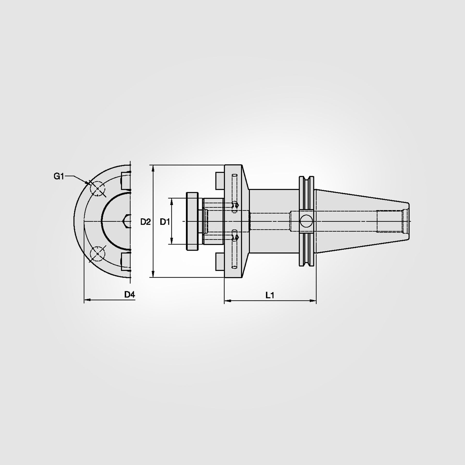

- Adapter Type: Steep Taper
- System Size: CV50
- [D1] Adapter Diameter (Inch): 2.000"
- [D1] Adapter Diameter (Metric): 50.800mm
- [D2] Body Diameter (Inch): 4.880"
- [D2] Body Diameter (Metric): 124.000mm
- [L1] Gage Length (Inch): 6.000"
- [L1] Gage Length (Metric): 152.400mm
- [L] Overall Length (Inch): 10.938"
- [L] Overall Length (Metric): 277.825mm
- [L2] Usable Length (Inch): 6.000"
- [L2] Usable Length (Metric): 152.400mm
- [D4] Bolt Circle (Inch): 4.0000"
- [D4] Bolt Circle (Metric): 101.600mm
- [G1] Bolt Circle Thread Size: 5/8-11 UNC

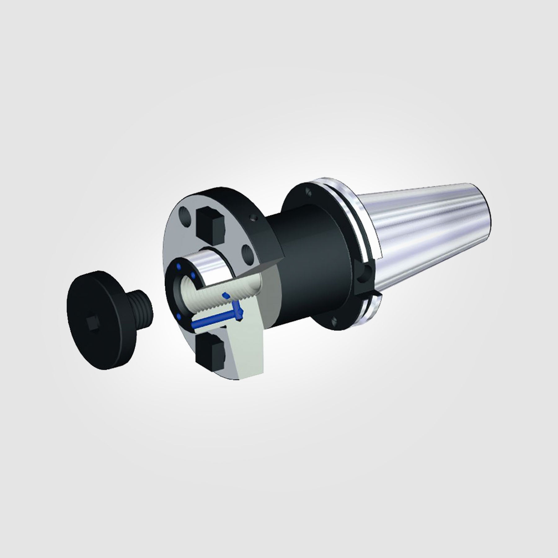

- Coolant Entry Style: Flange & Axial Coolant
