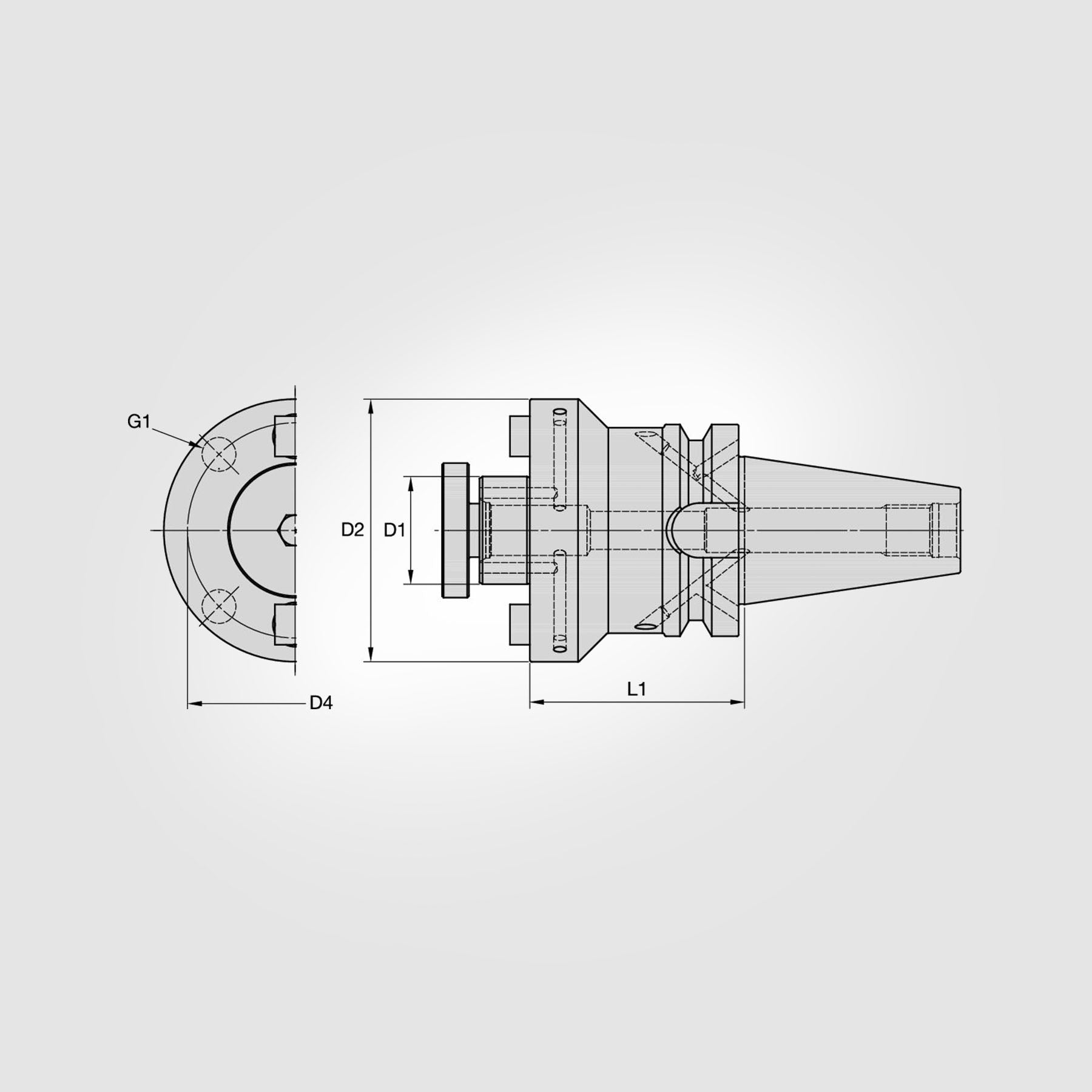

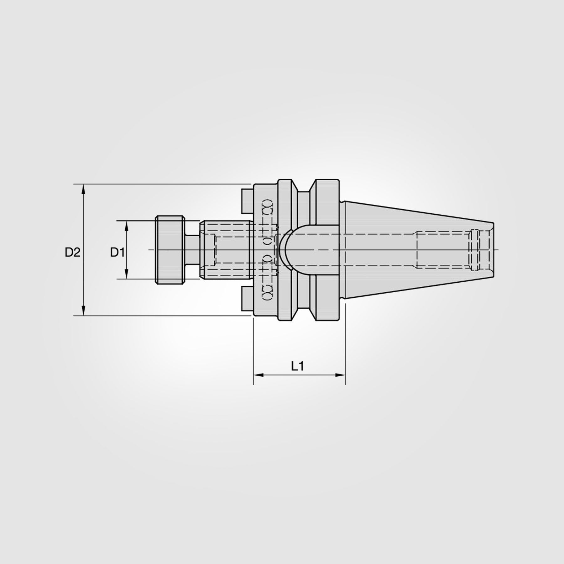

- Adapter Type: Steep Taper
- System Size: BT40
- [D1] Adapter Diameter (Inch): 1.500"
- [D1] Adapter Diameter (Metric): 38.100mm
- [D2] Body Diameter (Inch): 3.625"
- [D2] Body Diameter (Metric): 92.000mm
- [L1] Gage Length (Inch): 2.360"
- [L1] Gage Length (Metric): 59.944mm
- [L] Overall Length (Inch): 5.873"
- [L] Overall Length (Metric): 149.170mm
- [L2] Usable Length (Inch): 2.360"
- [L2] Usable Length (Metric): 59.944mm
