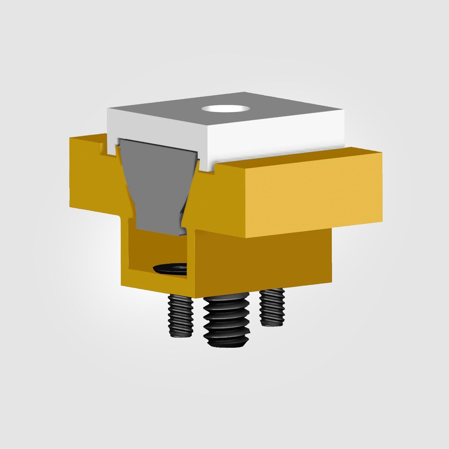

TITAN's go-to clamps for advanced fixturing and workholding setups!- The specially designed steel wedge spreads the clamping force uniformly on both sides of the 7075-T6 aluminum channel
- The locking plate properly expands the clamp, while making it rigid for machining

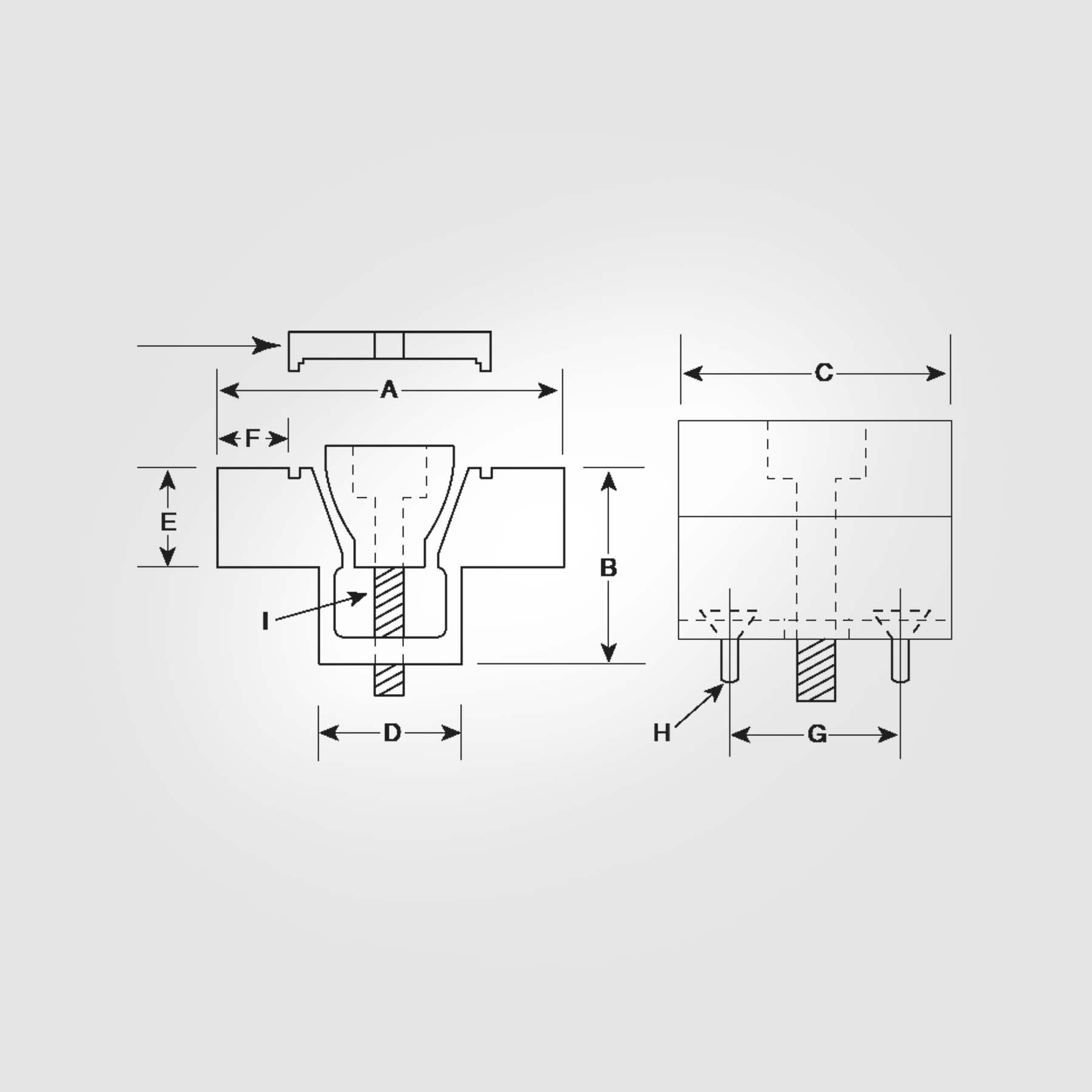

Technical Data- Quantity: 1
- [A] Clamp Clearance: 1.125"
- [F] Machinable Stock: 0.180"
- [H] Mounting Screws: 2-56
- Screw Size: 8-32
- Max Torque: 2.5 ft-lbs
- Holding Force: 500 lbs
#7501500X632
- [A] Clamp Clearance: 1.500"
- [F] Machinable Stock: 0.260"
- [H] Mounting Screws: 6-32
- Screw Size: 1/4-20
- Max Torque: 10.8 ft-lbs
- Holding Force: 1500 lbs
#10002000X632
- [A] Clamp Clearance: 2.000"
- [F] Machinable Stock: 0.390"
- Screw Size: 5/16-18
- Max Torque: 10.4 ft-lbs
- Holding Force: 2000 lbs
#15003000X1032
- [A] Clamp Clearance: 3.000"
- [F] Machinable Stock: 0.620"
- [H] Mounting Screws: 10-32
- Screw Size: 1/2-13
- Max Torque: 28.3 ft-lbs
- Holding Force: 3500 lbs
#20004000X1420
- [A] Clamp Clearance: 4.000"
- [F] Machinable Stock: 0.800"
- [H] Mounting Screws: 1/4-20
- Screw Size: 5/8-11
- Max Torque: 55 ft-lbs
- Holding Force: 6000 lbs
#50028600mmXM2
- [A] Clamp Clearance: 28.600mm
- [F] Machinable Stock: 6.300mm
- [H] Mounting Screws: M2
- Screw Size: M4
- Max Torque: 3.40 N.m
- Holding Force: 2225 N
#75038100mmXM4
- [A] Clamp Clearance: 38.100mm
- [F] Machinable Stock: 9.400mm
- [H] Mounting Screws: M4
- Screw Size: M6
- Max Torque: 14.30 N.m
- Holding Force: 6675 N
#100050800mmXM4
- [A] Clamp Clearance: 50.800mm
- [F] Machinable Stock: 12.700mm
- Screw Size: M8
- Max Torque: 14.50 N.m
- Holding Force: 8900 N
#150076200mmXM5
- [A] Clamp Clearance: 76.200mm
- [F] Machinable Stock: 19.100mm
- [H] Mounting Screws: M5
- Screw Size: M12
- Max Torque: 38.40 N.m
- Holding Force: 15575 N
#2000101600mmXM6
- [A] Clamp Clearance: 101.600mm
- [F] Machinable Stock: 25.400mm
- [H] Mounting Screws: M6
- Screw Size: M16
- Max Torque: 74.60 N.m
- Holding Force: 26700 N
