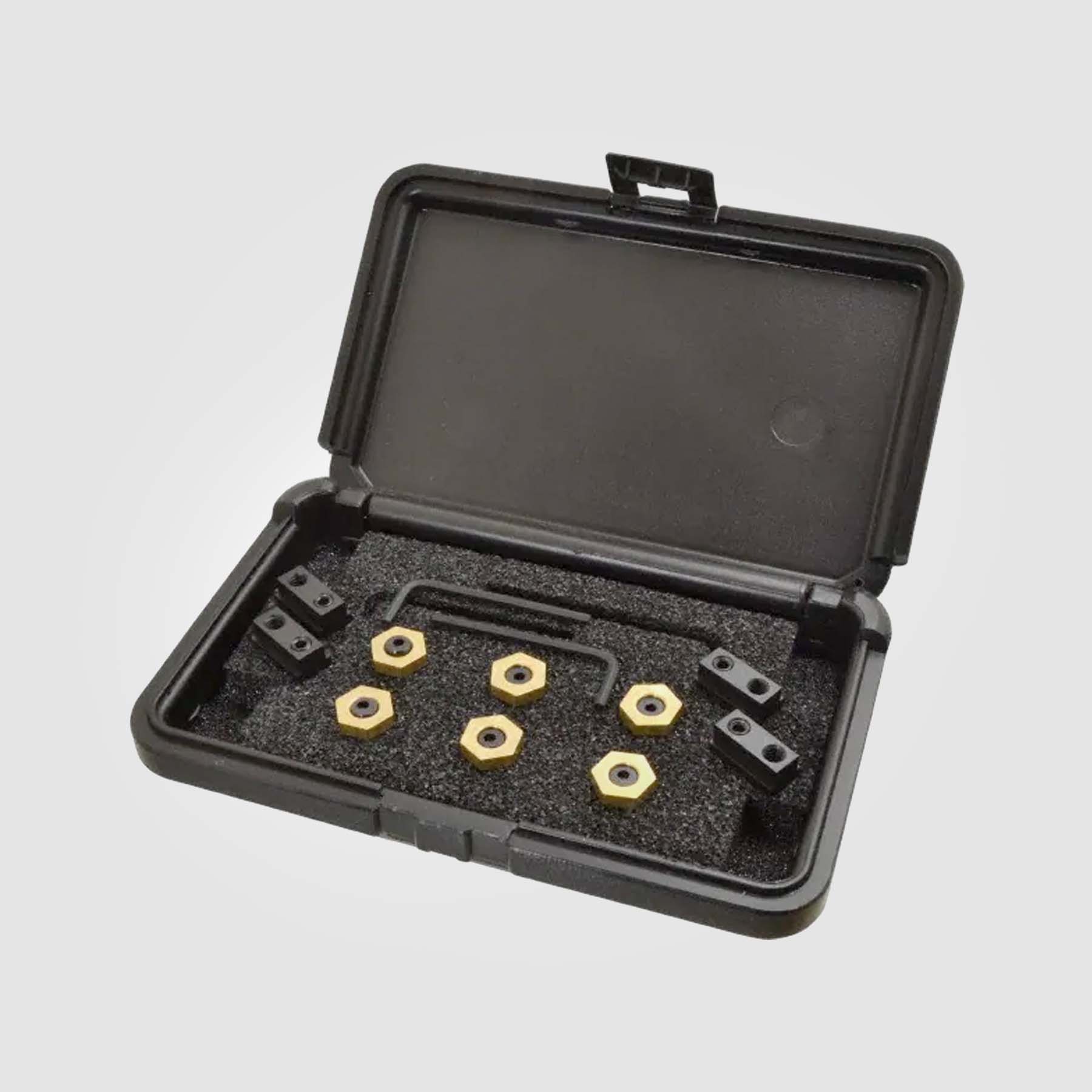

T-Slot Kits (Multiple Sizes)
#All
TITAN's go-to REPLACE for advanced fixturing and workholding setups!- Locks in machine T-slot for low profile clamping
- Makes fast set-ups possible right on the machine table
- Brass hex follows contour of unusual shaped parts
- 4 T-Nuts
- 6 Fixture Clamps
- 2 Hex Keys
#38TSlotKit
Technical Data- Quantity: 1
- T-Slot Size: 3/8"
- Screw Size: 1/4-20
- Max Torque: 6.2 ft-lb
- Holding Force: 800 lbs
