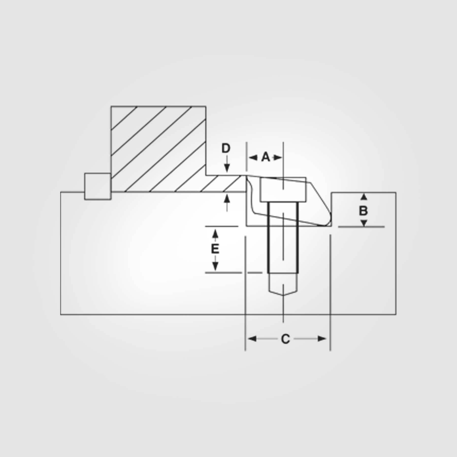

TITAN's go-to clamps for advanced fixturing and workholding setups!- Extremely low bite
- Positive down force
- High strength A2 Tool Steel virtually eliminates rip-out
- Simple, sturdy, high quality design and components
- Gain maximum tool access to your work
- Virtually eliminate lost work
- Great option with hydraulic cylinders
#0375X0075
Technical Data- Material: Tool Steel
- Feature: Blunt Edge
- Quantity: 8
- [C] Clamp Width: 0.375"
- [D] Clamp Height: 0.075"
- Screw Size: 4-40
- Max Torque: 1.30 ft-lbs
- Holding Force: 650 lbs
- Total Throw: 0.008"
