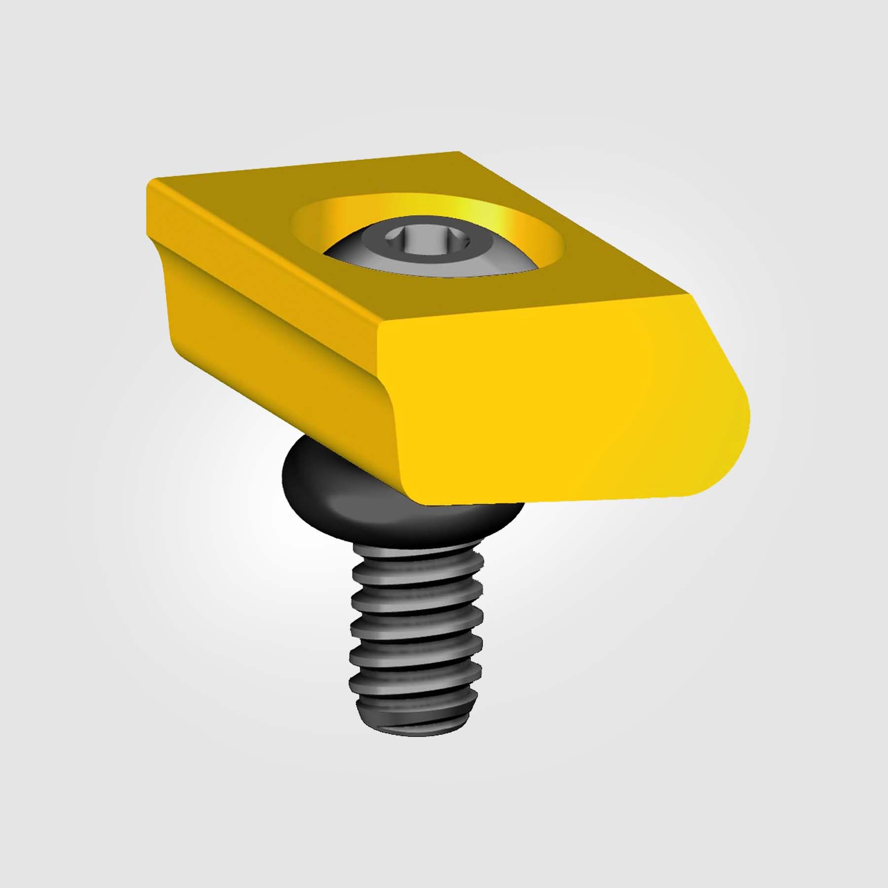

Pitbull® Clamps (Brass, Blunt Edge)
#All
TITAN's go-to clamps for advanced fixturing and workholding setups!- Extremely low bite
- Positive down force
- Simple, sturdy, high quality design and components
- Gain maximum tool access to your work
- Virtually eliminate lost work
- Great option with hydraulic cylinders
#0375X0075

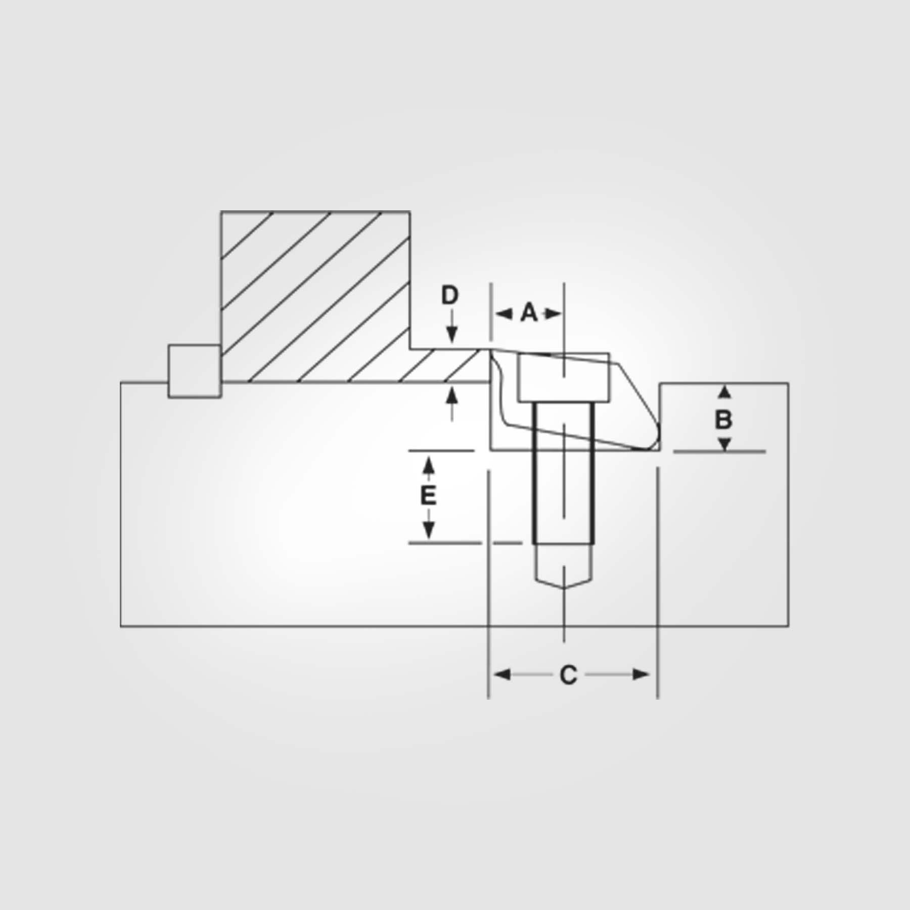

Technical Data- Material: Brass
- Feature: Blunt Edge
- Quantity: 8
- [C] Clamp Width: 0.375"
- [D] Clamp Height: 0.075"
- Screw Size: 4-40
- Max Torque: 1.30 ft-lbs
- Holding Force: 650 lbs
- Total Throw: 0.008"
#0500X0100
- Quantity: 8
- [C] Clamp Width: 0.500"
- [D] Clamp Height: 0.100"
- Screw Size: 8-32
- Max Torque: 3.70 ft-lbs
- Holding Force: 1500 lbs
- Total Throw: 0.016"
#0750X0150
- Quantity: 6
- [C] Clamp Width: 0.750"
- [D] Clamp Height: 0.150"
- Screw Size: 1/4-20
- Max Torque: 14.50 ft-lbs
- Holding Force: 3600 lbs
- Total Throw: 0.024"
#9520mmX1900mm
- Quantity: 8
- [C] Clamp Width: 9.520mm
- [D] Clamp Height: 1.900mm
- Screw Size: M2.5
- Max Torque: 1.8 N.m
- Holding Force: 2800 N
- Total Throw: 0.190mm
#12700mmX2540mm
- Quantity: 8
- [C] Clamp Width: 12.700mm
- [D] Clamp Height: 2.540mm
- Screw Size: M4
- Max Torque: 5.6 N.m
- Holding Force: 6600 N
- Total Throw: 0.406mm
#19050mmX3810mm
- Quantity: 6
- [C] Clamp Width: 19.050mm
- [D] Clamp Height: 3.810mm
- Screw Size: M6
- Max Torque: 22.5 N.m
- Holding Force: 16000 N
- Total Throw: 0.610mm
