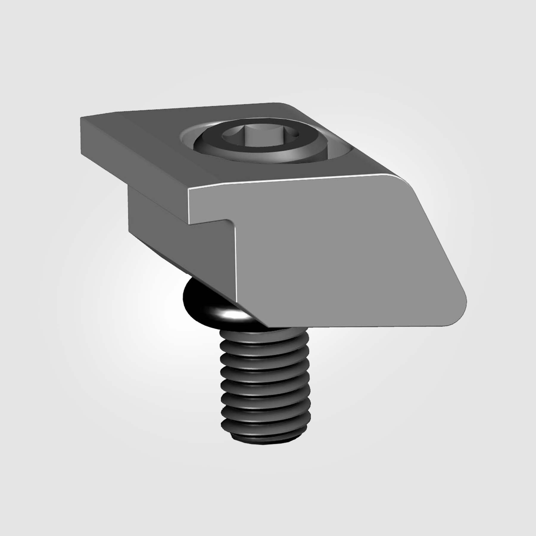

TITAN's go-to clamps for advanced fixturing and workholding setups!- Made of A2 tool steel and heat treated to about 43RC for long life
- Additional material on the clamping face to allow for machining a radius
- Available in two sizes with 6,000 and 12,000 lbs. (26000 and 50000 N) of holding force

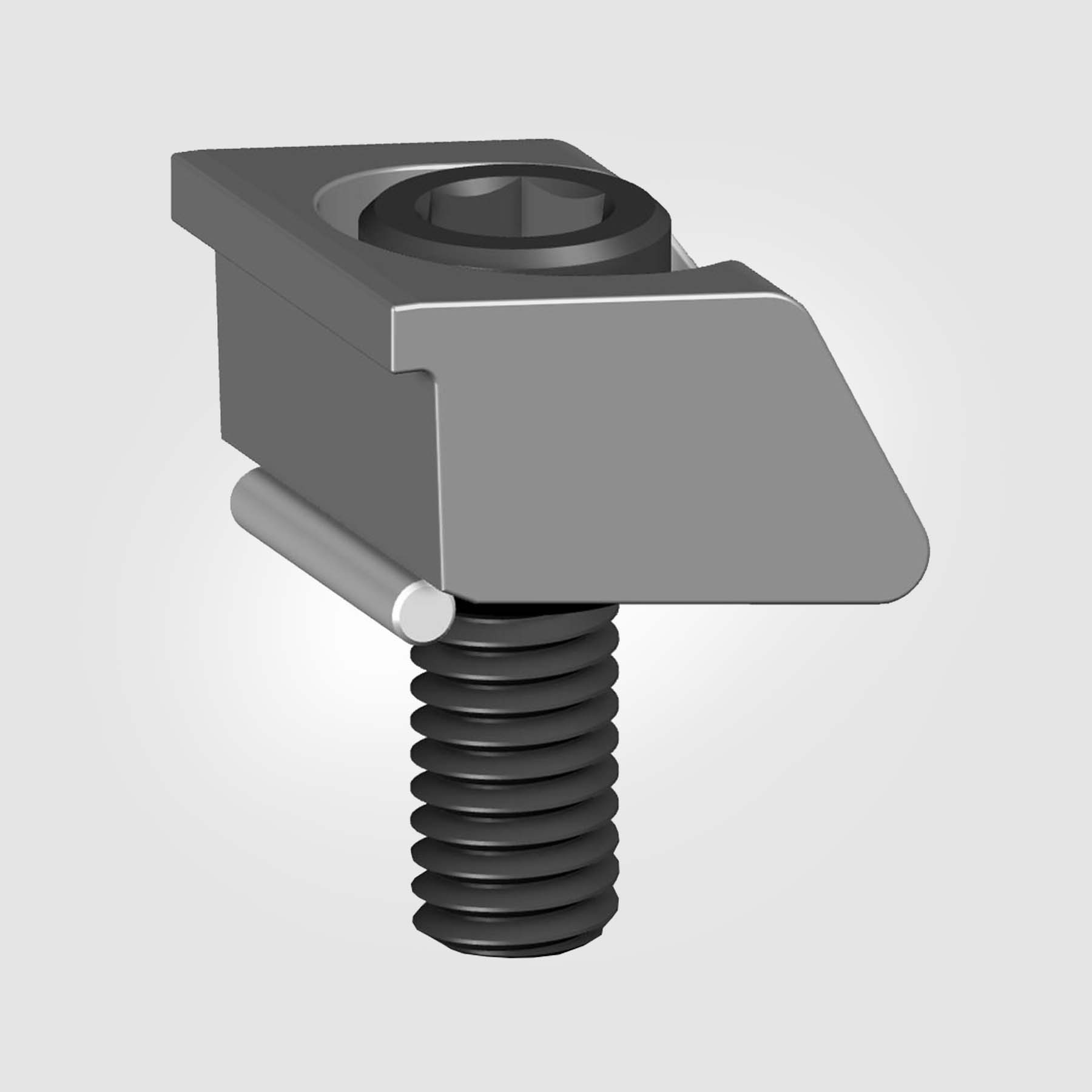

- Dowel pins are included in each package to locate clamps while machining radius
#3816
Technical Data- Quantity: 4
- [D] Min. Clamp Height: 0.250"
- Clamp Width: 1.000"
- Total Throw: 0.050"
- Dowel Pin: 1/8"
- Screw Size: 3/8-16
- Max Torque: 30 ft-lb
- Holding Force: 6000 lbs
#1213
Technical Data- Quantity: 2
- [D] Min. Clamp Height: 0.375"
- Clamp Width: 1.500"
- Total Throw: 0.075"
- Dowel Pin: 1/4"
- Screw Size: 1/2-13
- Max Torque: 108.3 ft-lb
- Holding Force: 12000 lbs
#M10
- [D] Min. Clamp Height: 6.350mm
- Clamp Width: 25.400mm
- Total Throw: 1.270mm
- Dowel Pin: 3.180mm
- Screw Size: M10
- Max Torque: 40.6 N.m
- Holding Force: 26000 N
#M12
- [D] Min. Clamp Height: 9.520mm
- Clamp Width: 38.100mm
- Total Throw: 1.900mm
- Dowel Pin: 6.350mm
- Screw Size: M12
- Max Torque: 145 N.m
- Holding Force: 50000 N
