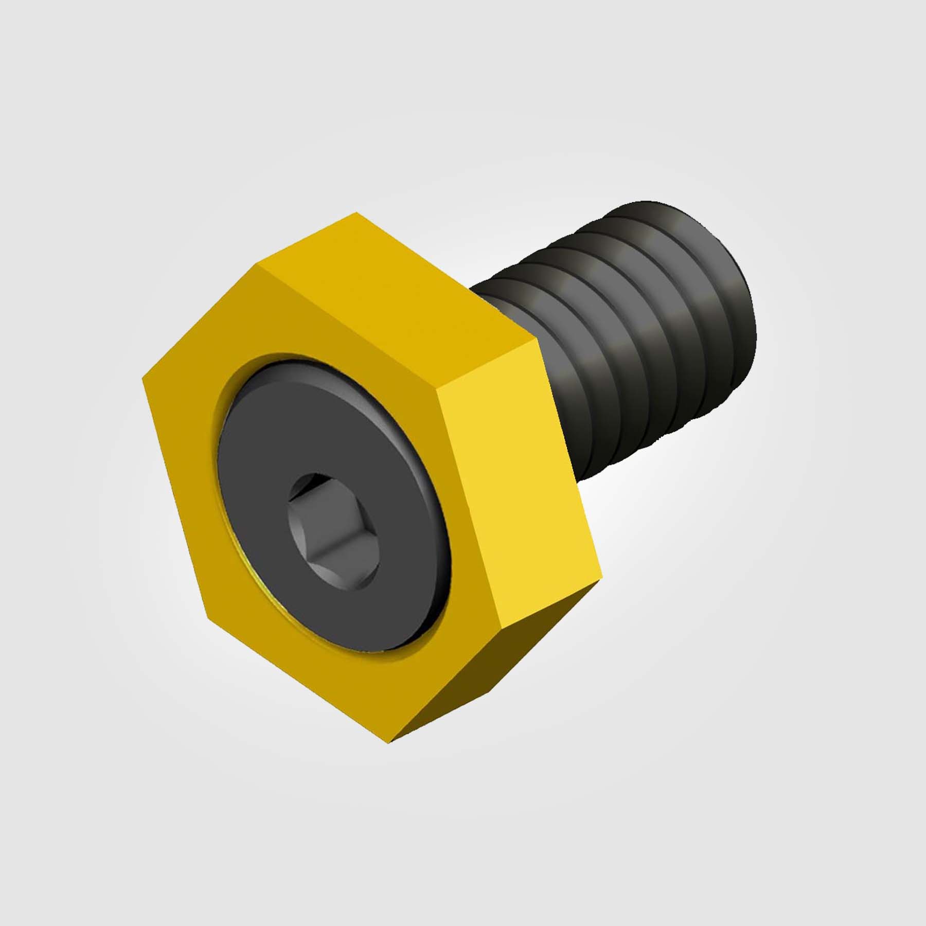

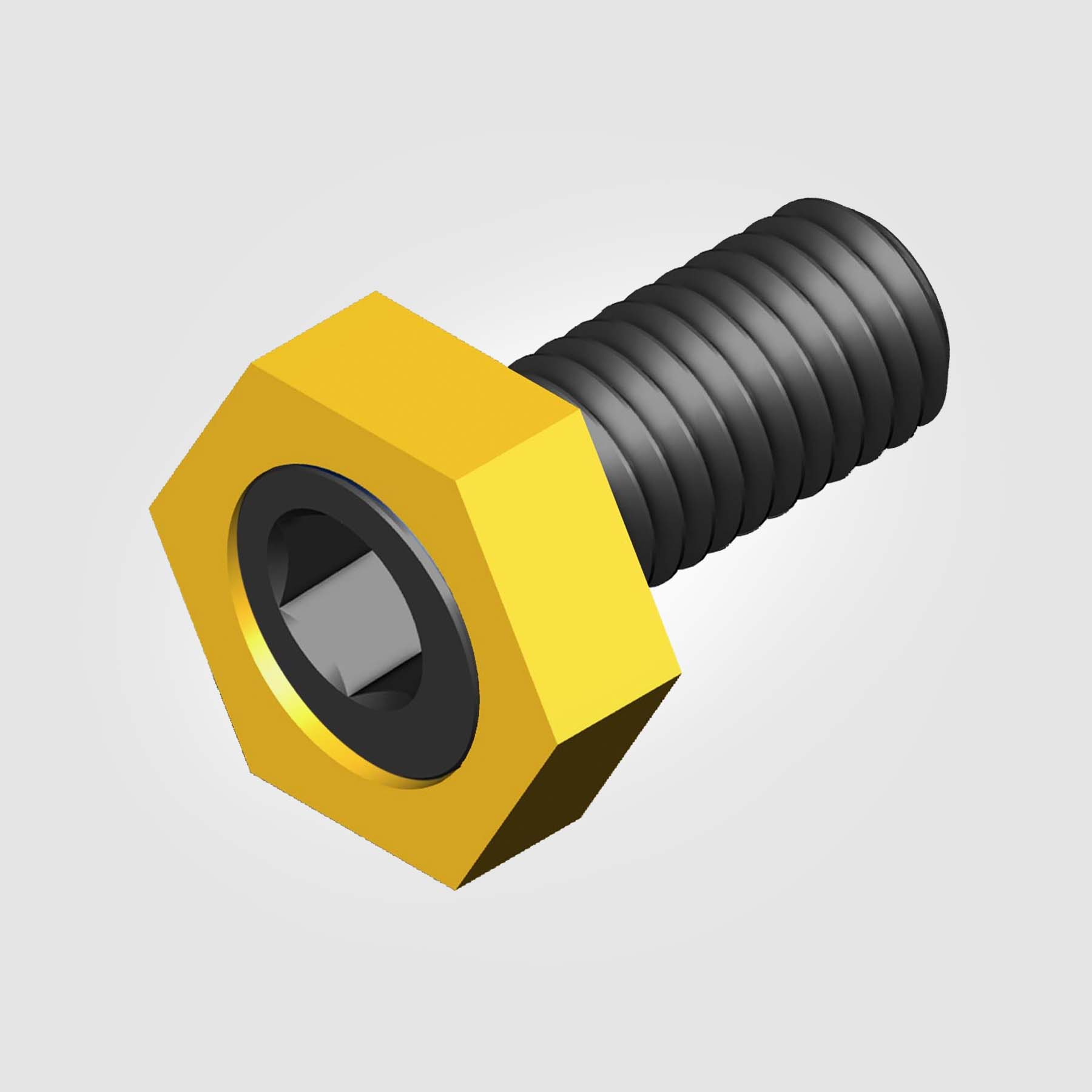

Cam Action Fixture Clamps (Brass or Steel, Multiple Sizes)
#All
TITAN's go-to clamps for advanced fixturing and workholding setups!- Low profile for quick and easy installation for linear motion guide rails
- Cam action provides fast, strong clamping
- Small size allows more parts per load
- Simple design keeps cost low

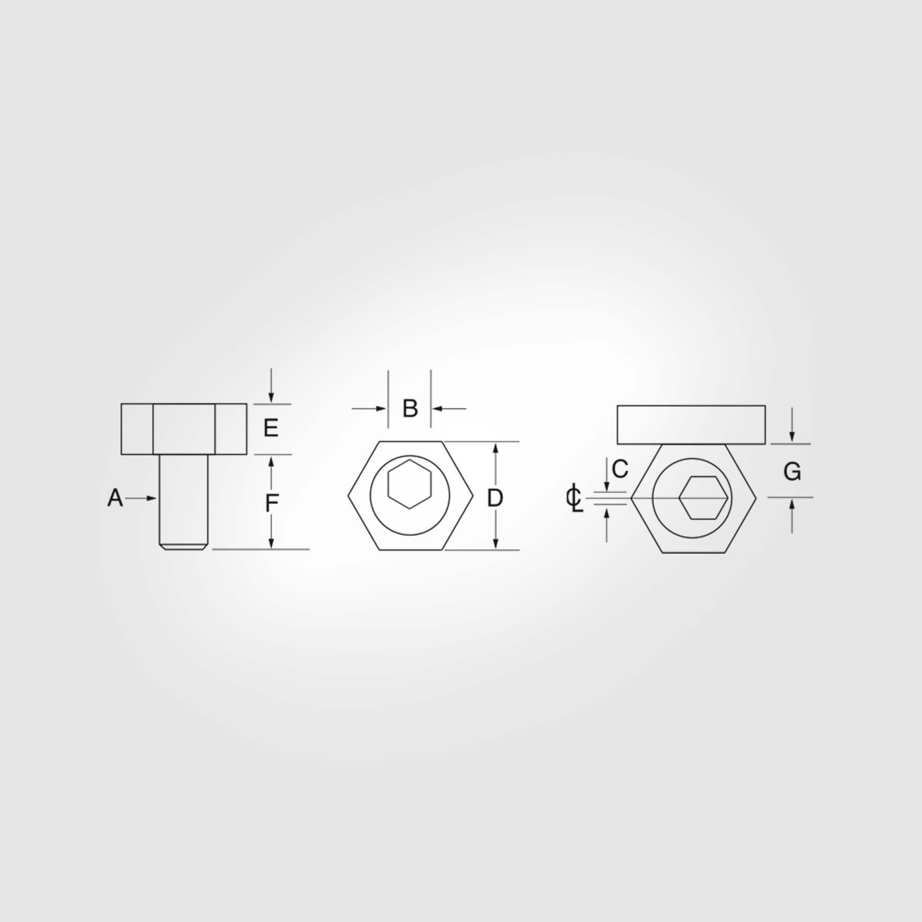

Technical Data- Quantity: 10
- Material: Brass
- [G] Drill and Tap Location: .150"
- Screw Size: 8-32
- Max Torque: 1.5 ft-lb
- Holding Force: 205 lbs
