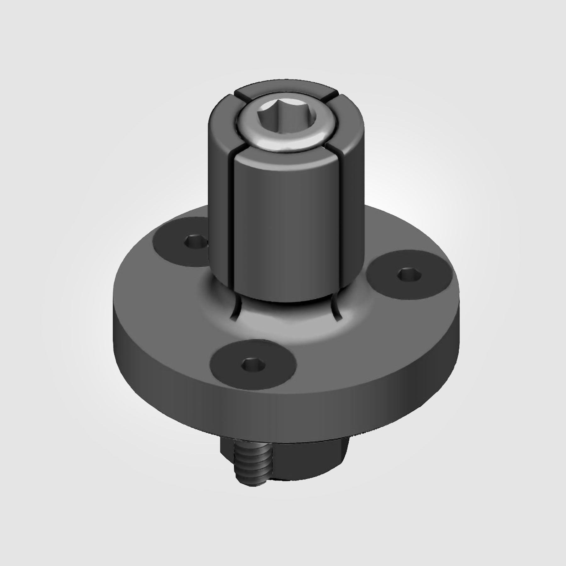

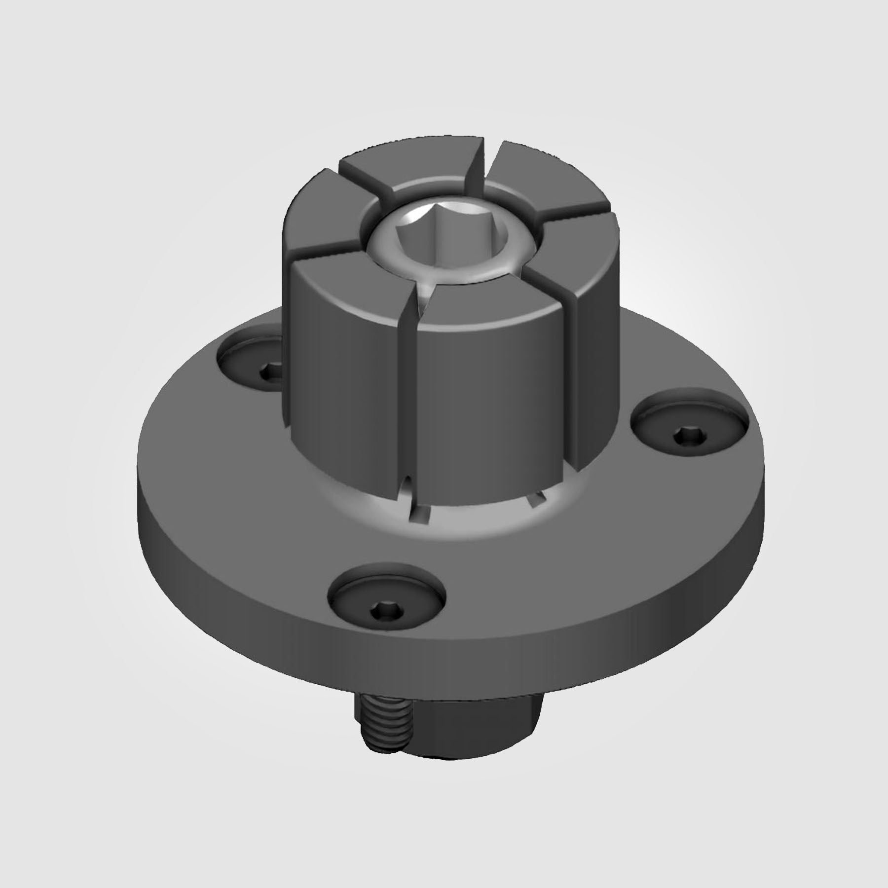

THE ART OF FIXTURING Tool Kit includes all of the tooling you need to complete the Art of Fixturing learning series projects, including the ID Xpansion Clamp. This clamp is the ideal solution to hold parts on an inside diameter for high density machining on vertical or horizontal machining centers. It can also be used as an expanding mandrel on a lathe.
Stock Up on Your Favorite Workholding!- Low profile
- Ideal for secondary operations on lathe parts
- Easily machined to size on lathe or mill
- Excellent for palletized setups
- Allows more parts per workcube or fixture plates
- Heat-treated and coated screw for long life
- Clamp body made of mild steel for machinability
- Tighten with hex key or hydraulic pull cylinders
- Longer screws available for hydraulic applications
- Quantity: 1
- Screw Size: 1/4-20"
- Max Torque: 13.3 ft-lb
- Holding Force: 1900 lbs
