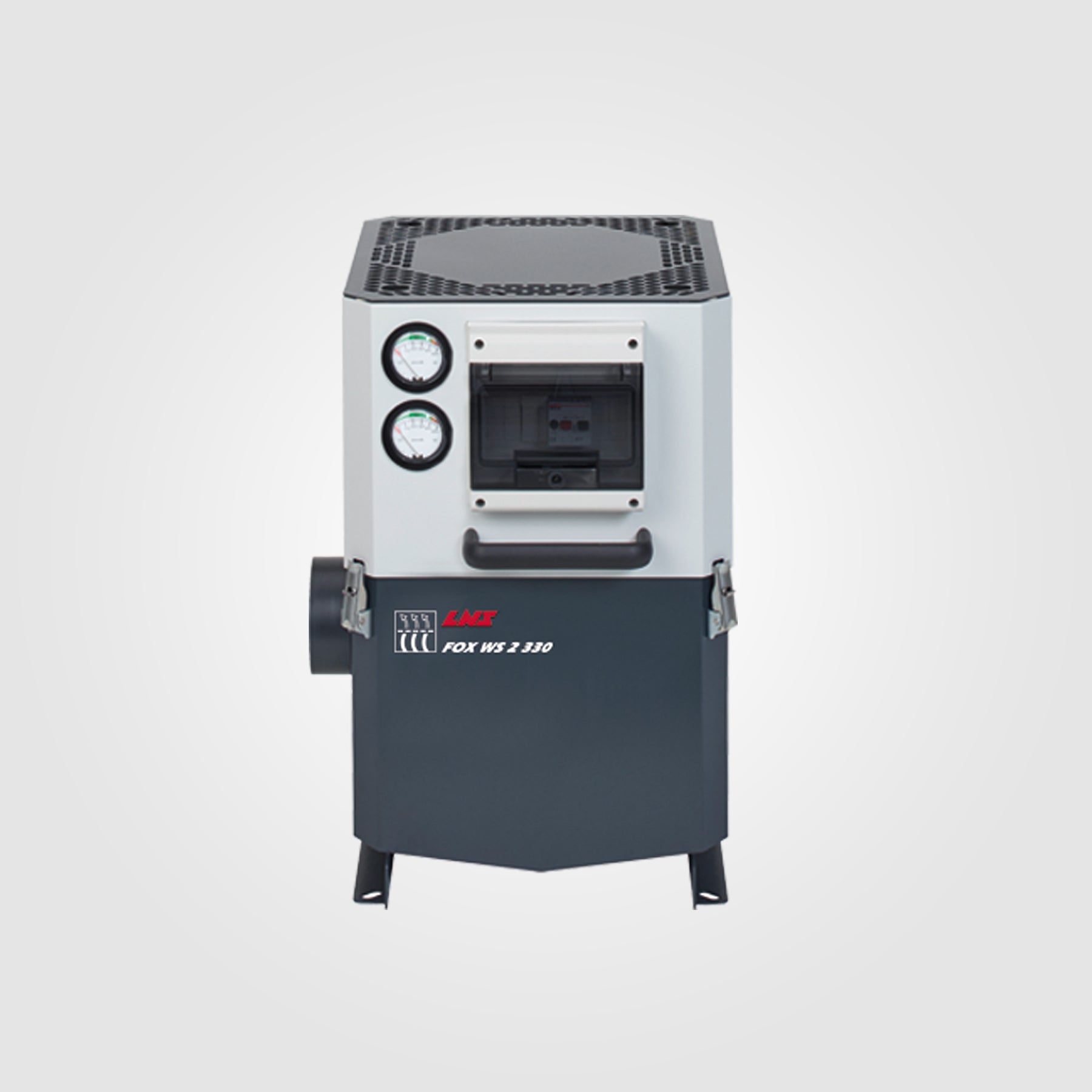

#330
- Air Flow: 330 CFM
- Static Pressure: 3.57 in. WC
- Motor: 0.6 hp
- Amps at 230V: 2
- Weight: 77 lb
- Sound Level: 65 dBA
- Filtration Efficiency: Up to 99.95% MPPS (EN 1822)
- Suction Inlet Diameter: 125 mm (5 in)

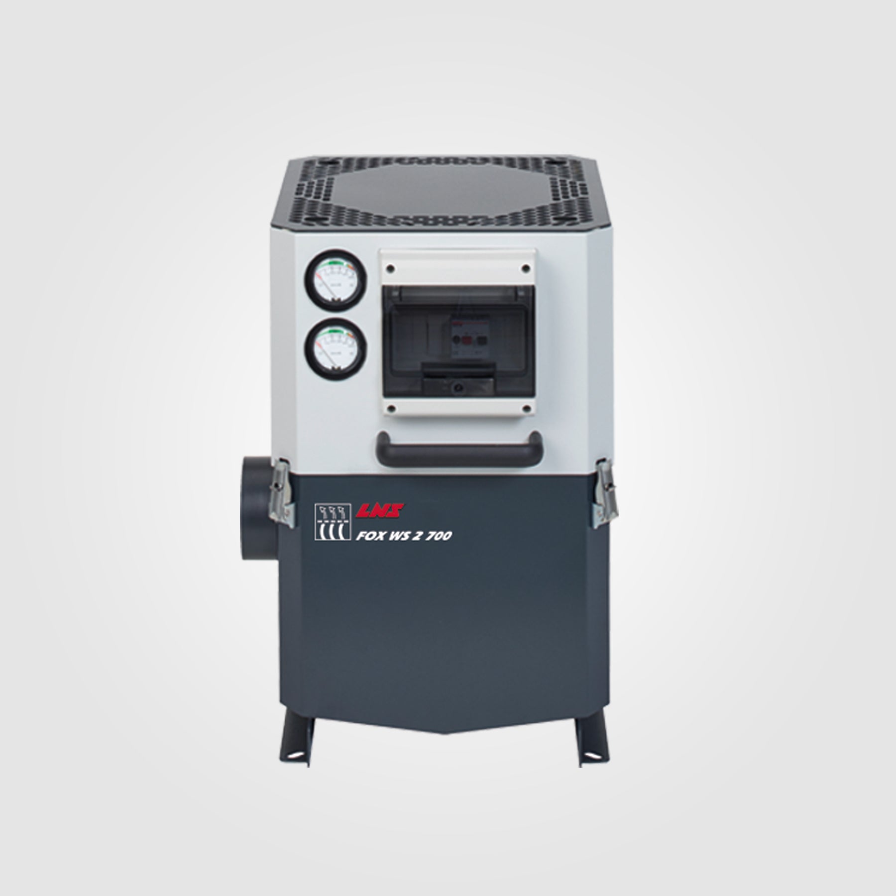

#700
- Air Flow: 665 CFM
- Static Pressure: 5.70 in. WC
- Motor: 1.2 hp
- Amps at 230V: 2.9
- Weight: 121 lb
- Sound Level: 71 dBA
- Suction Inlet Diameter: 150 mm (6 in)

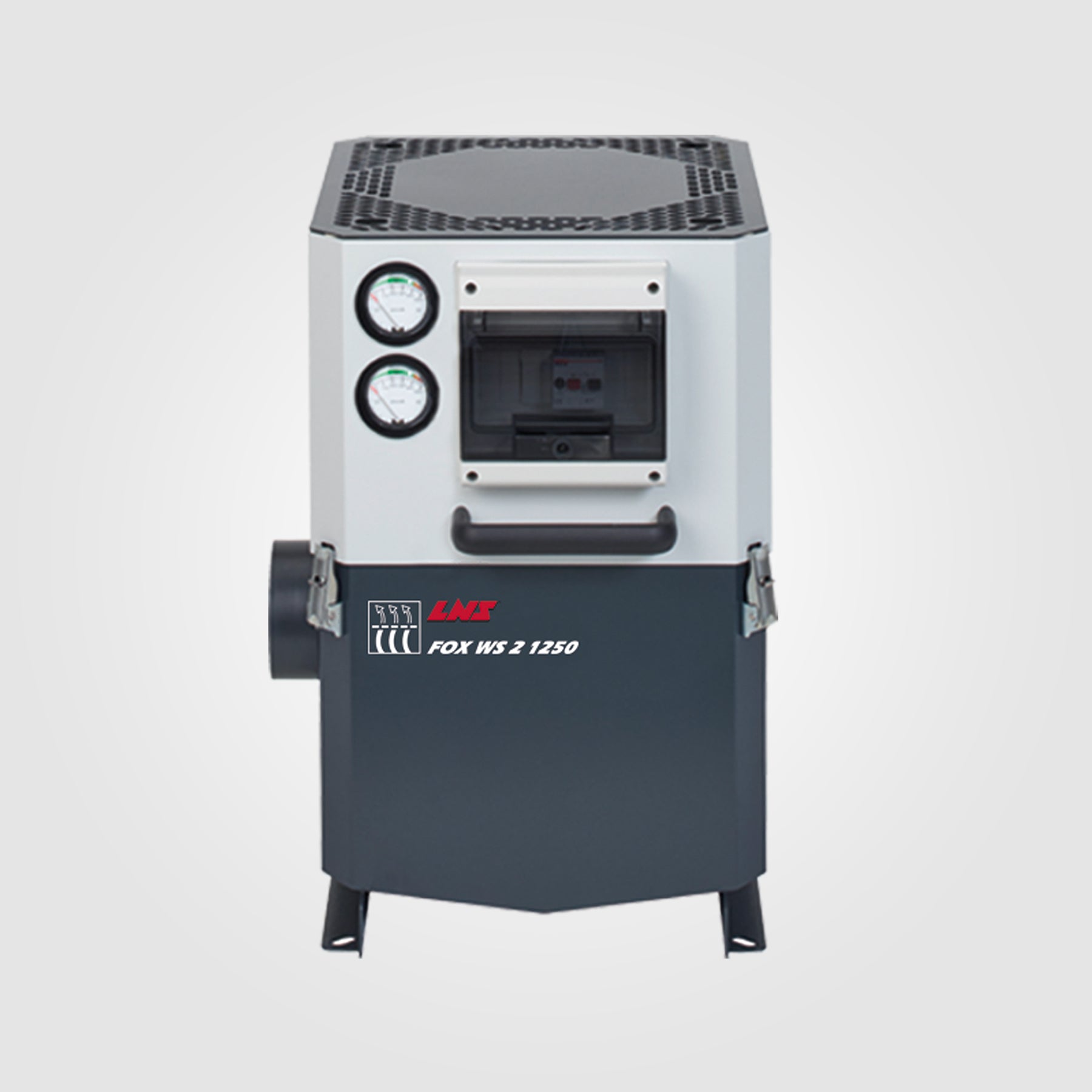

#1250
- Air Flow: 1,248 CFM
- Static Pressure: 9.23 in. WC
- Motor: 3.5 hp
- Amps at 230V: 8.3
- Weight: 187 lb
- Sound Level: 75 dBA
- Suction Inlet Diameter: 200 mm (8 in)

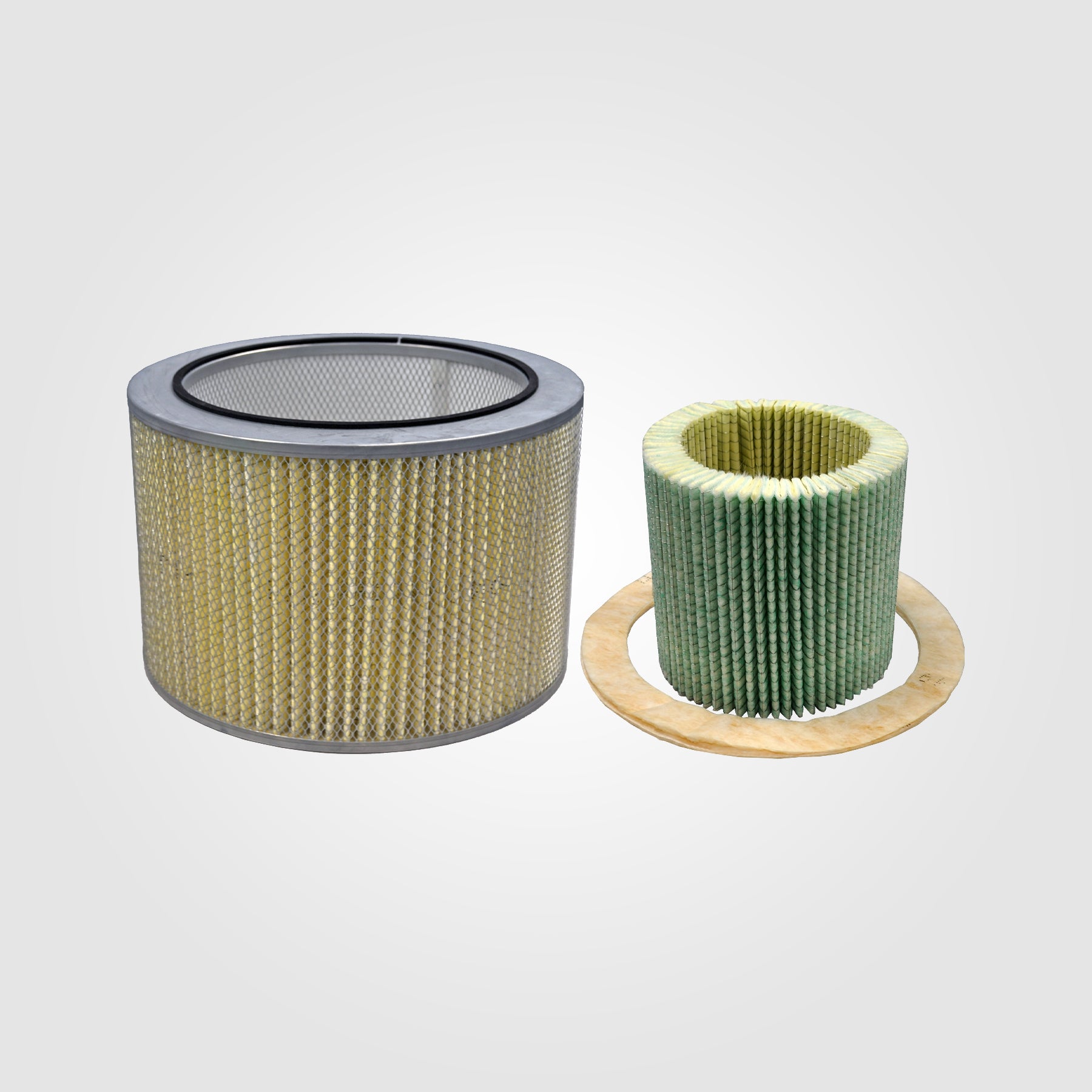

Oil Filters
The Pre-Filter captures large particles and combines mist droplets from emulsions. The Main Filter uses specialized media to target finer particulates and effectively maintain clean air in your shop.
For use only in oil and water-based coolant applications.
HEPA 13 Filter
HEPA filters capture at least 99.97% of all particles as small as 0.3 microns, including fine dust and smoke particles, exceeding typical health and safety regulations in precision manufacturing environments.
