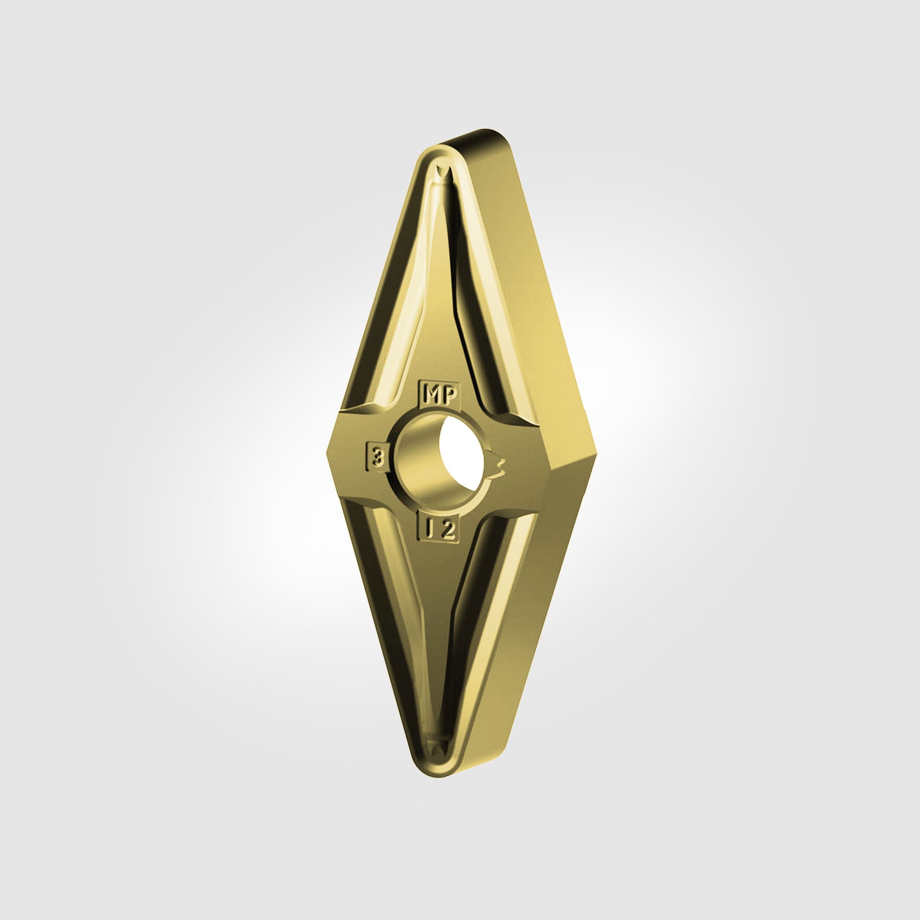

Kenloc™ Negative Inserts VNMG332MP KCU10B (5-PACK) 7093518
Kenloc™ Negative ISO Turning Inserts VNMG-MP
- Medium geometry with positive rake face for chip control in difficult materials.
- Stainless Steel, Steel, High-Temp Alloys

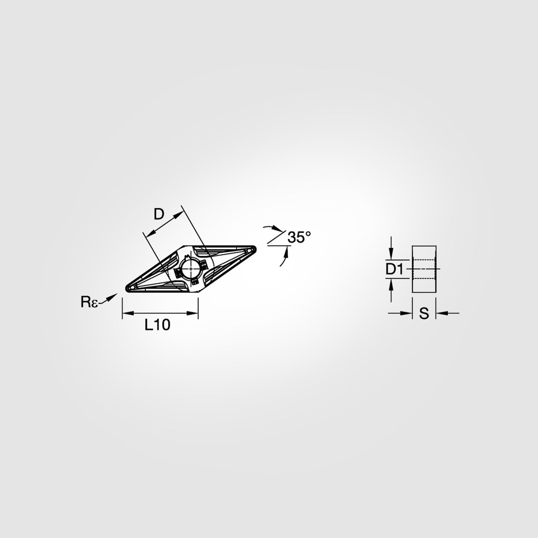

- [REPSILON] Corner Radius MM: 0.8000mm
- [REPSILON] Corner Radius Inch: 0.031250"
- [D1] Insert Hole Size Metric: 3.8100mm
- [D1] Insert Hole Size Inch: 0.1500"
- [S] Insert Thickness Metric: 4.7630mm
- [S] Insert Thickness Inch: 0.1875"
- [L10] Ins Cut Edge Length mm: 16.6060mm
- [L10] Ins Cut Edge Length In: 0.6538"
- [D] Insert IC Size Metric: 9.5250mm
- [D] Insert IC Size Inch: 0.3750"
