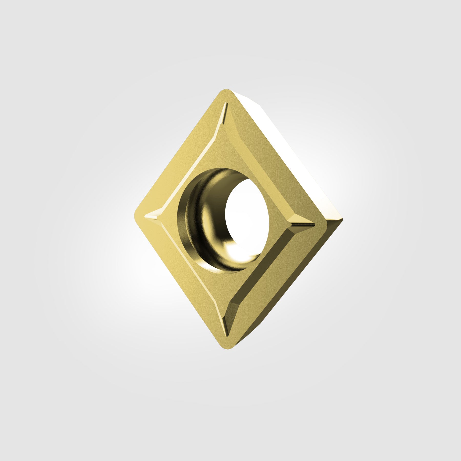

ISO Carbide Inserts CPMT-LF
- Finishing geometry with light cutting action.
- Used in multiple material groups.
- Stainless Steel, Steel, High-Temp Alloys

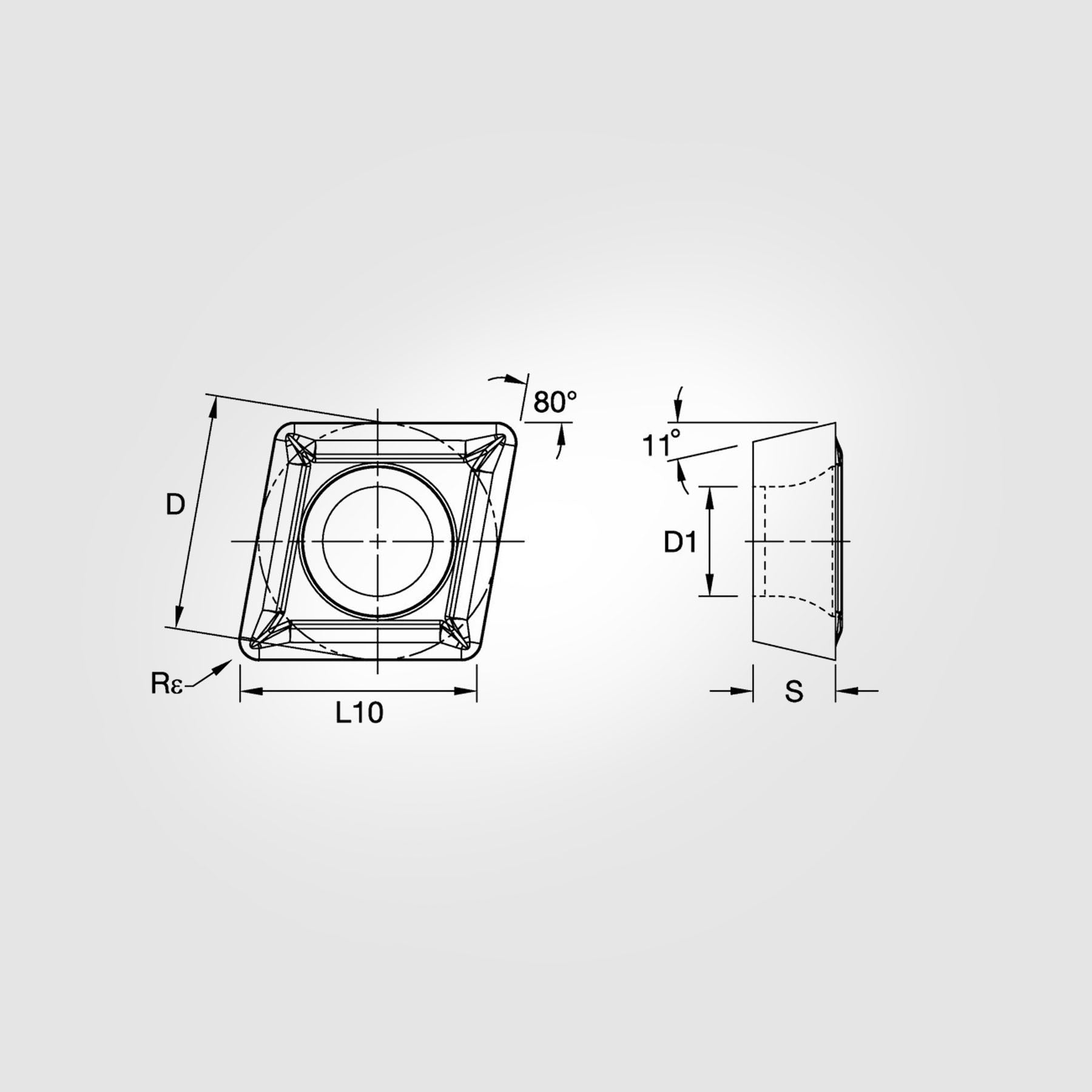

- [D1] Insert Hole Size Metric: 2.9000mm
- [D1] Insert Hole Size Inch: 0.1140"
- [S] Insert Thickness Metric: 2.3810mm
- [S] Insert Thickness Inch: 0.0940"
- [L10] Ins Cut Edge Length mm: 6.4500mm
- [L10] Ins Cut Edge Length In: 0.2539"
- [D] Insert IC Size Metric: 6.3500mm
- [D] Insert IC Size Inch: 0.2500"
