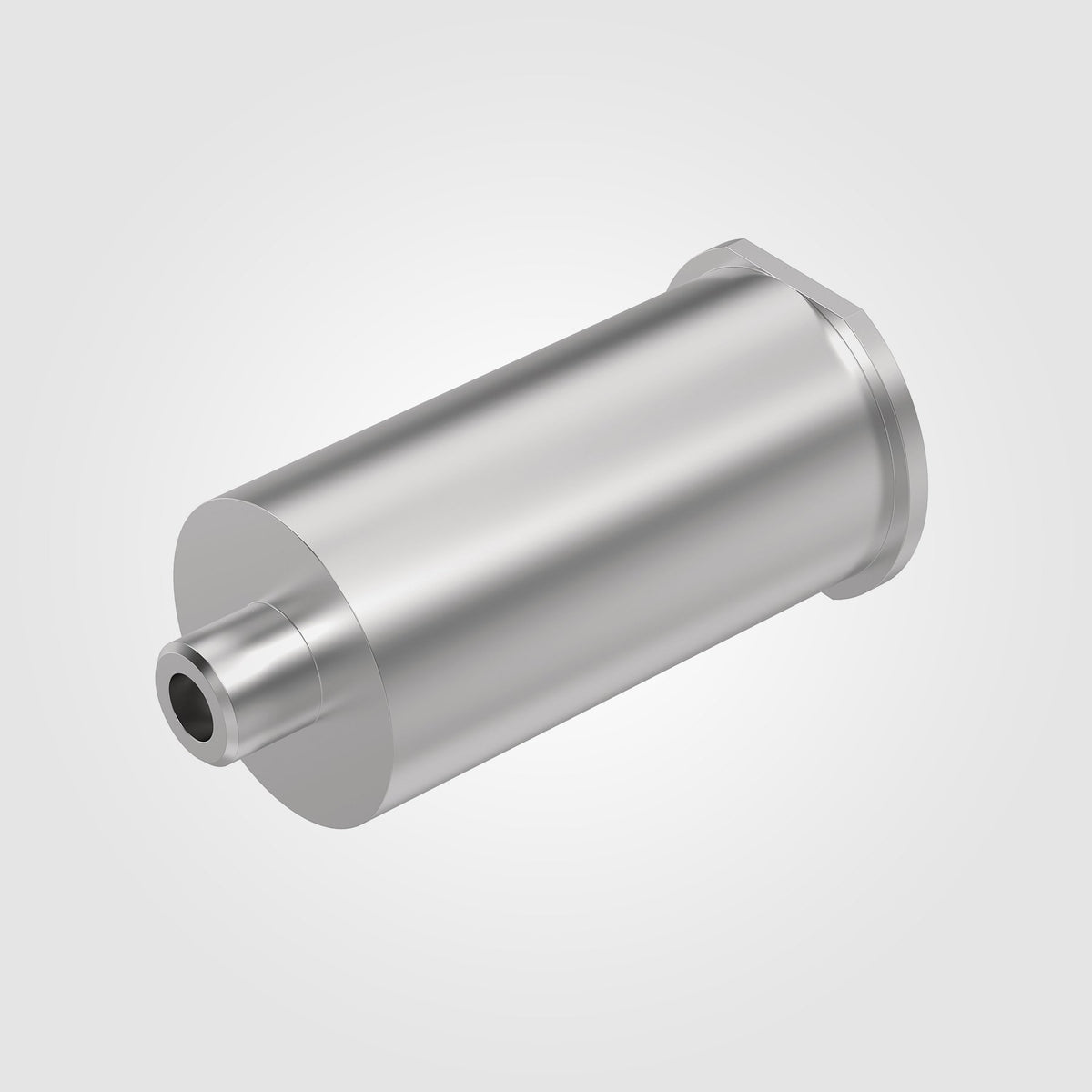

HYDRAULIC CHUCK REDUCER SLEEVES 1 1/4" or 32mm (SAFE-LOCK COMPATIBLE)
#114OD12ID2756
Kennametal™ Hydraulic Reduction Sleeves are designed for high-precision clamping of straight cylindrical cutting tool shanks. The self-sealing design enables efficient use of through-coolant cutting tools when the cutting tool shank completely engages the full gripping length of the sleeve.
Designed for Precision, Stability, and Efficiency- Accelerated feed rates offer increased productivity
- Four-wall pocket provides insert stability
- One-piece design with slot configuration to seal coolant
- Through coolant standard for improved tool life, hole finish, and chip removal
- Cutting tool must be cylindrical and have a through hole when using coolant
- SAFE-λOCK™ Shank prevents end mill pullout, enabling higher feed rates
- Units Supported: Inch with Inch Bores
- Adapter Style: SAFE-λOCK™
- Shank Outer Diameter: 1.250"
- Shank Inner Diameter: 0.500"
- Shank Length: 2.756"
- Gage Length: 0.098"
- Overall Length: 2.855"
