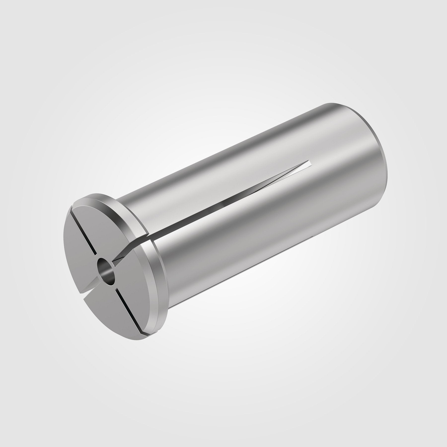

Kennametal™ Hydraulic Reduction Sleeves are designed for high-precision clamping of straight cylindrical cutting tool shanks. The self-sealing design enables efficient use of through-coolant cutting tools when the cutting tool shank completely engages the full gripping length of the sleeve.
Designed for Precision, Stability, and Efficiency- Accelerated feed rates offer increased productivity
- Four-wall pocket provides insert stability
- One-piece design with slot configuration to seal coolant
- Through coolant standard for improved tool life, hole finish, and chip removal
- Cutting tool must be cylindrical and have a through hole when using coolant
- Units Supported: Metric with Inch Bores
- Sleeve Series: HC20M
- Shank Outer Diameter (Metric): 20.000mm
- Shank Inner Diameter (Inch): 0.1875"
- Shank Inner Diameter (Metric): 4.763mm
- Shank Length (Metric): 50.000mm
- Gage Length (Metric): 4.000mm
- Overall Length (Metric): 54.000mm
