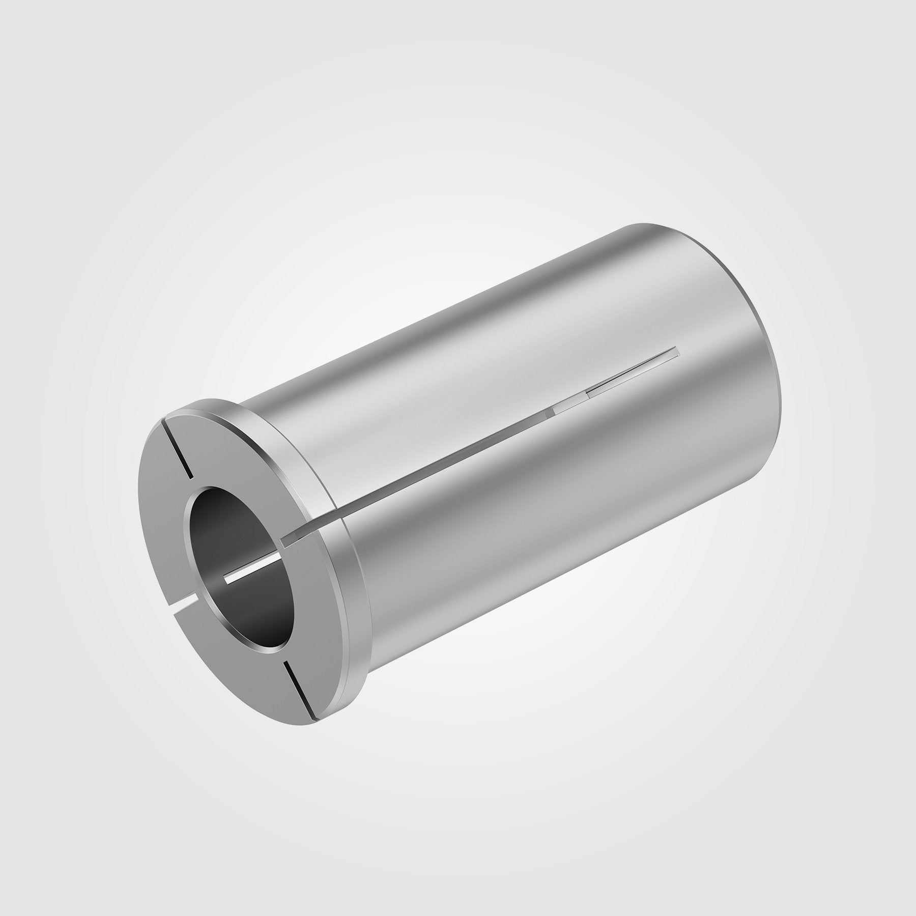

HYDRAULIC CHUCK REDUCER SLEEVES 3/4" - 1 1/4" (INCH with INCH BORES)
#34OD18ID19685
Kennametal™ Hydraulic Reduction Sleeves are designed for high-precision clamping of straight cylindrical cutting tool shanks. The self-sealing design enables efficient use of through-coolant cutting tools when the cutting tool shank completely engages the full gripping length of the sleeve.
Designed for Precision, Stability, and Efficiency- Accelerated feed rates offer increased productivity
- Four-wall pocket provides insert stability
- One-piece design with slot configuration to seal coolant
- Through coolant standard for improved tool life, hole finish, and chip removal
- Cutting tool must be cylindrical and have a through hole when using coolant
- Units Supported: Inch with Inch Bores
- Sleeve Series: HC750
- Shank Outer Diameter: 0.750"
- Shank Inner Diameter: 0.125"
- Shank Length: 1.9685"
- Gage Length: 0.1575"
- Overall Length: 2.126"
- Sleeve Series: HC1250
- Shank Outer Diameter: 1.250"
- Shank Inner Diameter: 0.875"
- Shank Length: 2.3622"
- Overall Length: 2.5197"
#114OD1ID23622
- Shank Inner Diameter: 1.000"
