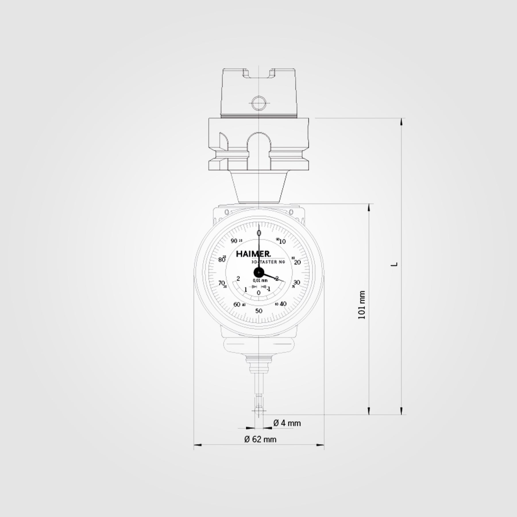

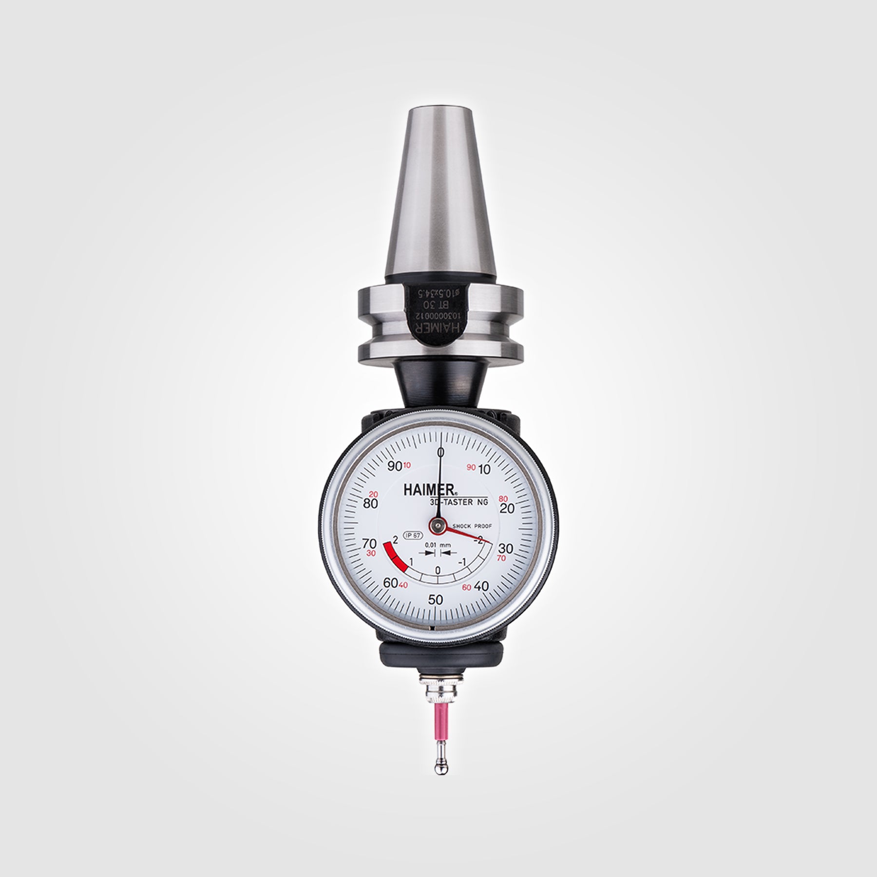

- With integrated short adapter in SK30, HSK-25/32/40/50/63 versions
- Accuracy: 0.01 mm
- Short and long probe tips available with no tool change necessary
- No recalibration of the sensor required
- Enhanced overrun distance
- IP67 waterproof
- For small milling and EDM machines (isolated probe)
- For workpiece reset and length measurement
- Approach from any direction (X-, Y-, or Z-axis)
#SK30
- Shank Type: SK30
- Accuracy: 0.01 mm
- Point Diameter: 4 mm
#HSKE50
- Shank Type: HSK-E50
- Accuracy: 0.01 mm
#HSKE40
- Shank Type: HSK-E40
- Accuracy: 0.01 mm
#HSKE32
- Shank Type: HSK-E32
- Accuracy: 0.01 mm
#HSKE25
- Shank Type: HSK-E25
- Accuracy: 0.01 mm
#HSKA63
- Shank Type: HSK-A63
- Accuracy: 0.01 mm
#HSKA50
- Shank Type: HSK-A50
- Accuracy: 0.01 mm
#HSKA40
- Shank Type: HSK-A40
- Accuracy: 0.01 mm
#HSKA32
- Shank Type: HSK-A32
- Accuracy: 0.01 mm
- Point Diameter: 3.80 mm
