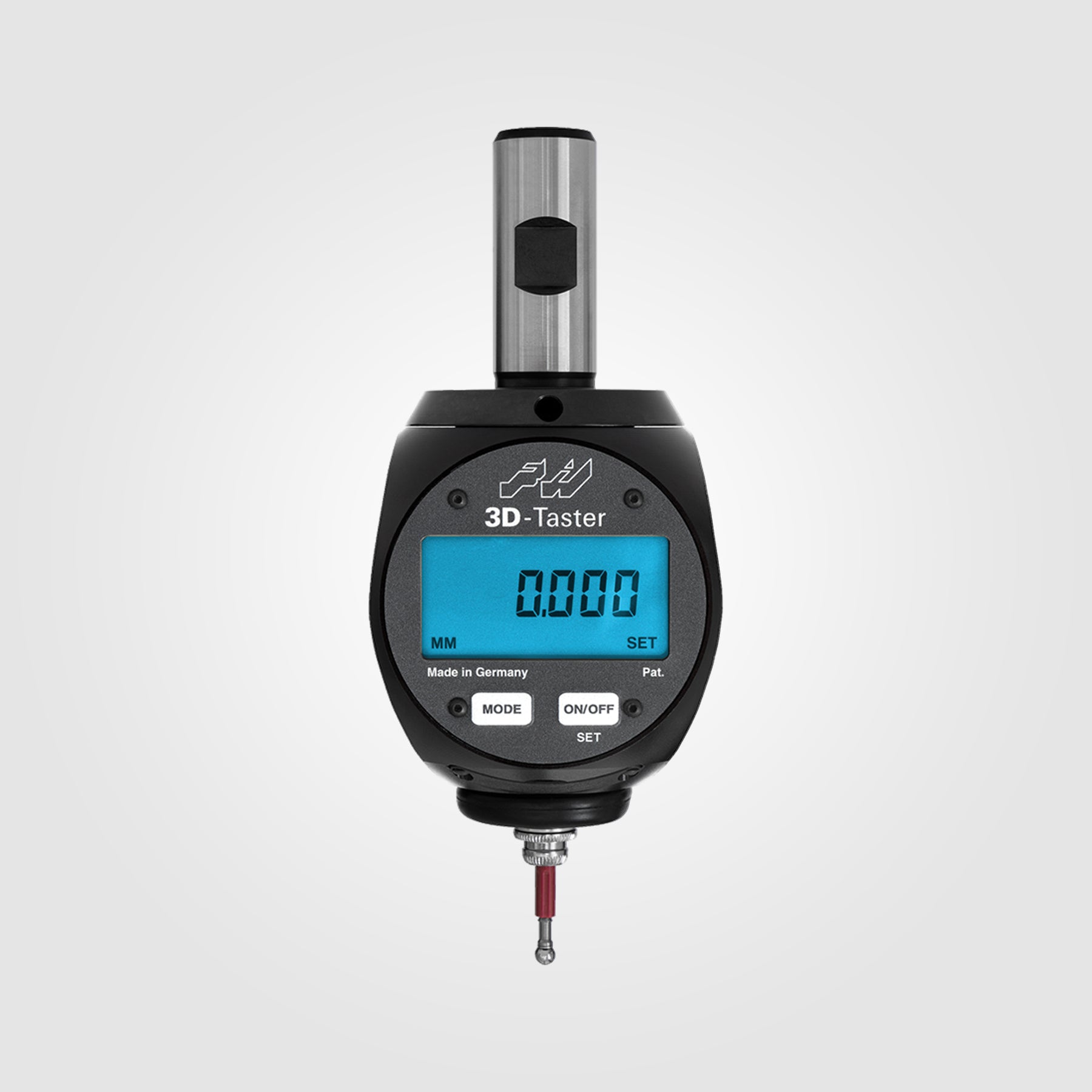

- Exact positioning of the spindle axis on the edges of the workpiece
- With integrated adapter
- Smallest unit of measure: 0.001 mm / 0.00005"
- Replaceable probes for maximum flexibility
- IP64 dust- and waterproof

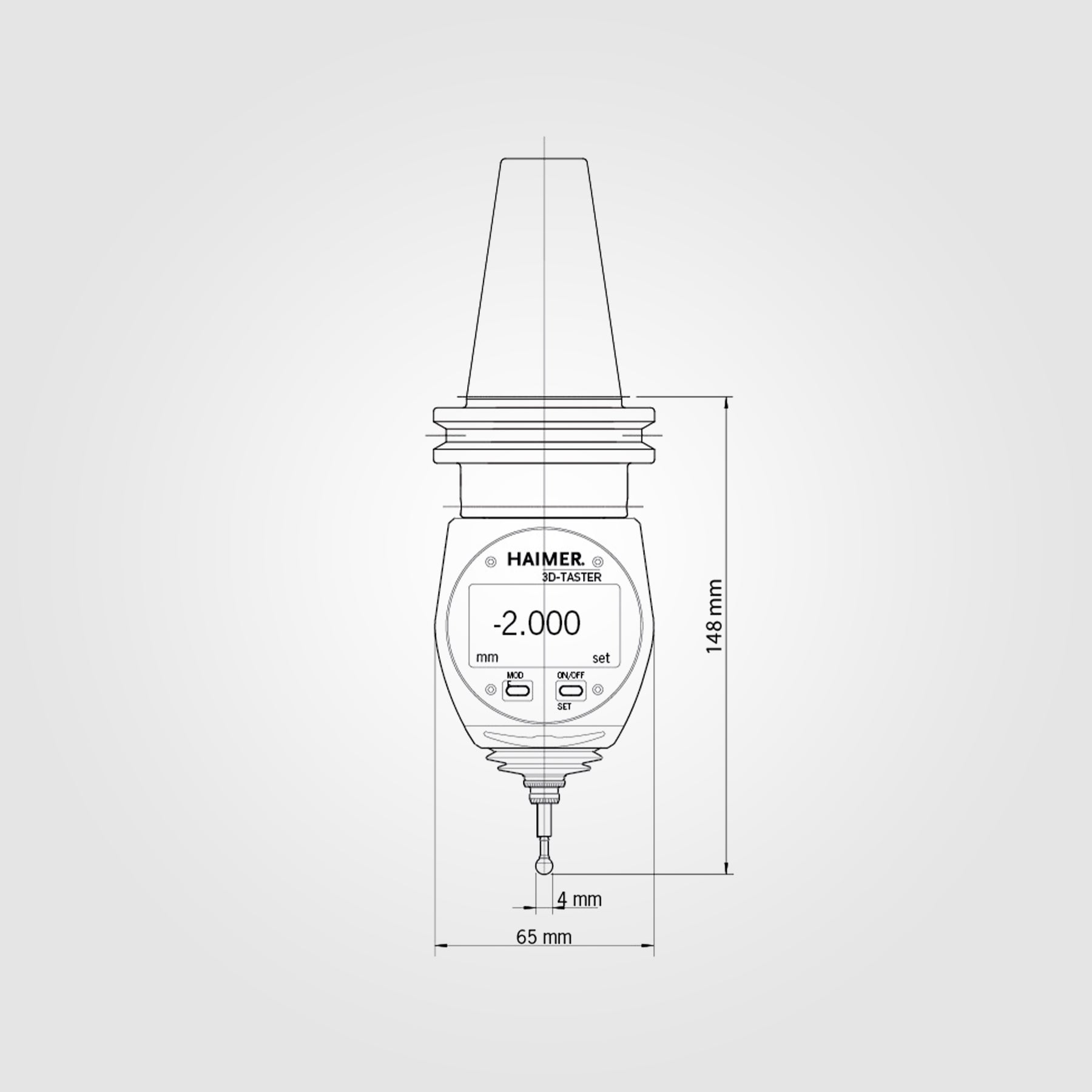

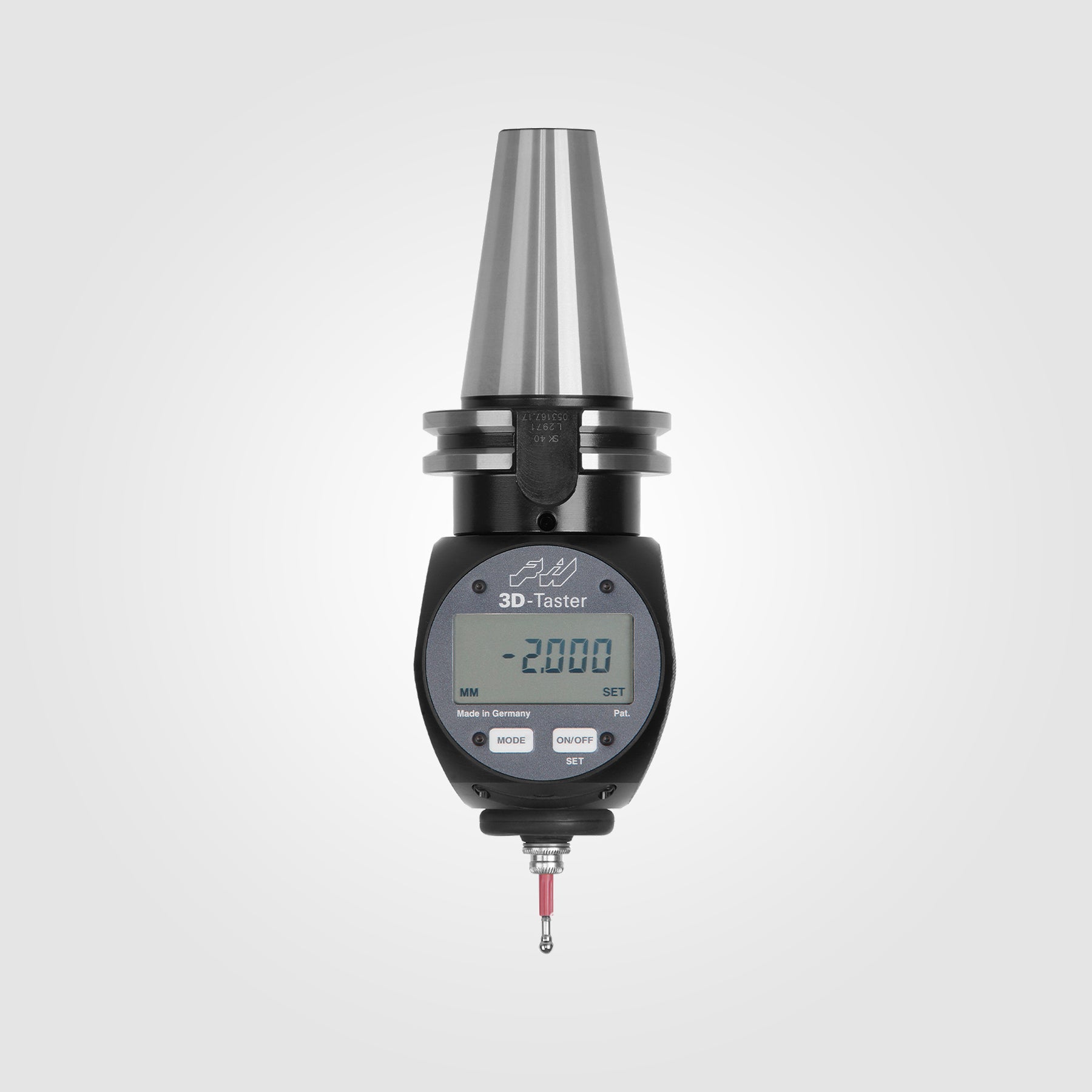

#wIntegratedAdapterBT40
- Shank Type: Taper
- Shank Size: BT40
- Accuracy: 0.0050 mm
- Point Diameter: 4 mm
#wIntegratedAdapterSK40
- Shank Type: Taper
- Shank Size: SK40

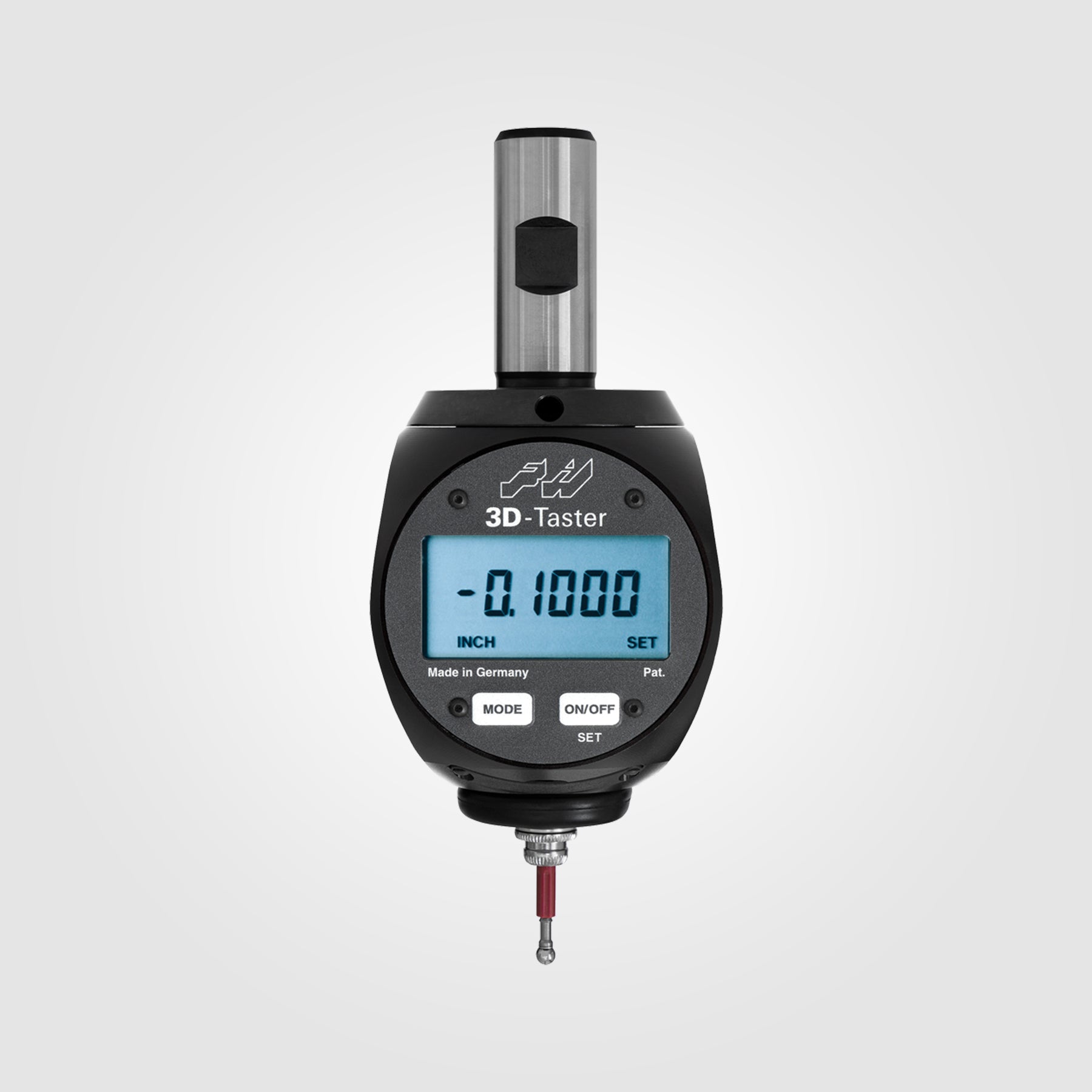

#Inch
- Shank Type: Straight
- Shank Size: 3/4"
- Point Diameter: 0.2000"
- Resolution: 0.00005"
