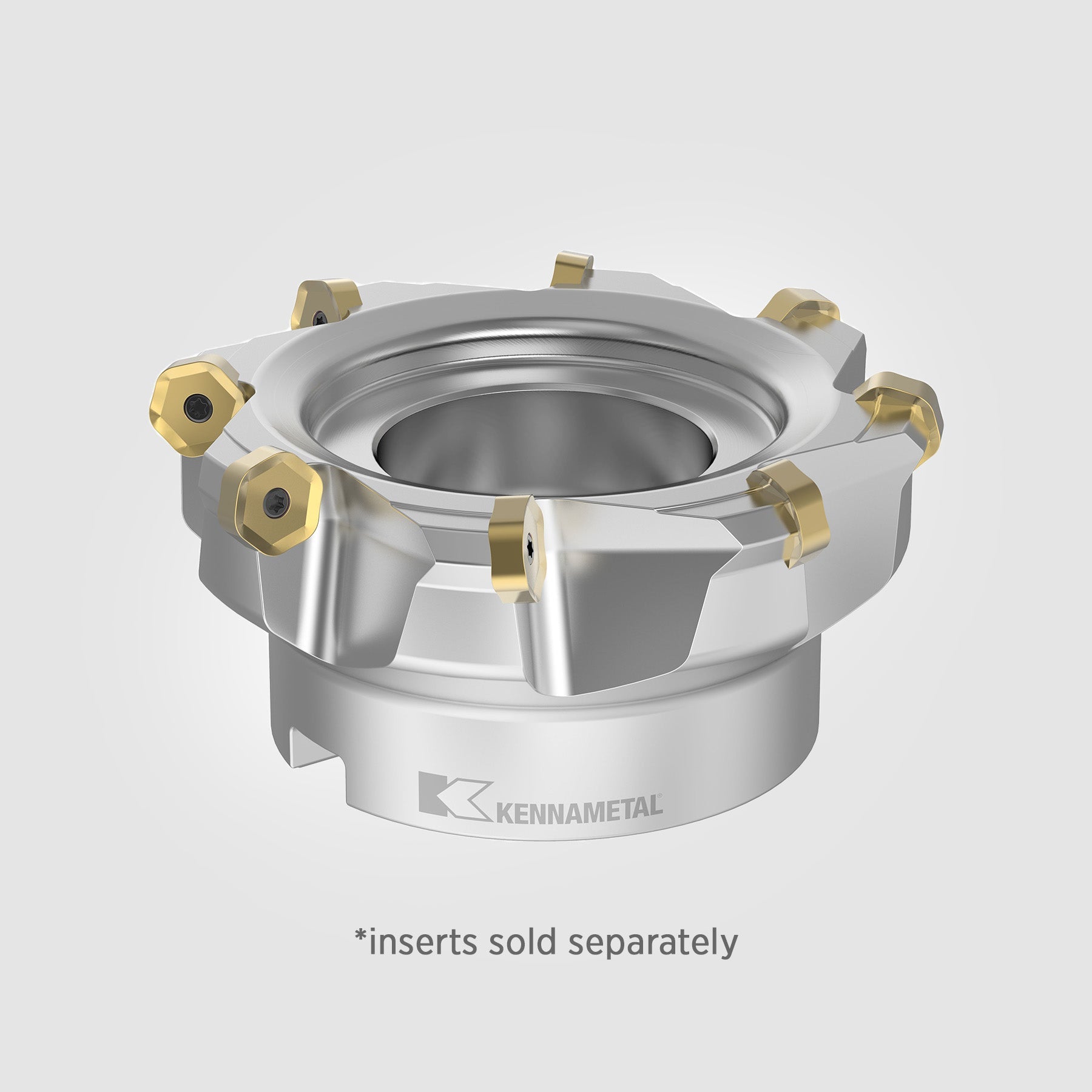

Dodeka Mini 60° Shell Mill 63mm Dia with 6 Flutes 4147717
TITAN's Go-To Shell Mill!
- Chamfer Milling
- Face Milling
- Number of Flutes: 6
- Arbor Diameter (Inch): 0.8661"
- Arbor Diameter (Metric): 22.000mm
- Effective Cutting Diameter (Inch): 2.480"
- Effective Cutting Diameter (Metric): 63.000mm
- Maximum Cutting Diameter (Inch): 2.730"
- Maximum Cutting Diameter (Metric): 69.340mm"
- Maximum Cutting Depth (Inch): 0.171"
- Maximum Cutting Depth (Metric): 4.300mm
- Overall Length (Inch): 1.575"
- Overall Length: 40.000mm
- Max RPM: 10,100
