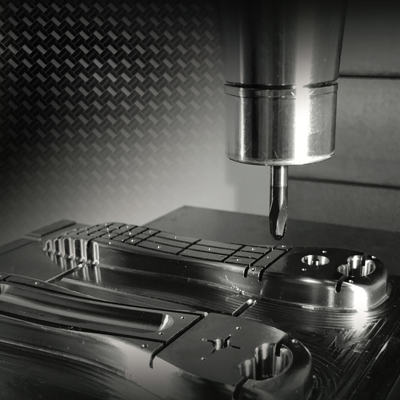

The YCM C10DM is a 20,000 rpm vertical machining center built for precision surface finish and fast cycle times. Roller linear guides, hand-scraped castings, and YCM’s IDD spindle design keep cuts stable and predictable in aluminum through hard steels.
Country of Origin: Taiwan
Customize Your CNC
High-Speed Cutting Platform
The C10DM pairs a 20,000 rpm HSK63A spindle with 40.1 × 23.6 × 23.6 in (1,020 × 600 × 620 mm) travels and a 44.1 × 25.59 in table. MXP-200FB+ (FANUC 0iMF+) control, 30/48/60-tool magazine options, and 2,204 lb (1,000 kg) table load make it a compact, production-ready platform for high-accuracy parts.
