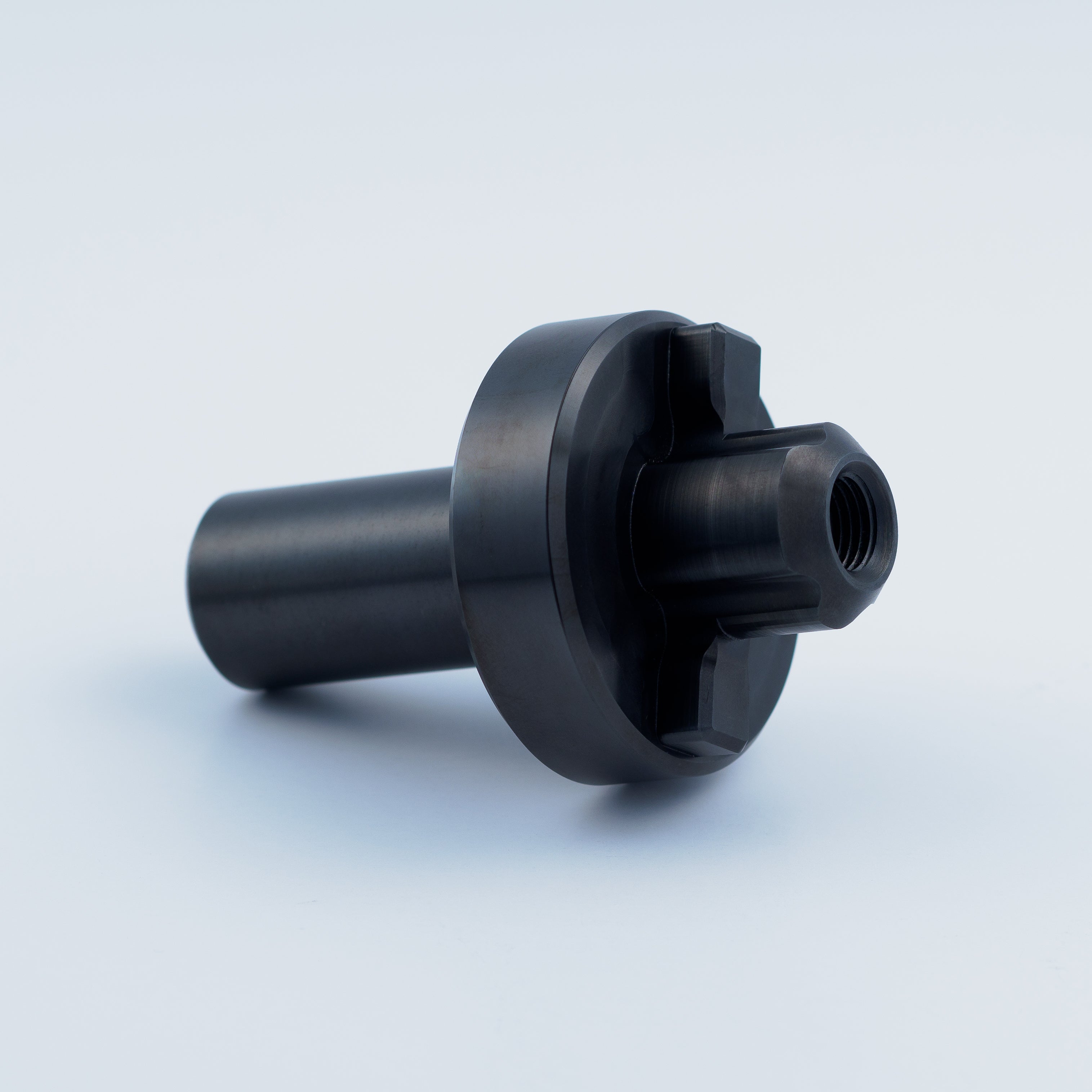

3/4" Arbor Adapter for 2" Face Mills
Designed by Machinists, for Machinists!

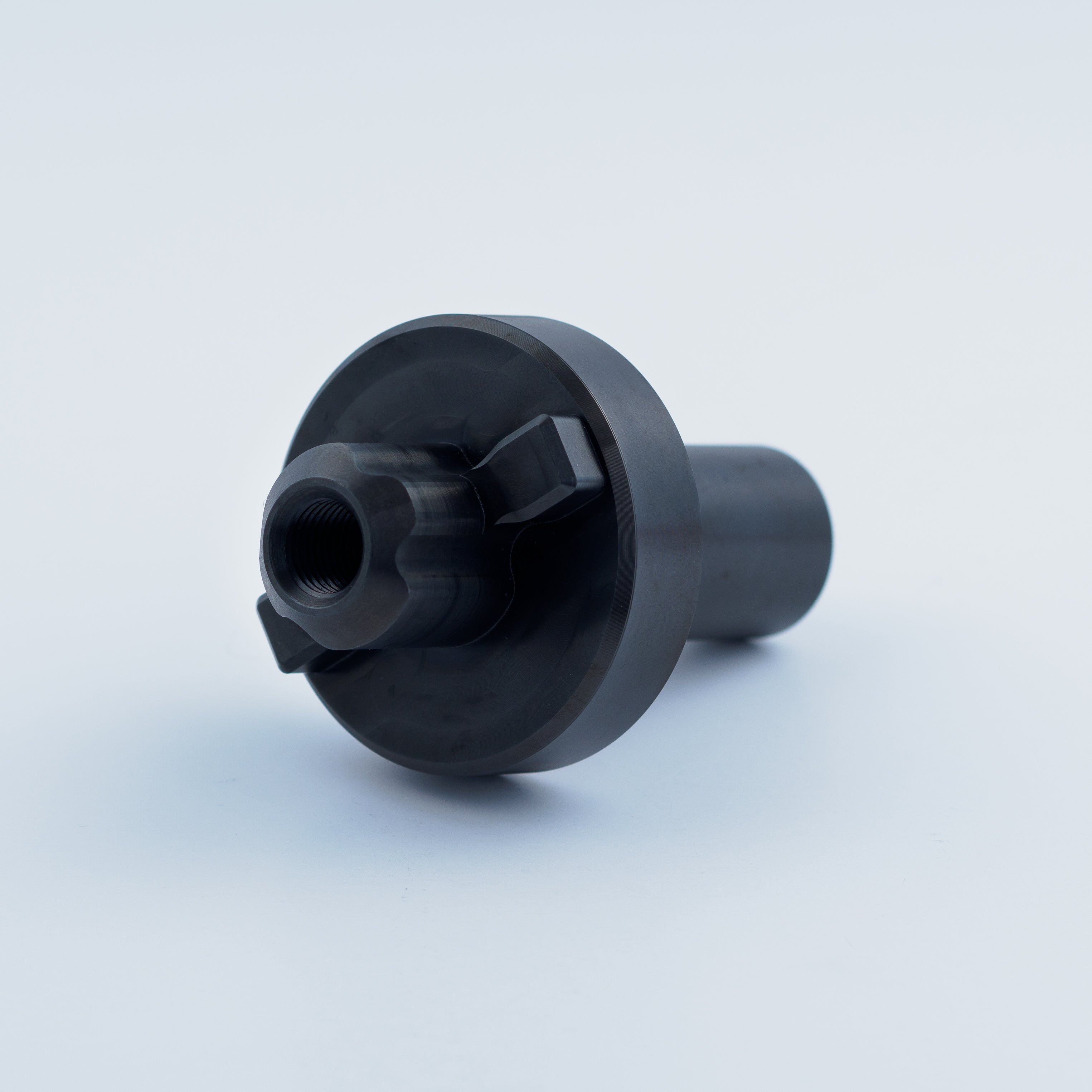

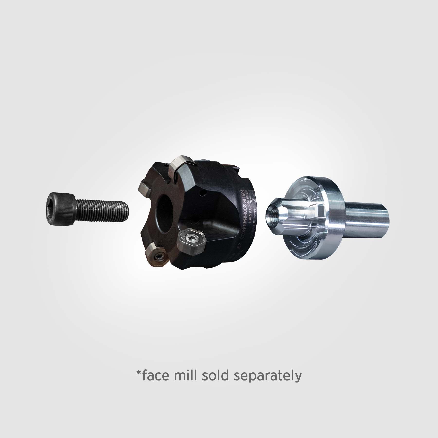

Custom designed and machined arbor adapter by TEAM TITAN. Fits most 2" face mills (including: Dodeka, 7792, and 5720 tooling). Manufactured with lower HP machines in mind.
Designed and Made in the USA by TITANS of CNC.
Tech Specs
| Item | Description |
| Material | 1045 Steel (Black Oxide) |
| Adapter Type | Arbor |
| System Size | 3/4" Shank |
| Through Coolant | No |
| Specification | Inch | Metric |
| [D1] Shank Diameter | 0.750" | 19.050mm |
| [D2] Body Diameter | 1.700" | 43.180mm |
| [D3] Arbor Diameter | .750" | 19.020mm |
| [L1] Shank Length | 1.150" | 29.100mm |
| [L2] Flange Length | .500" | 12.700mm |
| [L3] Arbor Length | .740" | 18.800mm |
| [L4] Key Width | .318" | 8.080mm |
| [L5] Key Height | .220" | 5.460mm |
| [T1] Thread Size | 3/8-24" ↧ .750" | M10 x 1.5 |
