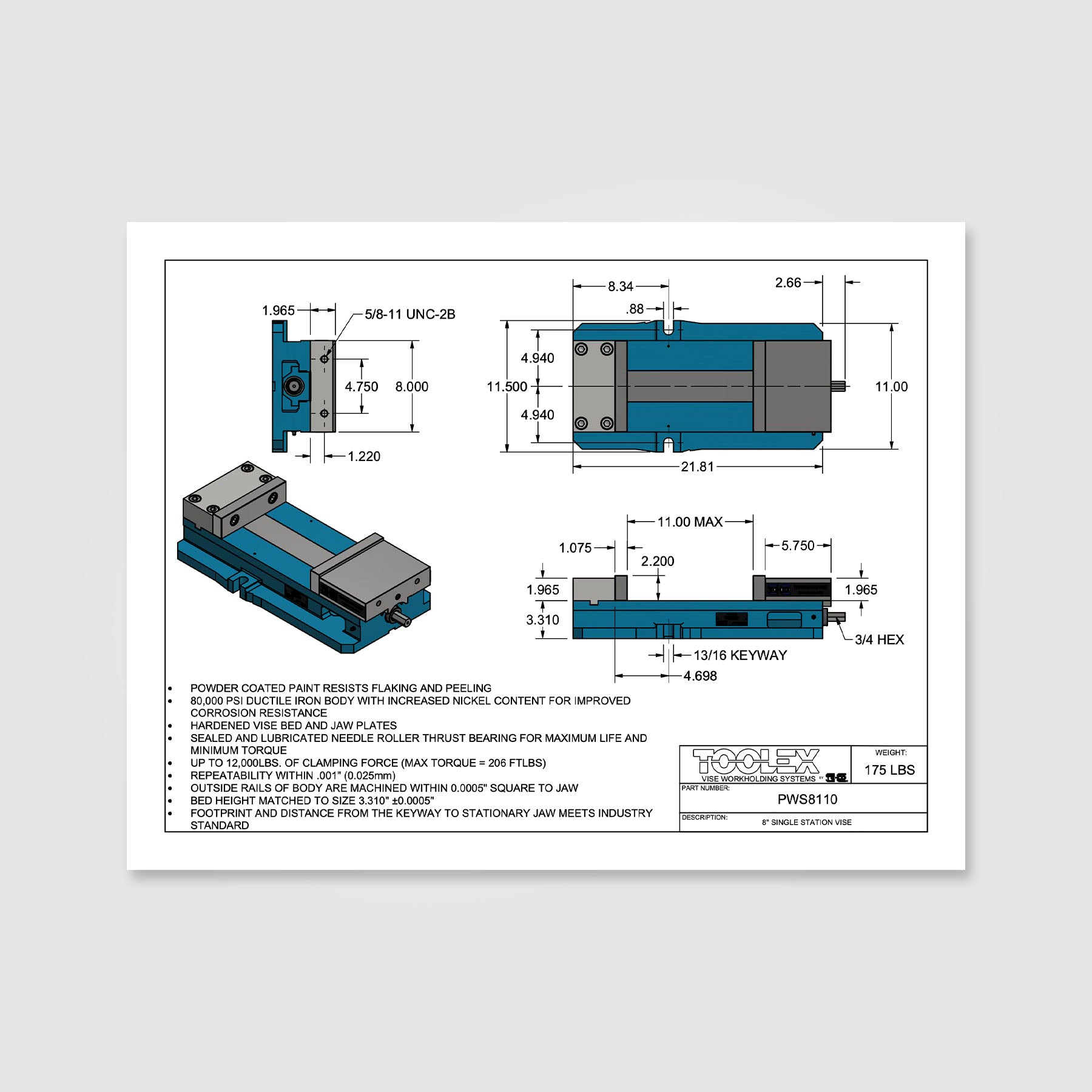

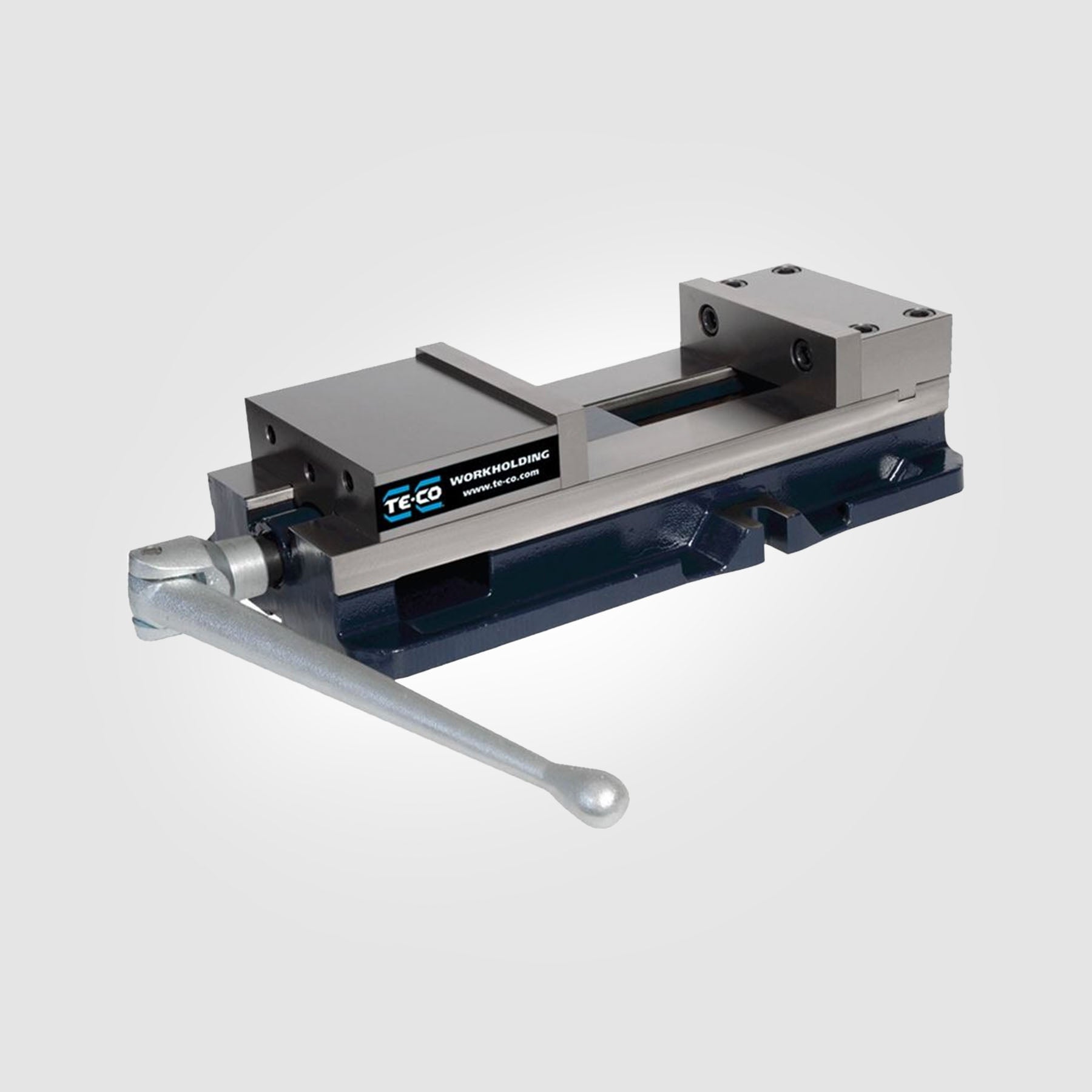

Featuring the largest opening in its class of eleven inches and a more robust main screw that can handle higher torque loads and transmit higher clamping pressure. An angled slide and locking jaw design to prevent lifting of the moveable jaw, and the four bolt design on the stationary jaw reduces deflection by 25%.
Features
- Powder coated paint resists flaking and peeling
- 80,000psi ductile iron body with increased nickel content for improved corrosion resistance
- Hardened vise bed and jaw plates
- Sealed and lubricated needle roller thrust bearing for maximum life and minimum torque
- Up to 12,000lbs. (53,379N) of clamping force
- Repeatability within .001" (0.025mm)
- Outside rails of body are machined within 0.0005" (.013mm) square to jaw
- Bed height matched to size 3.310" +/- 0.0005" (84.07mm +/- .013mm)
- Footprint and distance from the keyway to stationary jaw meets industry standard
