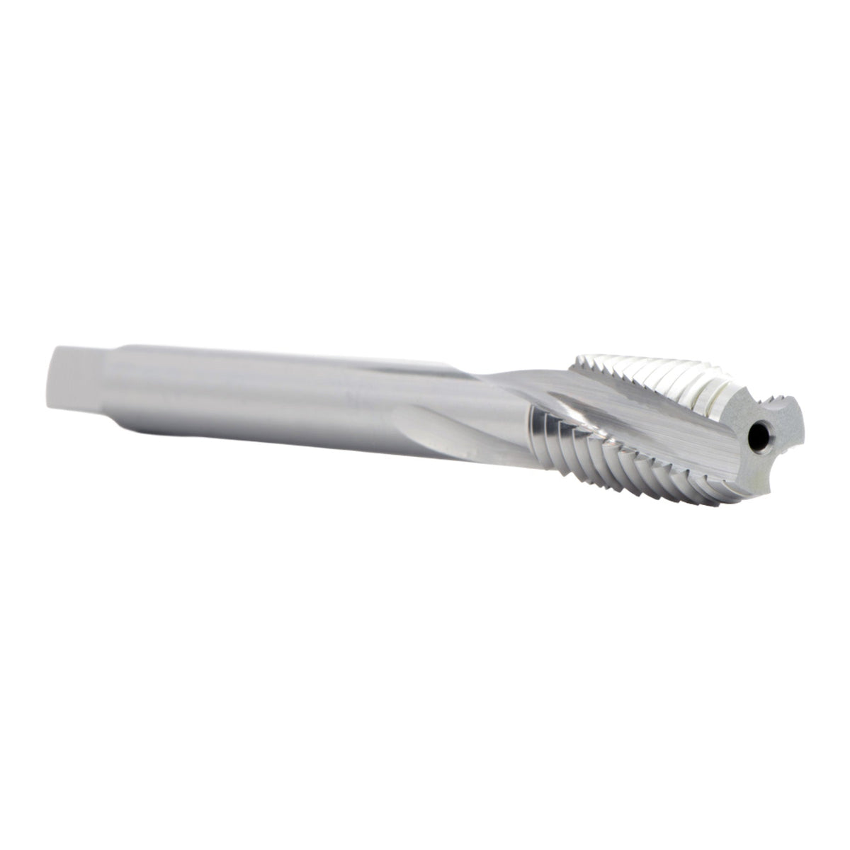

A Brand A-CSF 5/16-18 H5 3 Flute 1.5P Carbide Spiral Flute Tap
| Thread Size | 5/16-18 |
| Thread Type | UNC |
| Thread Pitch | 18 TPI |
| Class of Fit | 3B, 2B |
| Thread Limit | H5 |
| Chamfer Type | Bottom (1.5P) |
| Chamfer Length | 0.083 in (2.117 mm) |
| Major Diameter | 0.313 in (7.938 mm) |
| Thread Length | 0.665 in (16.891 mm) |
| Tap Drill Size Range | 0.252 in (6.401 mm) - 0.265 in (6.731 mm) |
| Neck Length | 1.377 in (34.976 mm) |
| Overall Length | 3.540 in (89.916 mm) |
| Shank Diameter | 0.318 in (8.077 mm) |
| Square Length | 0.375 in (9.525 mm) |
| Square Width | 0.238 in (6.045 mm) |
| Substrate | Carbide |
| Coolant Thru | Yes |
| Number of Flutes | 3 |
| Cutting Direction | RH |
| Helix Angle | 15 Degrees |
| Helix Direction | RH |
| Interrupted Thread | No |
| List Number | 16605 |
| Country of Origin | JPN |
| Net Product Weight | 0.11 lb |
