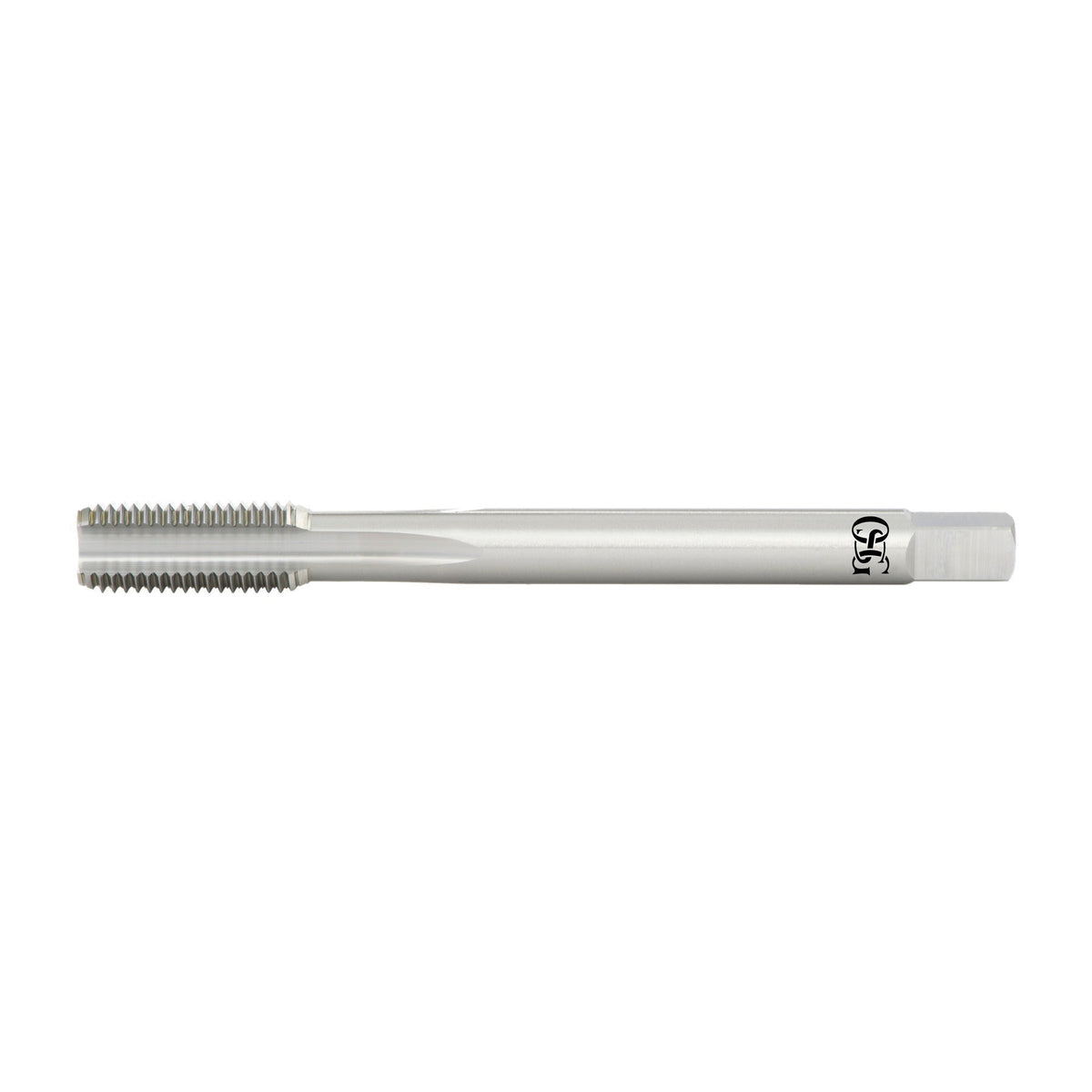

A Brand A-CHT M8 x 1.25 D5 4 Flute 1.5P Carbide Straight Flute Tap
OSG A Brand A-CHT straight flute taps are advanced-performance carbide coolant-through taps for cast iron and aluminum alloys. The large oil-hole design supports excellent coolant flow, while ultra-fine grain carbide provides high wear resistance and toughness.
| Thread Size | M8 x 1.25 |
| Thread Type | M |
| Thread Pitch | 1.25 mm |
| Class of Fit | 4H, 6H |
| Thread Limit | D5 |
| Chamfer Type | Bottom (1.5P) |
| Chamfer Length | 0.074 in (1.875 mm) |
| Major Diameter | 0.315 in (8.000 mm) |
| Thread Length | 0.591 in (15.000 mm) |
| Tap Drill Size Range | 0.262 in (6.647 mm) - 0.272 in (6.912 mm) |
| Neck Length | 1.378 in (35.000 mm) |
| Overall Length | 3.543 in (90.000 mm) |
| Shank Diameter | 0.318 in (8.077 mm) |
| Square Length | 0.375 in (9.525 mm) |
| Square Width | 0.238 in (6.045 mm) |
| Substrate | Carbide |
| Coolant Thru | Yes |
| Number of Flutes | 4 |
| Cutting Direction | RH |
| Helix Angle | 0 Degrees |
| Interrupted Thread | No |
| List Number | 16610 |
| Country of Origin | JPN |
| Net Product Weight | 0.11 lb |
