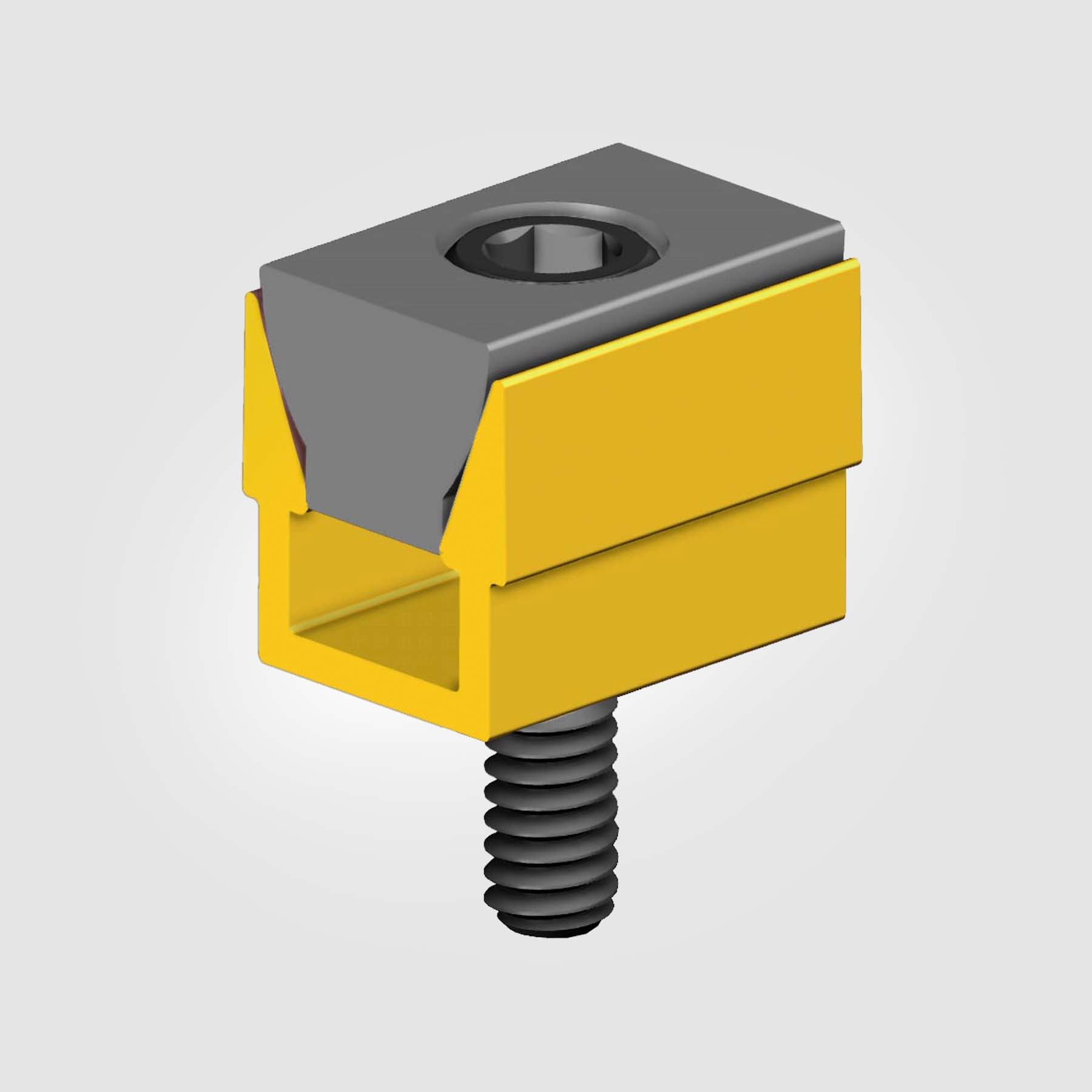

Uniforce® Clamps (Multiple Sizes)
#All

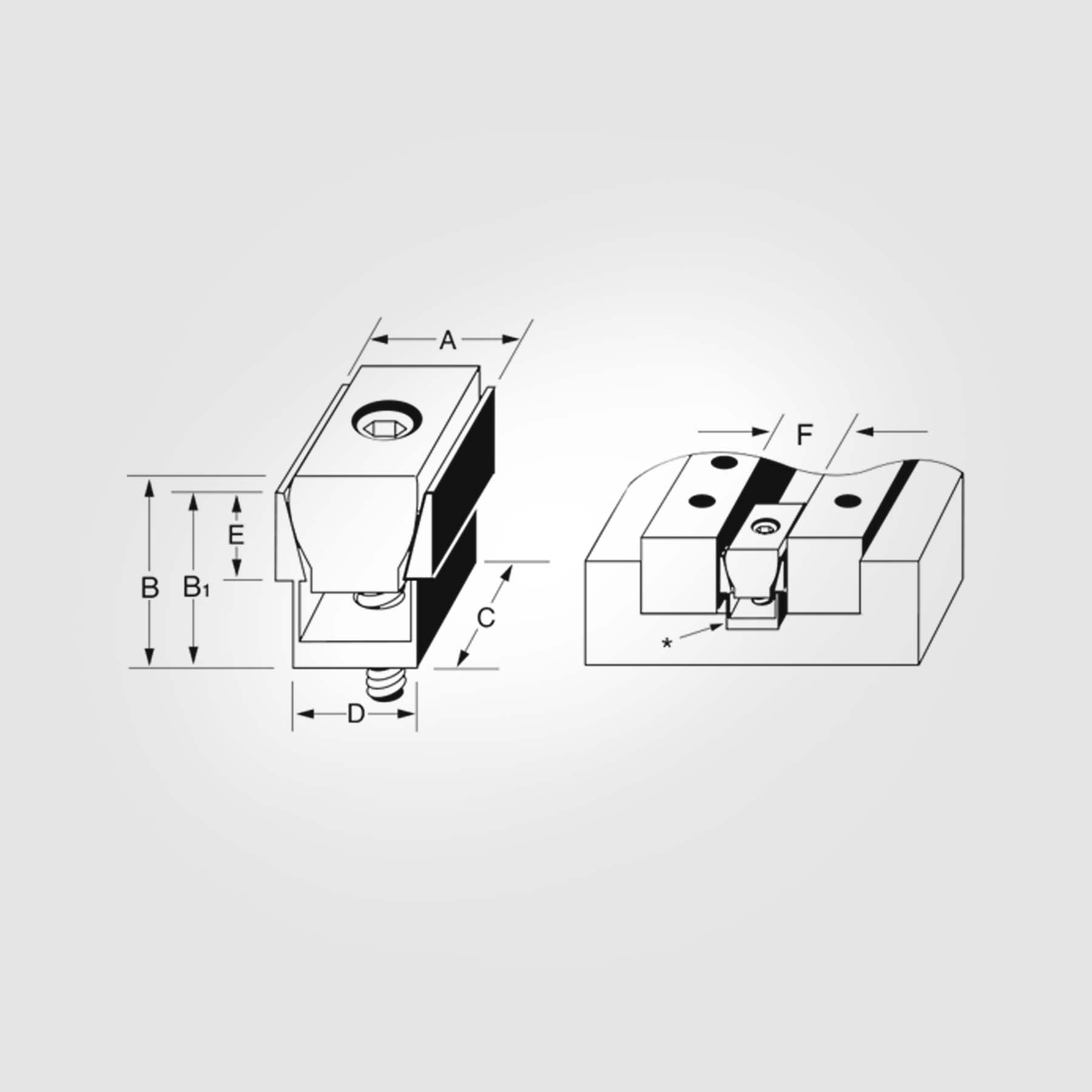

TITAN's go-to clamps for advanced fixturing and workholding setups!- Minimizes tool changes and increases production
- Holds two parts with equilateral clamping action
- Ideal for clamping flat or round work pieces
- Easily mated to hydraulic pull cylinders
- Ideal for pallet changers
#250256
Technical Data- Quantity: 6
- [D] Workpiece Alignment: 0.210"
- [F] Drill and Tap Location: 0.250"
- Max Spread: 0.260"
- Key Size: 5/64"
- Screw Size: 2-56
- Max Torque: .5 ft-lb
- Holding Force: 200 lbs
#375440
- [D] Workpiece Alignment: 0.310"
- [F] Drill and Tap Location: 0.375"
- Max Spread: 0.390"
- Key Size: 3/32"
- Screw Size: 4-40
- Max Torque: 1.1 ft-lb
- Holding Force: 310 lbs
#500832
Technical Data- Quantity: 8
- [D] Workpiece Alignment: 0.410"
- [F] Drill and Tap Location: 0.500"
- Max Spread: 0.530"
- Key Size: 9/64"
- Screw Size: 8-32
- Max Torque: 2.5 ft-lb
- Holding Force: 500 lbs
#7501420
- [D] Workpiece Alignment: 0.635"
- [F] Drill and Tap Location: 0.750"
- Max Spread: 0.785"
- Key Size: 3/16"
- Screw Size: 1/4-20
- Max Torque: 10.8 ft-lb
- Holding Force: 1500 lbs
#100051618
Technical Data- Quantity: 4
- [D] Workpiece Alignment: 0.820"
- [F] Drill and Tap Location: 1.000"
- Max Spread: 1.050"
- Key Size: 1/4"
- Screw Size: 5/16-18
- Max Torque: 10.4 ft-lb
- Holding Force: 2000 lbs
#15001213
Technical Data- Quantity: 2
- [D] Workpiece Alignment: 1.215"
- [F] Drill and Tap Location: 1.500"
- Max Spread: 1.560"
- Key Size: 3/8"
- Screw Size: 1/2-13
- Max Torque: 28.3 ft-lb
- Holding Force: 3500 lbs
#20005811
- [D] Workpiece Alignment: 1.625"
- [F] Drill and Tap Location: 2.000"
- Max Spread: 2.080"
- Key Size: 1/2"
- Screw Size: 5/8-11
- Max Torque: 55 ft-lb
- Holding Force: 6000 lbs
#250MM2
- [D] Workpiece Alignment: 5.300mm
- [F] Drill and Tap Location: 6.400mm
- Max Spread: 6.700mm
- Key Size: 1.500mm
- Screw Size: M2
- Max Torque: 0.70 N.m
- Holding Force: 880 N
#375MM25
- [D] Workpiece Alignment: 7.900mm
- [F] Drill and Tap Location: 9.500mm
- Max Spread: 10.000mm
- Key Size: 2.000mm
- Screw Size: M2.5
- Max Torque: 1.50 N.m
- Holding Force: 1350 N
#500MM4
- [D] Workpiece Alignment: 10.400mm
- [F] Drill and Tap Location: 12.700mm
- Max Spread: 13.200mm
- Key Size: 3.000mm
- Screw Size: M4
- Max Torque: 3.40 N.m
- Holding Force: 2225 N
#750MM6
- [D] Workpiece Alignment: 16.100mm
- [F] Drill and Tap Location: 19.000mm
- Max Spread: 20.300mm
- Key Size: 5.000mm
- Screw Size: M6
- Max Torque: 14.30 N.m
- Holding Force: 6675 N
#1000MM8
- [D] Workpiece Alignment: 20.800mm
- [F] Drill and Tap Location: 25.400mm
- Max Spread: 26.900mm
- Key Size: 6.000mm
- Screw Size: M8
- Max Torque: 14.50 N.m
- Holding Force: 8900 N
#1500MM12
- [D] Workpiece Alignment: 30.800mm
- [F] Drill and Tap Location: 38.100mm
- Max Spread: 39.900mm
- Key Size: 10.000mm
- Screw Size: M12
- Max Torque: 38.40 N.m
- Holding Force: 15575 N
#2000MM16
- [D] Workpiece Alignment: 41.200mm
- [F] Drill and Tap Location: 50.800mm
- Max Spread: 53.000mm
- Key Size: 14.000mm
- Screw Size: M16
- Max Torque: 74.60 N.m
- Holding Force: 26700 N
