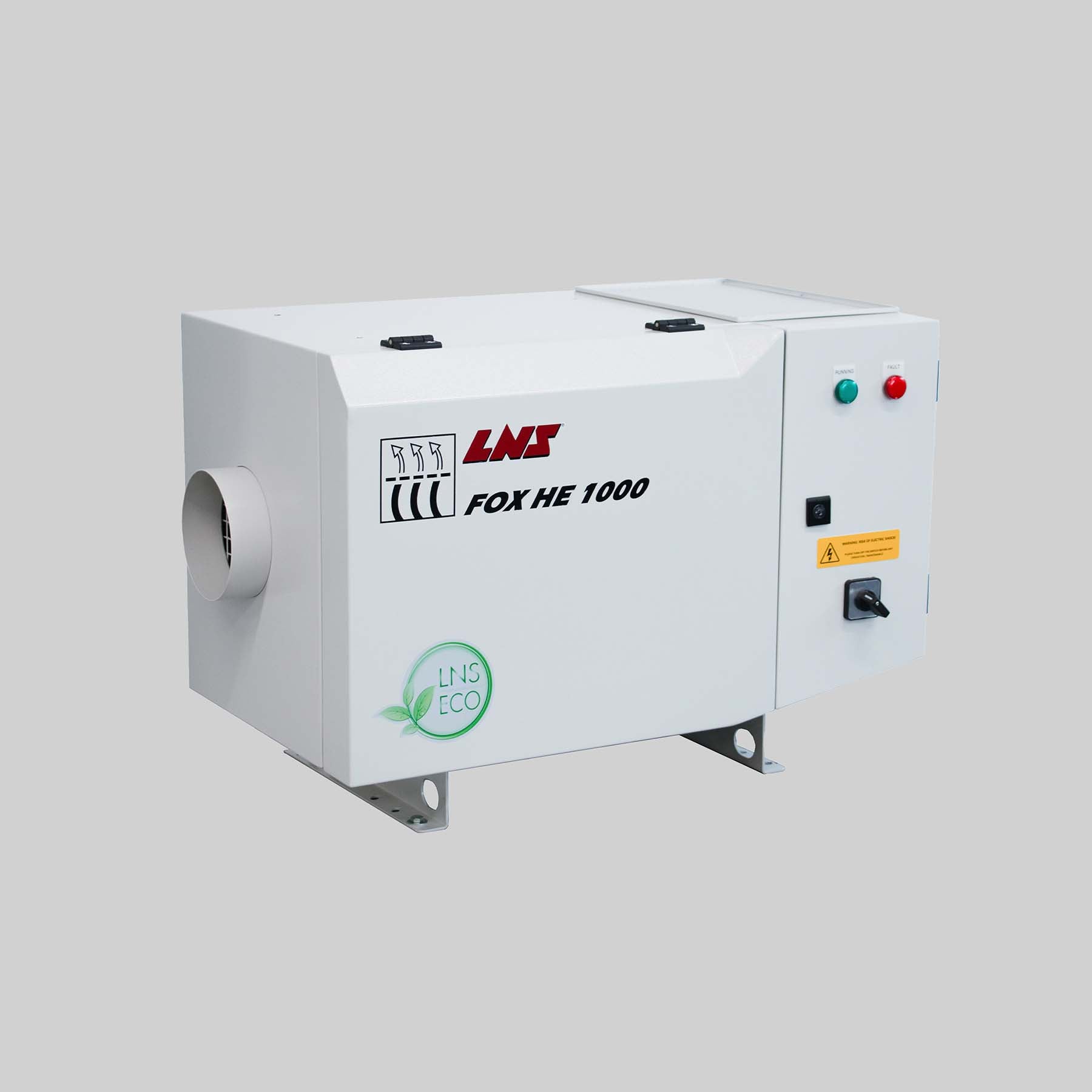

The FOX HE 1000 is specifically designed for small to medium CNC machine tool cabins. It eliminates oil mist, smoke, and odors during wet machining with straight oil. This compact, sophisticated system ensures a cleaner, safer workspace while exceeding OSHA and NIOSH air quality standards.
Key Features:
- High Filtration Efficiency: Achieves over 98.3% filtration with a lightweight, one-piece electrostatic cell, reducing oil mist for a healthier workspace.
- Compact Design: A space-saving design with easy access to components for quick maintenance and reduced downtime.
- Durable Construction: Built with a sturdy metallic mesh for pre-filters and post-filters, ensuring long-lasting performance.
- Adjustable Airflow: Two-speed control motor providing 765 CFM at high speed and 500 CFM at low speed to adapt to various applications.
- Easy Maintenance: Removable pre-filters and post-filters that can be cleaned within minutes to maintain peak performance.
Country of Origin: USA
Tech Specs
Description | Details |
Airflow (High) | 765 CFM |
Airflow (Low) | 500 CFM |
Motor | 0.4 HP (270 W) |
Amps at 230V | 0.9 A |
Weight | 150 lbs |
Weight of Cell | 17 lbs |
Sound Level | 63 dB(A) |
Suction Inlet Diameter | 6" / 150 mm |

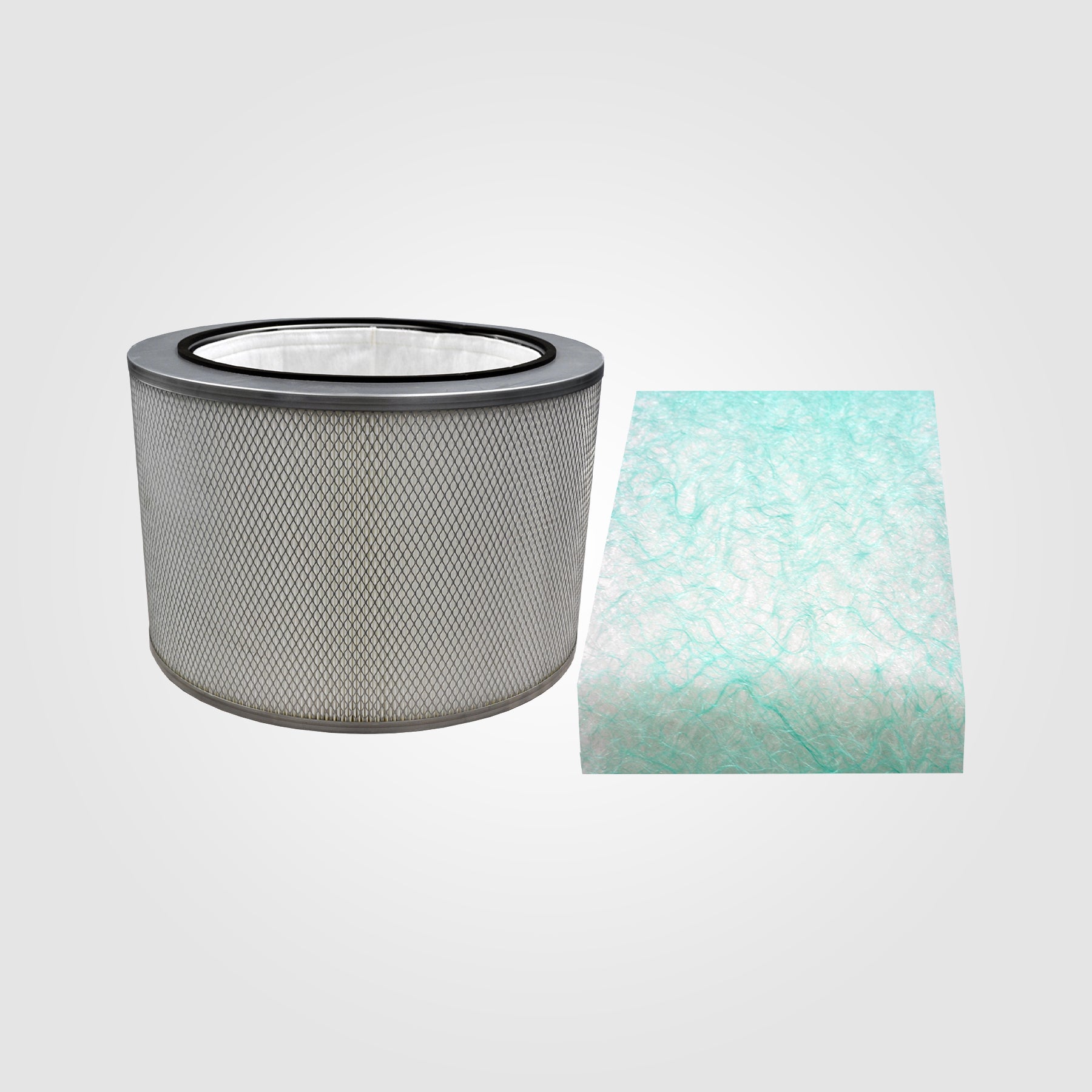

Oil-Emulsion Filters
The Pre-Filter captures large particles and combines mist droplets from emulsions. The Main Filter uses specialized media to target finer particulates and effectively maintain clean air in your shop.
For use only in oil and water-based coolant applications.
HEPA 13 Filter
HEPA filters capture at least 99.97% of all particles as small as 0.3 microns, including fine dust and smoke particles, exceeding typical health and safety regulations in precision manufacturing environments.
