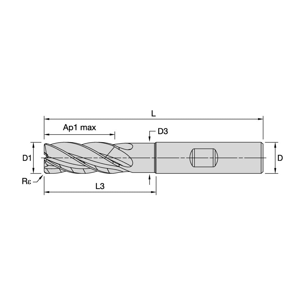

[D1] Effective Cutting Diameter0.787 in / 20.000 mm
[D] Shank Diameter0.787 in / 20.000 mm
[D3] Neck Diameter0.740 in / 18.800 mm
[AP1MAX] Max Cut Depth1.496 in / 38.000 mm
[L] Overall Length4.095 in / 104.000 mm
[Rε] Corner Radius0.118 in / 3.000 mm

[L3] Usable Length2.047" / 52.000 mm
