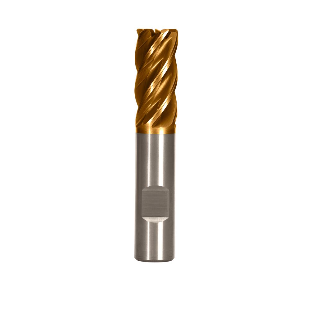

HARVI II TE 0.630" Dia x 2.362" LOC x 4.921" OAL 5 Flute Chamfered Weldon Shank End Mill 7157149
HARVI II TE Chamfered Weldon Shank End Mill
- With Weldon Shank for economical pull-out protection.
Country of origin: varies

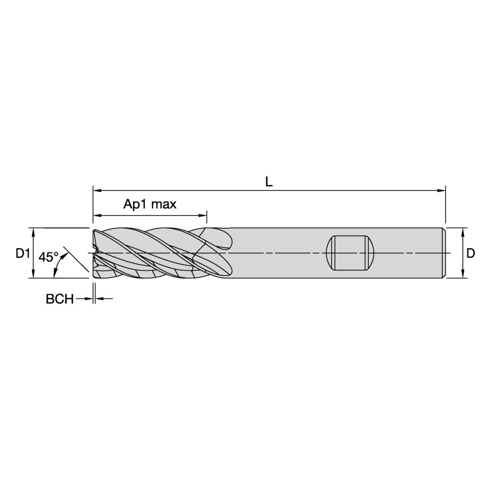

| Specification | Details |
| [D1] Effective Cutting Diameter | 0.630 in / 16.000 mm |
| [D] Shank Diameter | 0.630 in / 16.000 mm |
| [AP1MAX] Max Cut Depth | 2.362 in / 60.000 mm |
| [L] Overall Length | 4.921 in / 125.000 mm |
| Number of Flutes | 5 |
| [FHA] Helix Angle | 36.0° |
| Coating | AlCrN |
| Grade | KCPM15A |
| [BCH] Chamfer Size | 0.020" / 0.500 mm |
Tooling Overview
| Coating | AlCrN |
| Grade | KCPM15A |
