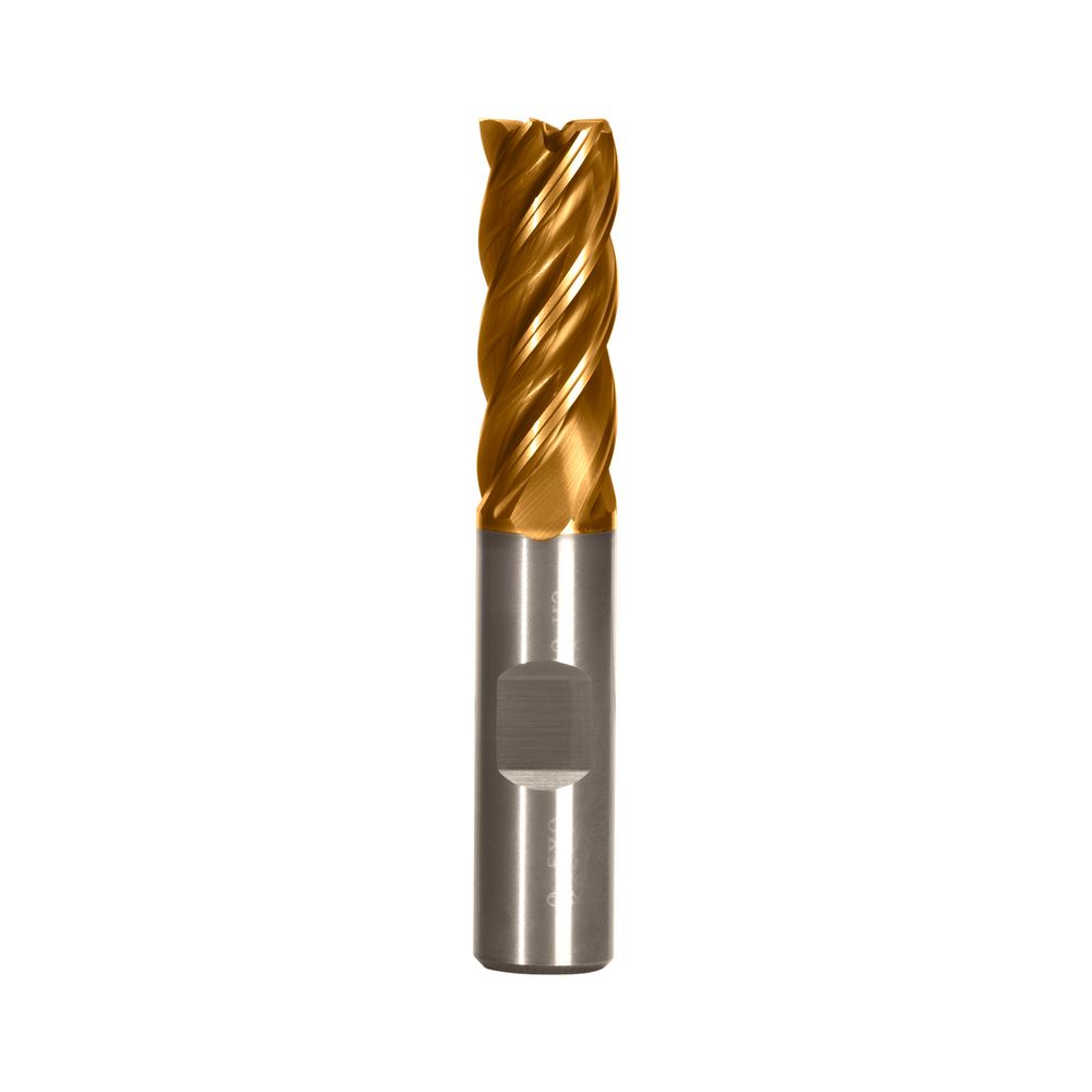

HARVI II TE 0.500" Dia x 0.625" LOC x 2.500" OAL 5 Flute Square End Weldon Shank End Mill 7155980
Sale price$167.36
Tooling Overview
SpecificationDetails

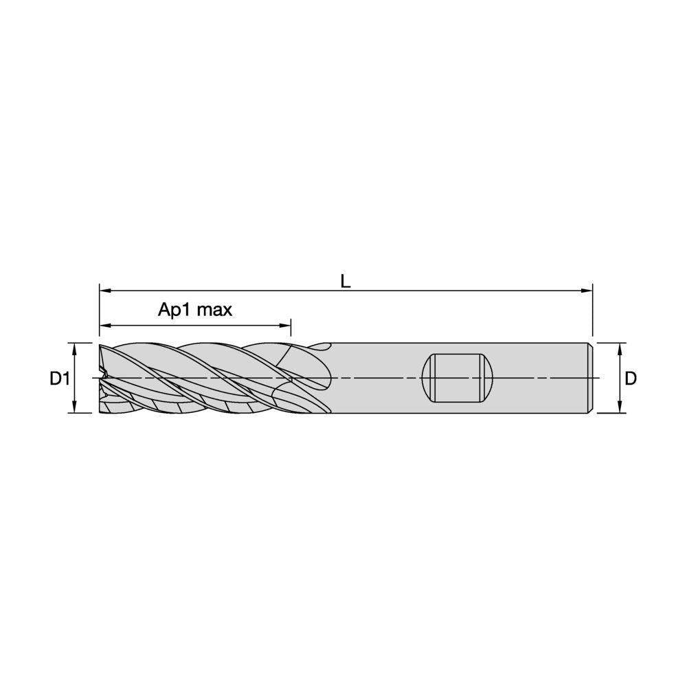

[D1] Effective Cutting Diameter0.500 in / 12.700 mm
[D] Shank Diameter0.500 in / 12.700 mm
[AP1MAX] Max Cut Depth0.625 in / 15.875 mm
[L] Overall Length2.500 in / 63.500 mm
Number of Flutes5
[FHA] Helix Angle36.0°
CoatingAlCrN
Center Cutting ToolNo Center Cutting
Cutting Tool MaterialCarbide
GradeKCPM15A
MaterialsSteel, Stainless Steel, Cast Iron, High Temperature Alloys, and Hardened Materials
ApplicationsSide milling, slotting, ramping, plunging, and roughing / finishing with one tool
End Mill Finish TypeFinisher
