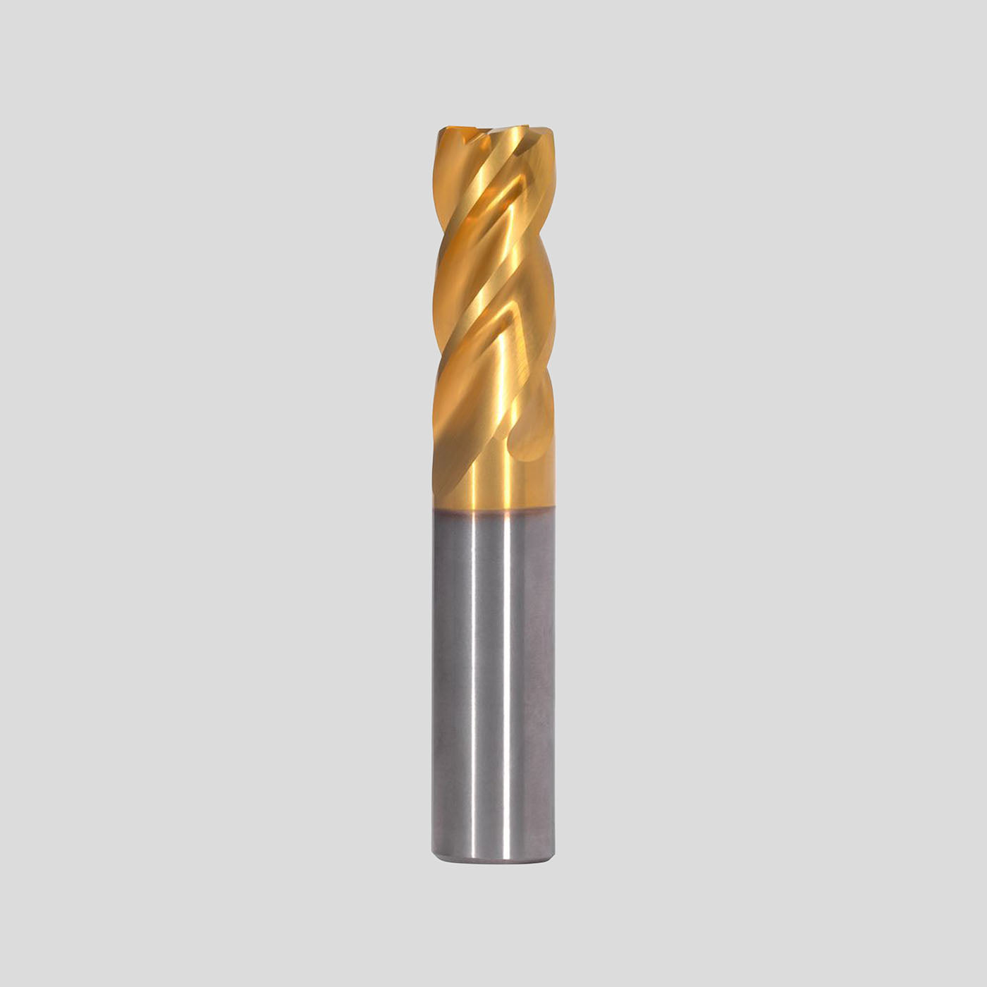

GOmill PRO 0.750” DIA x 4.000” LOC x 6.250” OAL 0.120R 4 Flute Straight End Mill
Country of origin: Varies

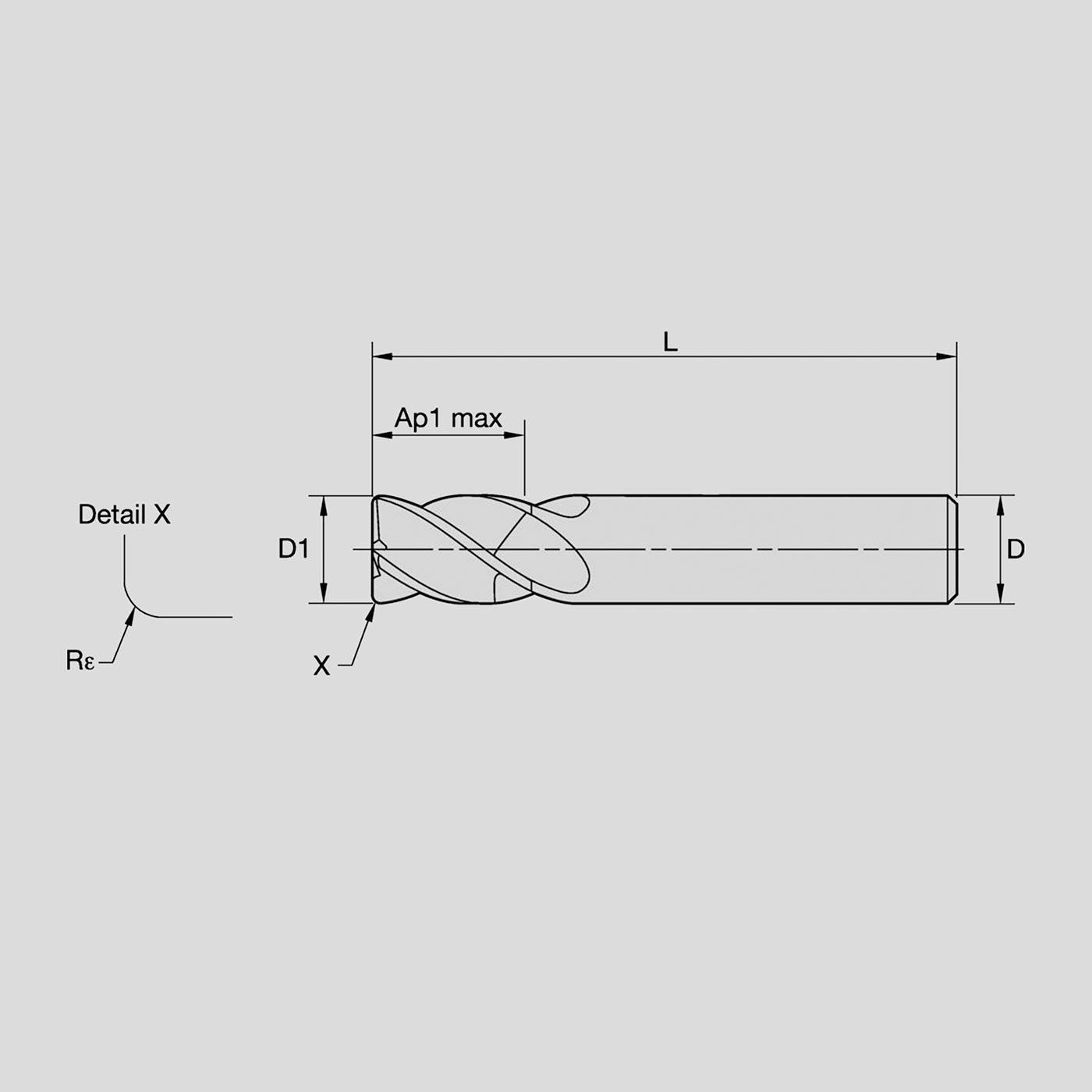

| Specification | Details |
| [D1] Effective Cutting Diameter | 0.750 in / 19.050 mm |
| [D] Shank Diameter | 0.750 in / 19.050 mm |
| [D3] Neck Diameter | Straight-Cylindrical |
| [AP1MAX] Max Cut Depth | 4.000 in / 101.600 mm |
| [L3] Maximum Depth End Mill | 4.304 in / 109.315 mm |
| [L] Overall Length | 6.250 in / 158.750 mm |
| [BCH] Corner Chamfer Width | 0.120 in / 3.048 mm |
| [REPSILON] Corner Radius | 0.120 in / 3.048 mm |
| Number of Flutes | 4 |
| Grade | KCU20 |
