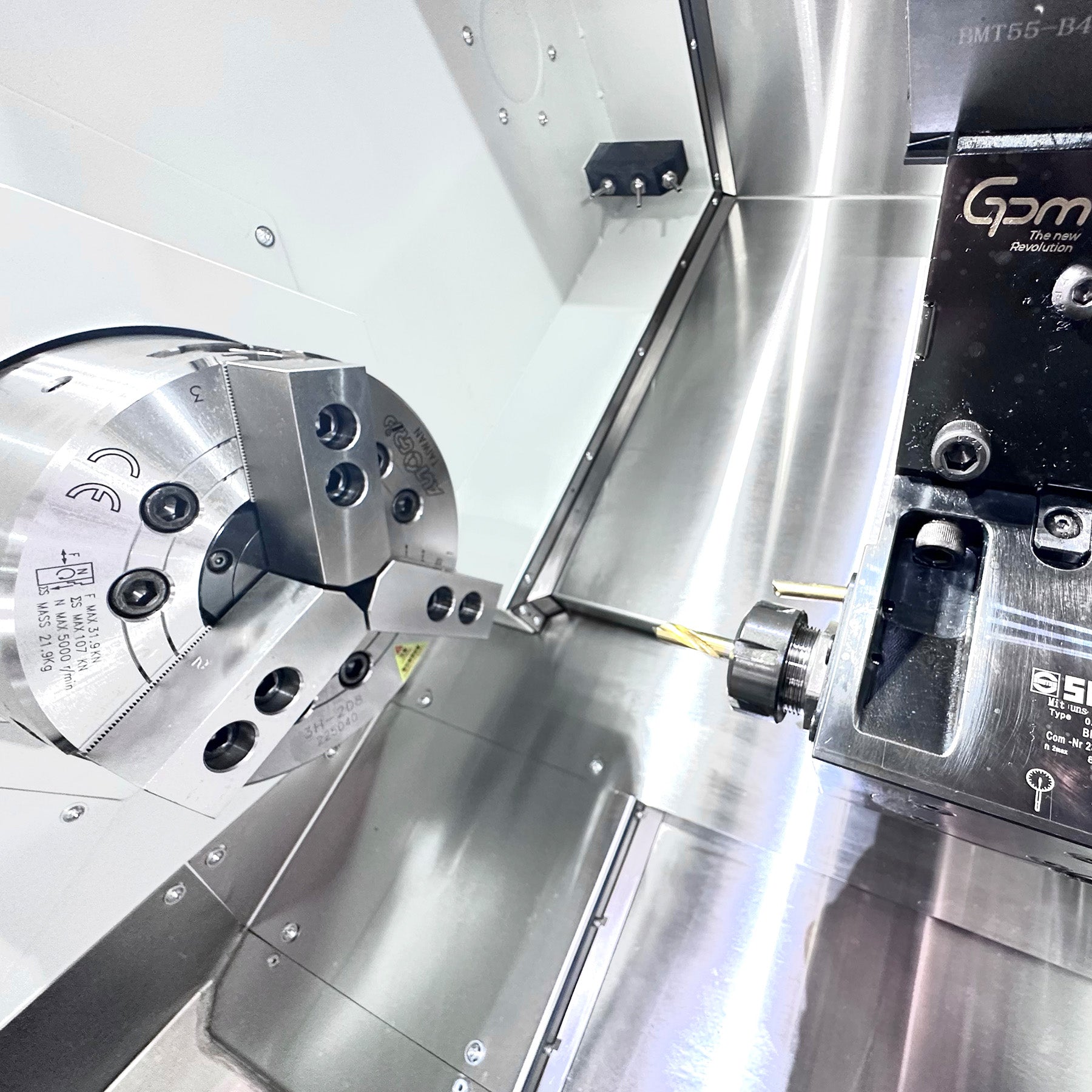

High-Performance Turning Platform
Rigidity & Motion System
- Epoxy granite base for vibration damping
- High-precision THK/HIWIN ball screws and linear guides
- Designed for stable cutting in steel and alloy materials
Spindle & Cutting Power
- 4,000 RPM A2-6 spindle
- 8" hydraulic three-jaw chuck
- Ø2.48" (63mm) through-hole capacity
- Consistent torque for production turning

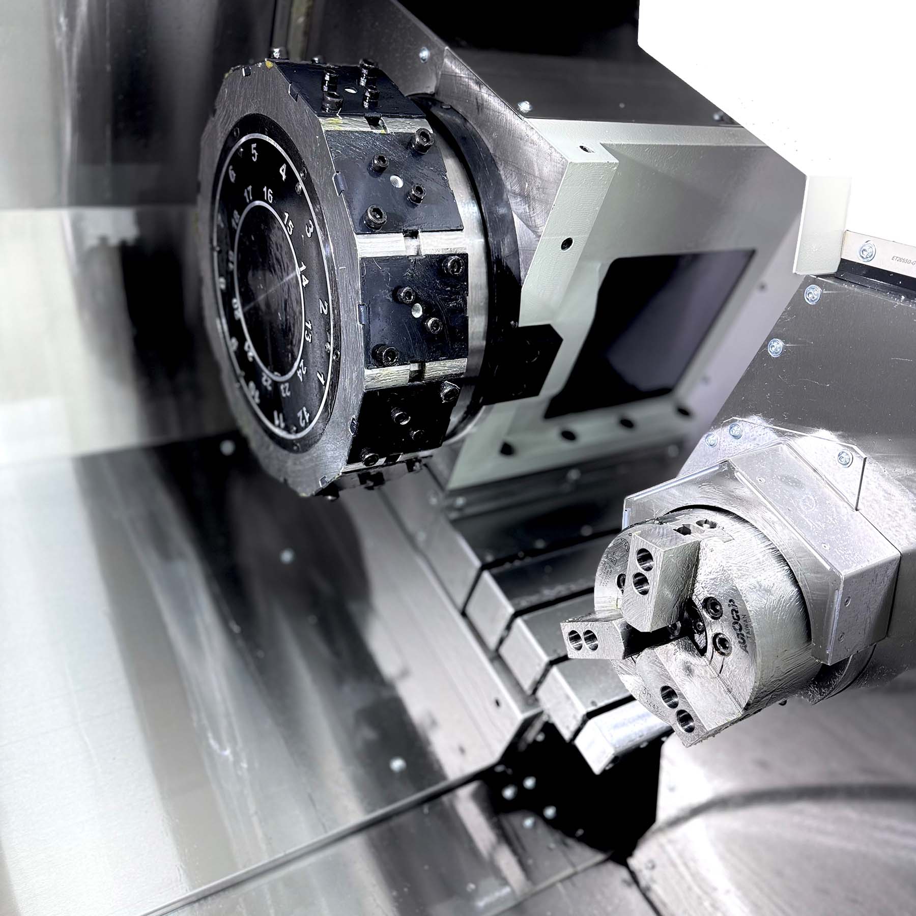

Live Tooling Capability
- 12-station BMT55 turret platform
- 5,000 RPM live tooling speed
- Rigid driven tool interface

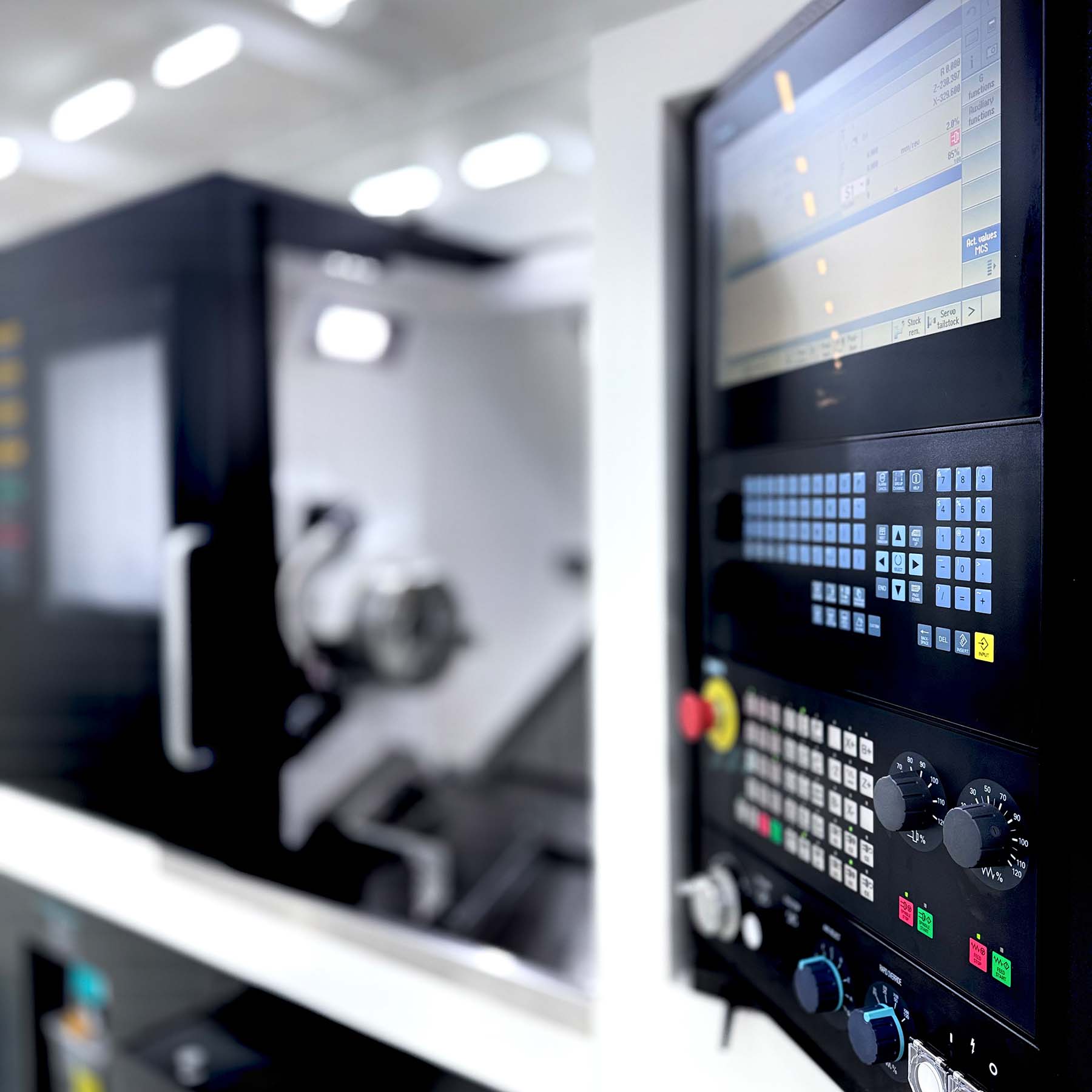

Control & Programming
- Siemens SINUMERIK 828D with 15" display
- Conversational programming + full G-code support
- Production-ready turning and milling cycles

SYIL L3
The SYIL L3 is a massive step up in turning centers, featuring a German SAUTER Power Turret which significantly reduces tool change time, improves chip rigidity, and ensures you're running at peak efficiency.
8 inches (203.2mm)
ø21.65" (ø550mm)
ø11.42" (ø290mm) (with Y axis: ø7.87" (200mm))
19.69" (500mm) (with Y axis: 20.87" (530mm), with Counter Spindle: 17.72" (450mm))
ø14.96" (ø380mm)
98.43" x 67.72" x 68.50" (2500 x 1720 x 1740mm) (with Y axis: 105.51" x 68.90" x 72.83" (2680x 1750x 1850mm), with Counter Spindle: 105.51" x 68.90" x 72.83" (2680 x 1750 x 1850mm))
4000 rpm
A2-6
ø2.48" (ø63mm)
ø2.05" (ø52mm)
14.75/20.12 hp (11/15kW)
1181.1"/min (30m/min)
Power Turret
12 Positions
0.2s / 0.5s
590.55"/min (15m/min)
7.48" + 0.39" (190+10mm)
21.65" (550mm) (with Y axis: 19.29" ±1.97" (490±50mm))
