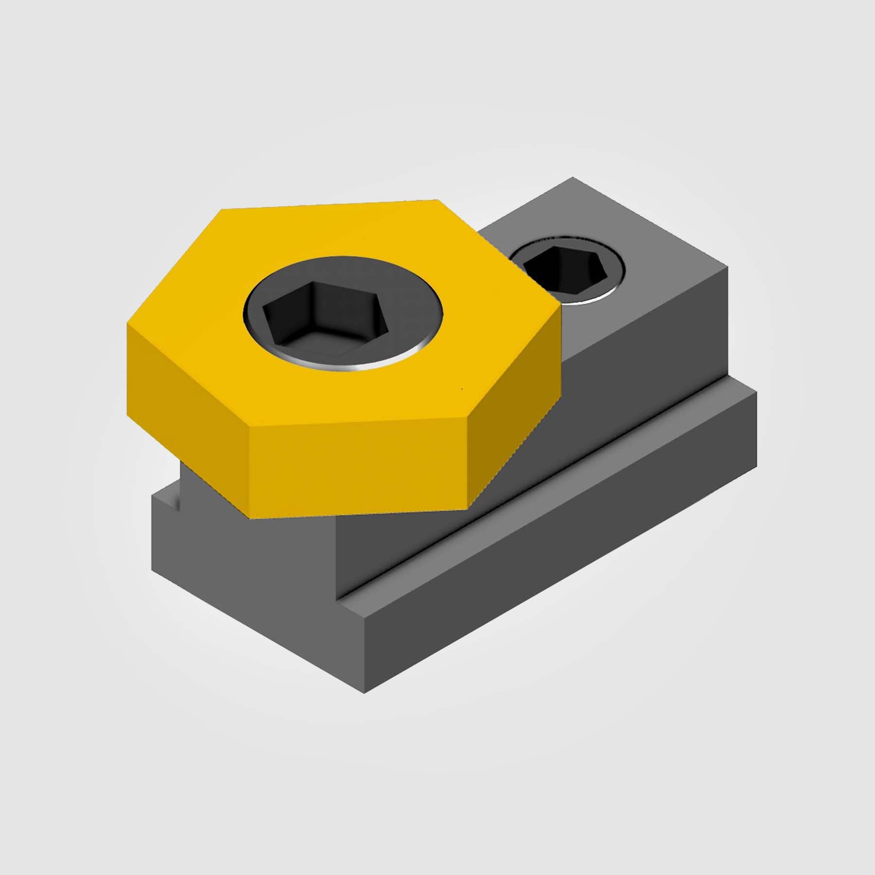

TITAN's go-to REPLACE for advanced fixturing and workholding setups!- Locks in machine T-slot for low profile clamping
- Makes fast set-ups possible right on the machine table
- Brass hex follows contour of unusual shaped parts
- Packaged in pairs or complete kits
- Hex key not included
