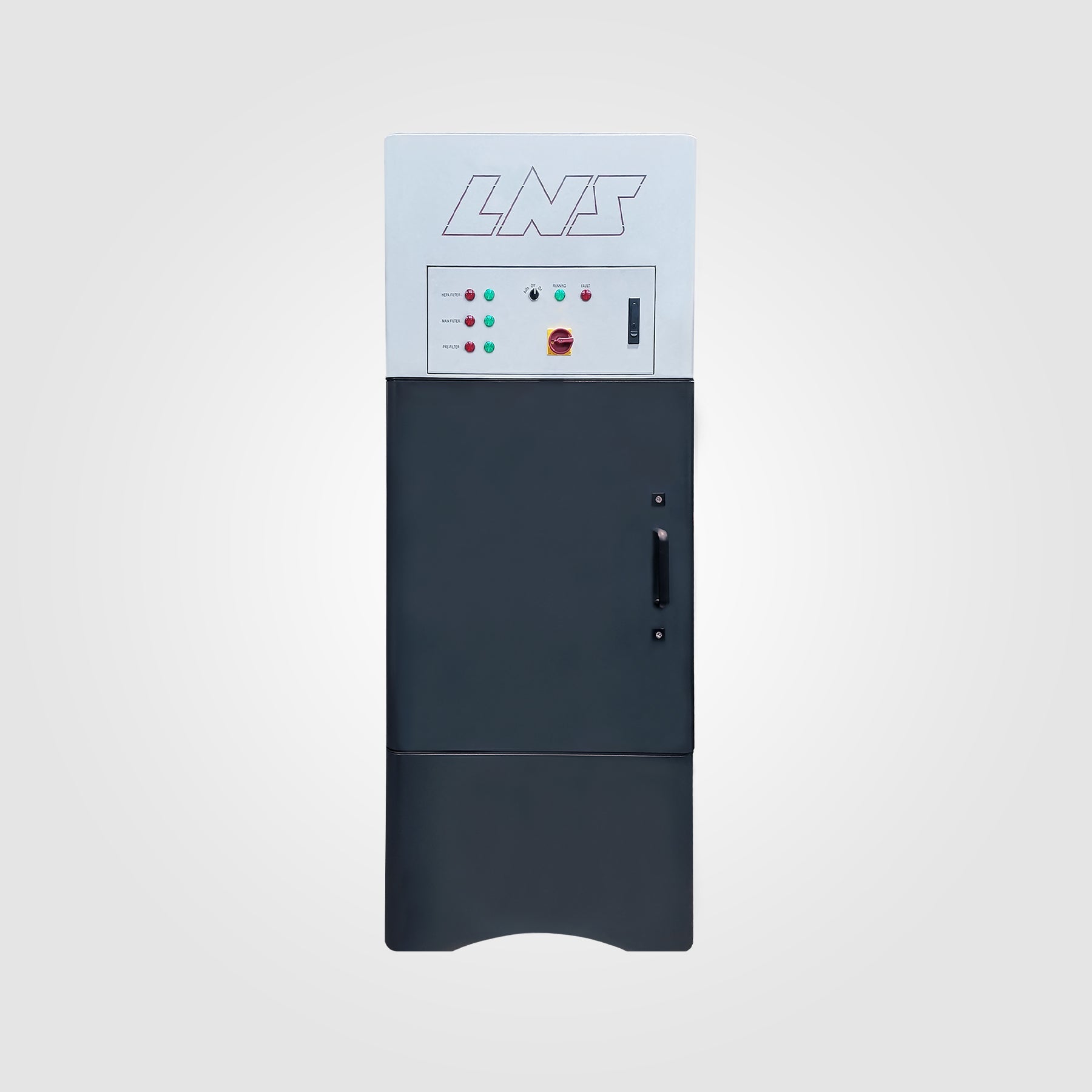

#2500
- Air flow** [cfm]: 2350
- Static pressure [in of WC]: 9.2
- Motor [hp]: 4.8
- Amps [230V]: 10.6
- Weight [lb]: 551
- Sound level [dB(A)]: 79
- Inlet Diameter [mm | in]: 250 (10)

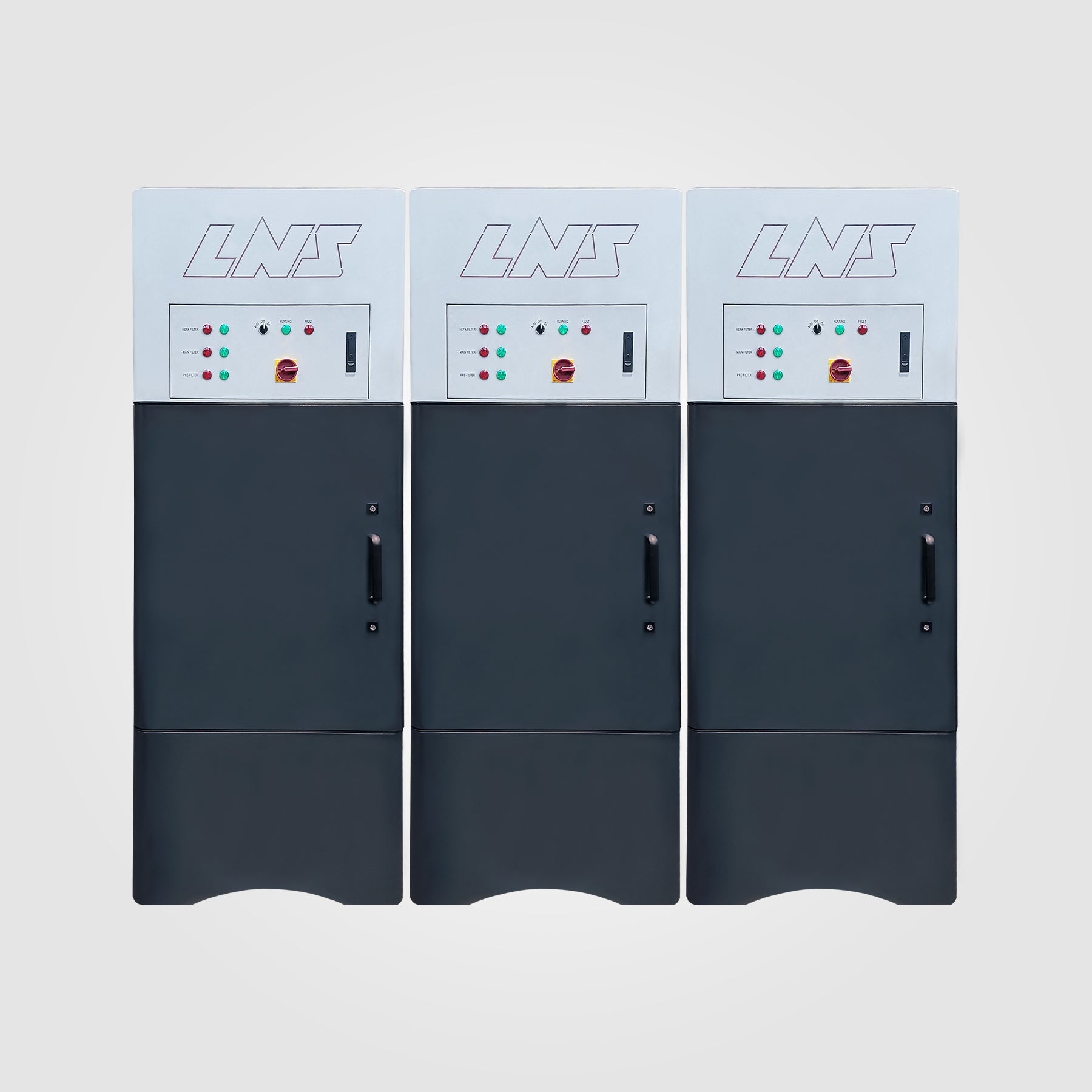

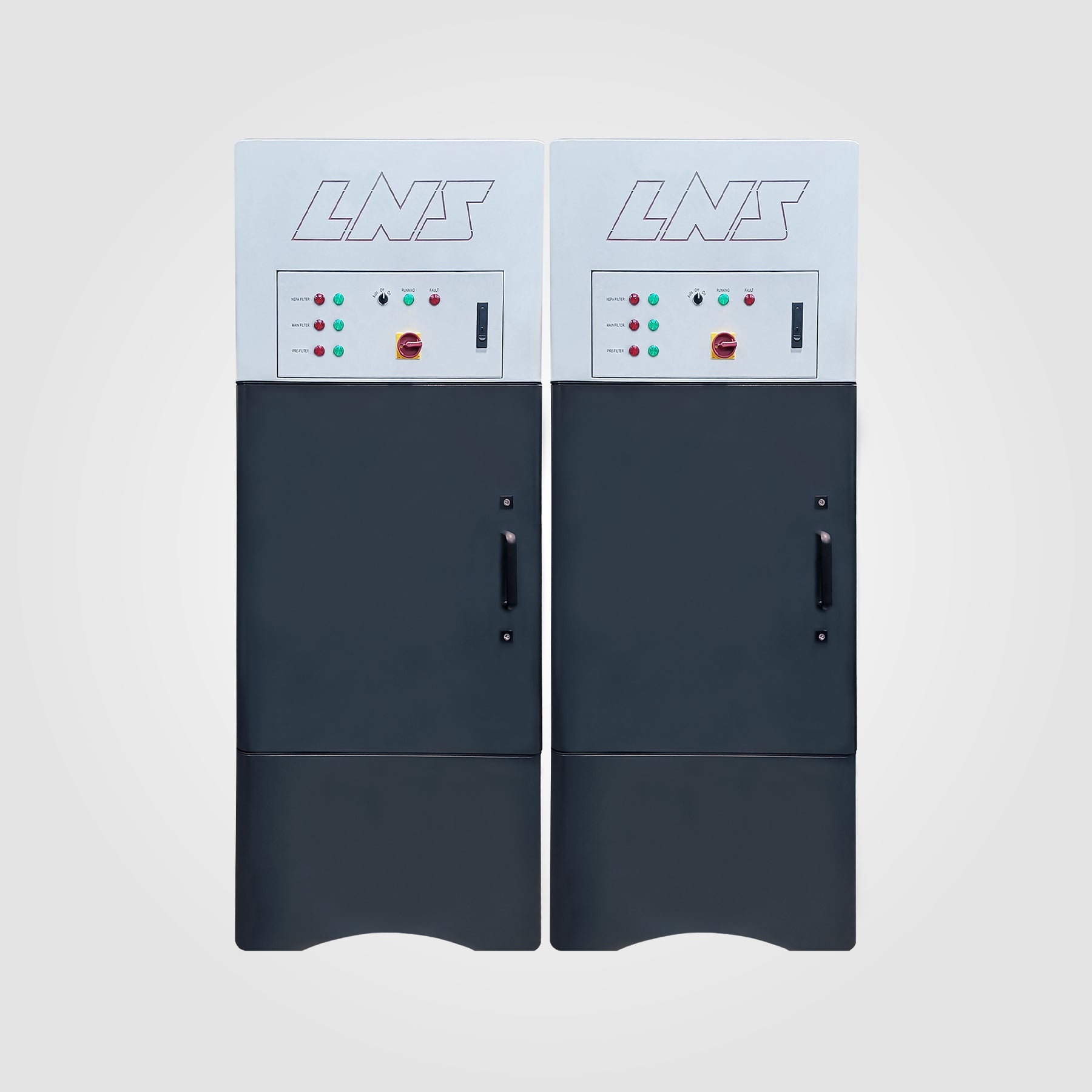

#5000
- 2 FOX WM2 2500 Units
- Motor [hp]: 4.8
- Amps [230V]: 10.6
- Weight [lb]: 551
#7500
- 3 FOX WM2 2500 Units
- Motor [hp]: 4.8
- Amps [230V]: 10.6
- Weight [lb]: 551
